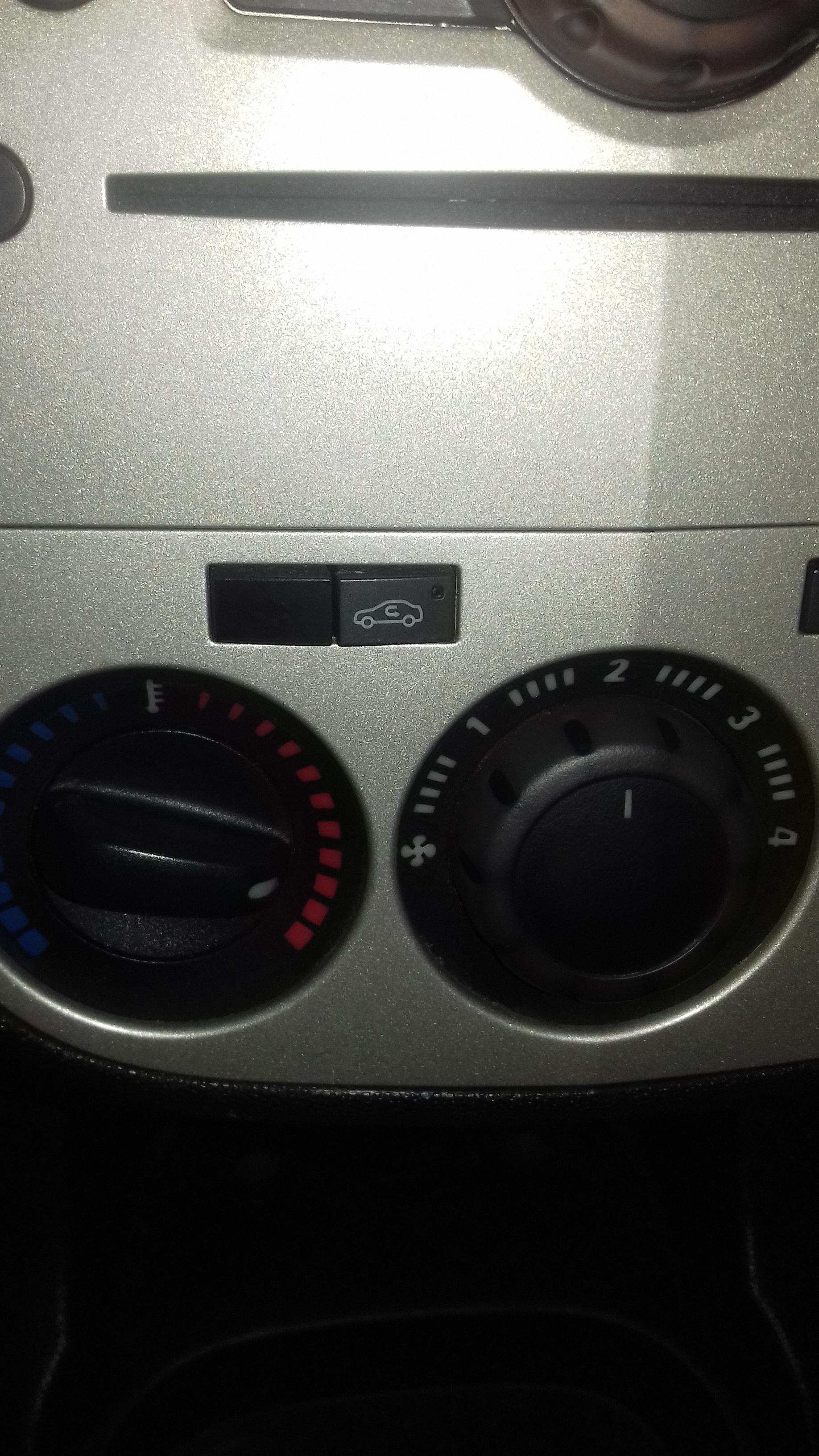

    Hello. Recently I have Opel Corse D 2008. The car has air conditioning. The problem is I don't know how to turn it on. On similar dashboard models there is a switch with a diode. For me there is such a switch with that without any marking and diode. Please help. Thank you in advance.

    This button is exactly there. So either you have a cover and you don't have a limer, or someone has replaced the button (because, for example: fell out) with a piece of plastic.

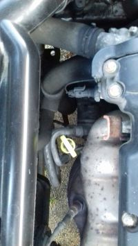

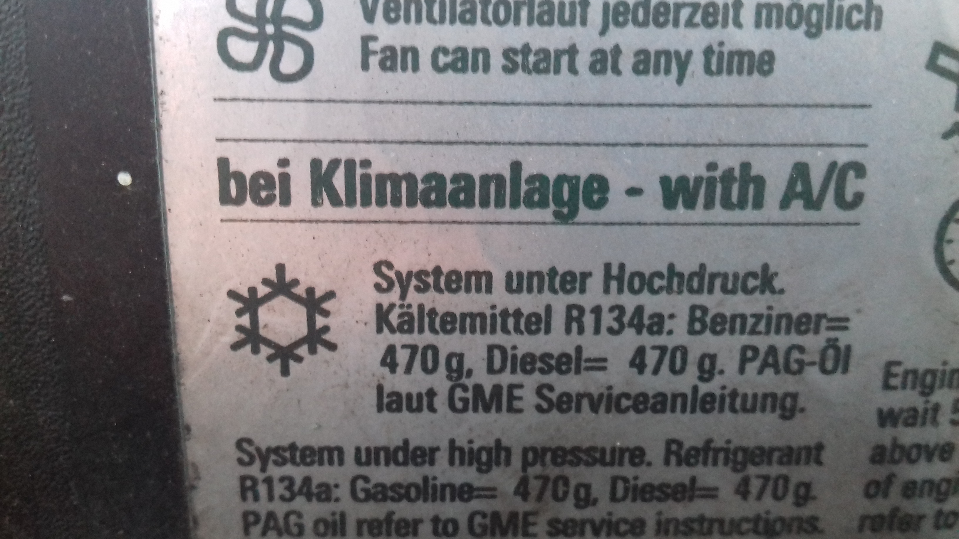

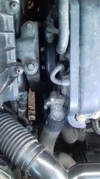

    Press this black next to the recirculated button and observe if the engine load changes when it is pressed. Also give a photo from under the bonnet - it's about the part with the pulleys (we'll see if there is any air at all).

    The load has changed. I am sending a photo Air Conditioning in 2008 Opel Corsa D: How to Turn On, Switch & Diode Issues, Dashboard Models Air Conditioning in 2008 Opel Corsa D: How to Turn On, Switch & Diode Issues, Dashboard Models Air Conditioning in 2008 Opel Corsa D: How to Turn On, Switch & Diode Issues, Dashboard Models

    So someone broke the button :-) Since the load has changed, you just turned it on. Or you turned it off :-)
