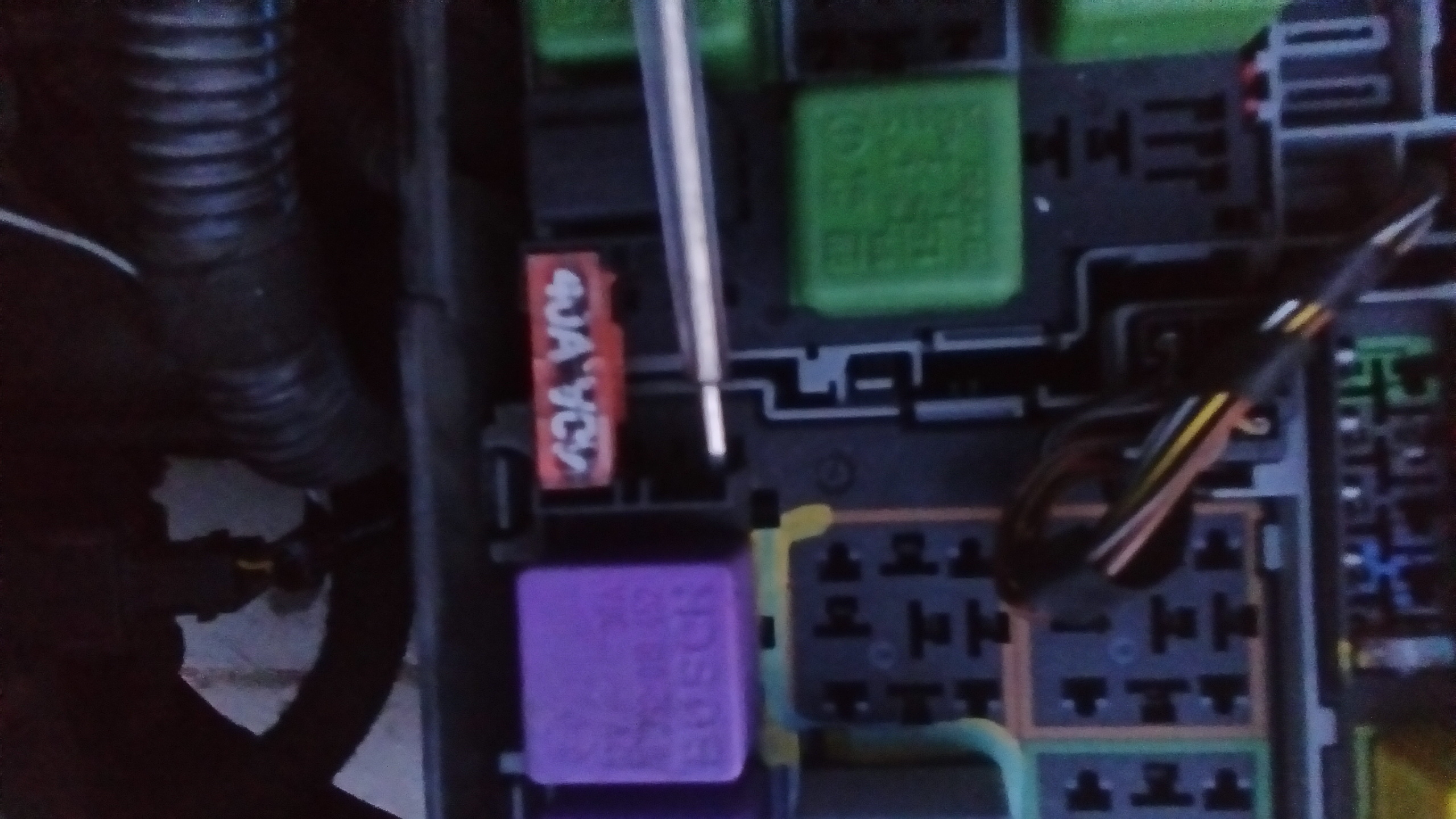

    F-31 fuse, F52 fuse not in place in the fuse box.While photo No. 1. Should be on the left gears with catches. Inside there is no fuse box. What about the compressor is the photo number 2 in place F53 there is a fuse of red color 40A. Higher to be F52 green. I do not know what is going on.

    F52's the one on mine 40A

    It results from this that the lack of this F53. Ask if the relay on the left R12? Does the lack of this fuse cause a fault in the air conditioner.
