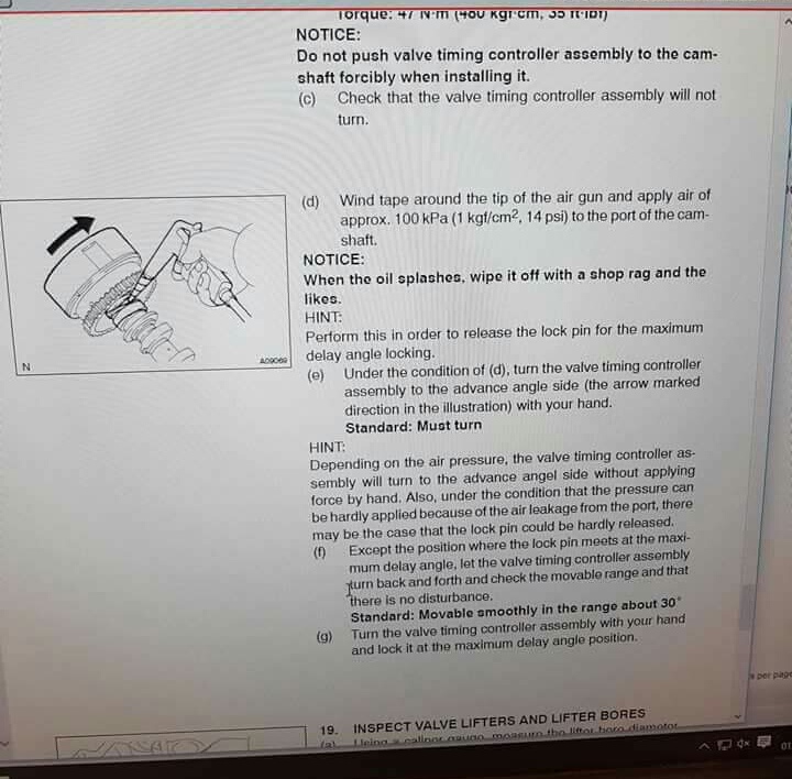

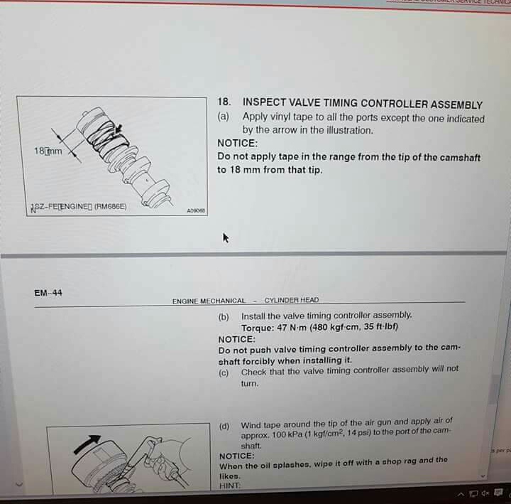

    However, I have two cards from the instructions, which are something about pumping compressed air into the oil supply channel to the variator

    this is an instruction on how to check the variator. If you replace it with a new one, it doesn't apply to you.
