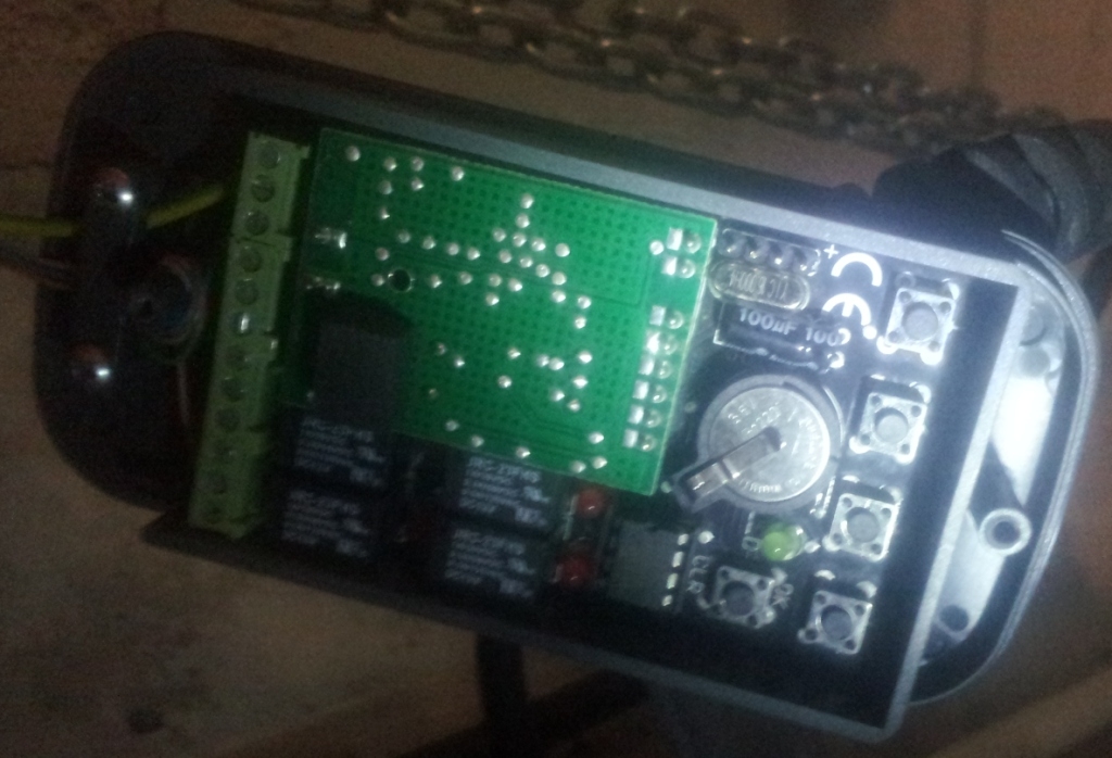

    I would like to add new remote controls to the controller, but I do not want to buy a wireless module for communication with the computer. There are buttons inside and you can certainly add a remote control manually - but the question is, is there such an option at all and maybe someone from forum members knows how to do it? I was looking for instructions, but they all describe the way with the computer - remotely.
    I have matching remotes because I bought a spare one for mine.
    Thank you in advance.

    Adrian_C
    Posts: 490
    Help: 17
    Rate: 97
    If the radio is not blocked or the buttons are disconnected, press the button of a given channel, the LED will light up or start flashing (I don't remember) then press the button on the remote control and the LED should go out

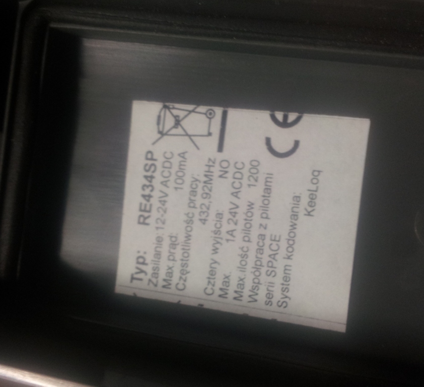

    The question is whether the remotes will work with a frequency of 433.92 MHz? On the housing, the operating frequency is given 432.92MHz. Today I wanted to add a CAME remote control and the receiver did not want to add it to the base. Another gate with the same receiver accepted. I will add that the module is RE434SP.
