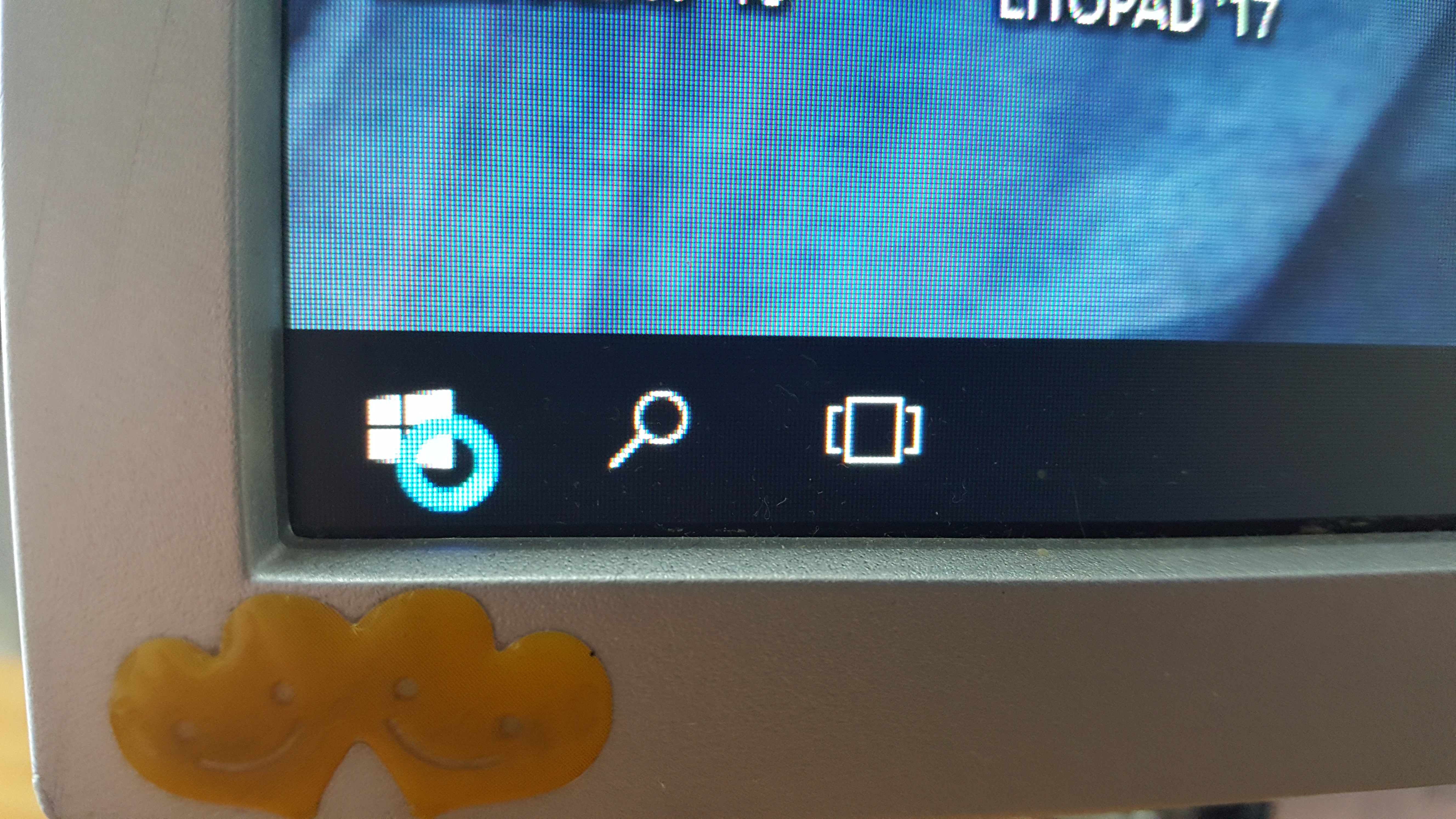

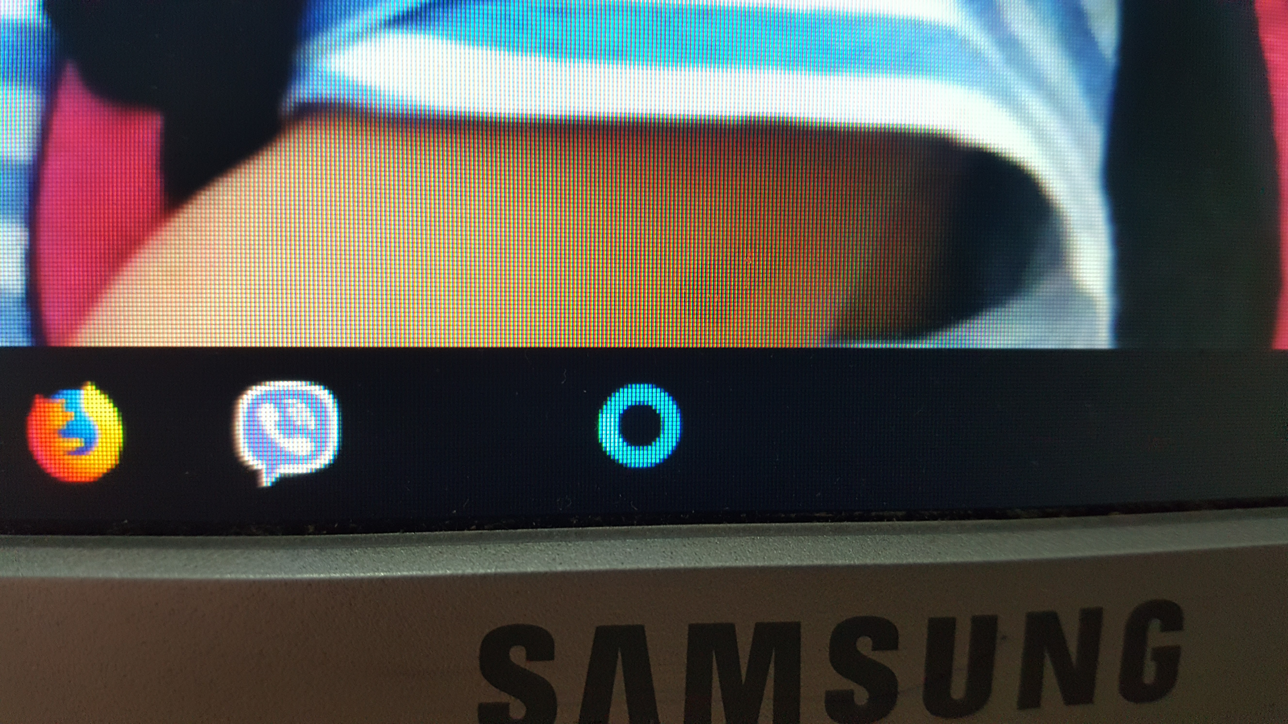

    Hello, as in the subject - I turned on the computer, entered the password normally, the desktop was displayed, and nothing can be done. Open browsers, open any icons, the start bar does not work, just a spin. Additionally, the desktop refreshes itself every minute. I cannot enter the manager, no keyboard shortcut works. I am completely green in this topic, so if someone would like to help me please step by step instructions. I urgently need a computer for work.

    Hover over the taskbar, right click and launch task manager.
  • #9 16871580
    saleen1
    Posts: 8
    It's not possible. Picture below
    • PC Desktop Refreshes Constantly: Issue with Start Bar, Browsers & Icons- Need Step-by-Step Help 20171206_114545.jpg (4.96 MB) You must be logged in to download this attachment.
    • PC Desktop Refreshes Constantly: Issue with Start Bar, Browsers & Icons- Need Step-by-Step Help 20171206_114709.jpg (5.33 MB) You must be logged in to download this attachment.

  • Explorer likely hangs while disk usage hits 100%
