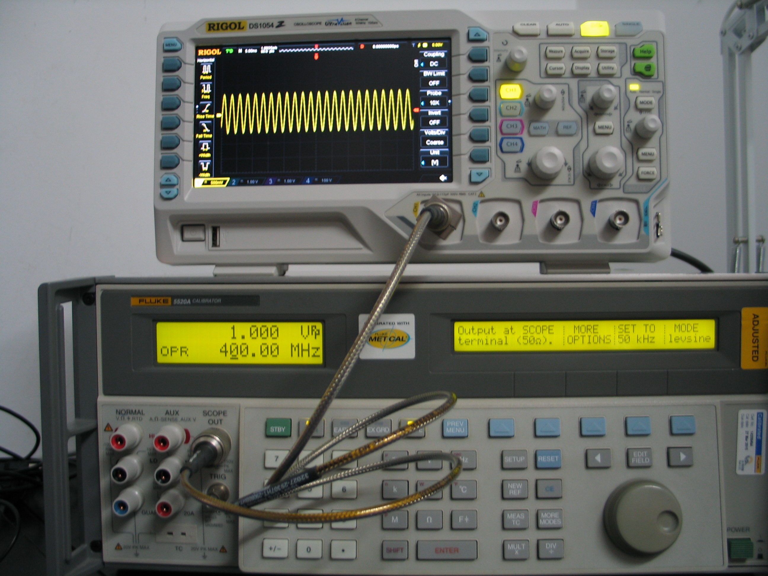

    The basic question is what the oscilloscope is for. The application determines which features should be paid more attention, and which slightly less.
    The Axiomet is a slightly older design, similar to the previous generation Rigola, which is now being withdrawn: DS1102E
    The Rigol DS1054Z has good input circuits and can handle synchronization up to 400MHz.
    Here a photo of what it looks like (the equipment is obviously not locked)

    @NDN Warsaw 400MHz, but with what amplitude drop ... And MHz, not MHZ.
    With a big one, of course. After all, this is a 100 MHz oscilloscope, not 400 MHz. The point is that rarely any 100 MHz oscilloscope will display this high frequency waveform.
    For example, my old Tek 2220 with the 60 MHz band only displays up to max. 180 MHz, and where 200, 300 or 400 MHz. Above 180 MHz, it is just a horizontal line, which is impossible to read the waveform.
    For me, as an amateur radio, it is a decent feature when I can check the waveform at the generator output and the exact amplitude measurement is a secondary matter. Therefore, for amateurs, the Rigol 1054z is a very good and cheap solution.

    ^ToM^ wrote:
    @NDN Warszawa 400MHz, but with what amplitude drop ...
    If I find it, I will put the damping characteristics both in the 50MHz version and after unlocking to 100MHz. Once, we took the characteristics off in the calibration laboratory.
    Therefore, I wrote only about 400MHz waveform synchronization - the attenuation significantly exceeds 3dB.
    @ ^ ToM ^ the oscilloscope will correctly show a sine wave, not a distorted waveform.
    Here I think it was about the lack of synchronization. For example, the Siglent SDS1102X-E with the 200MHz band stops synchronizing already after approx. 250MHz and we will not see even a sine wave with a frequency of 300MHz there - just some garbage on the screen.
    The Rigol DS4024 (also 200MHz, but a 4GSa / s converter) can now synchronize the 1GHz waveform.
    So far, Rigol has the greatest opportunities among Chinese manufacturers. For example, he designed a new acquisition system that allows to build a 4GHz oscilloscope.
    Here is some news for those interested: http://www.eenewseurope.com/news/novel-chipset-and-architecture-portable-oscilloscopes
    Rigol has built a prototype scope based on Phoenix and Ultravision II, boasting a 4GHz bandwidth, 20GSa / s real-time sample rate and 1 billion point memory depth.
    Returning, however, to the beginning of the topic - the most important question is the use of the oscilloscope. I often meet that a subordinate feature -
    sometimes, not even mentioned in catalog cards turns out to be crucial when choosing a specific type. For example, for the detection of dips in power systems, the possibility of memory segmentation and the real-time clock (allowing the time identification of captured segments) will be much more important than bandwidth, sampling rate or bus decoding. The DS1054Z will be insufficient for this application. You have to reach for the DS2000 series or the Siglenta SDS1000X that already have a watch. Then you can fasten the oscilloscope for up to a week and then analyze the stored results.
    For amateur radio - frequency response will be the most important.
