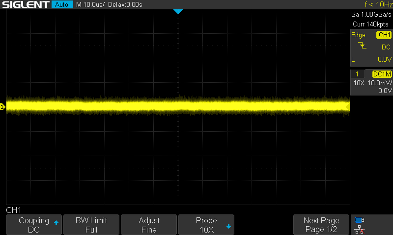

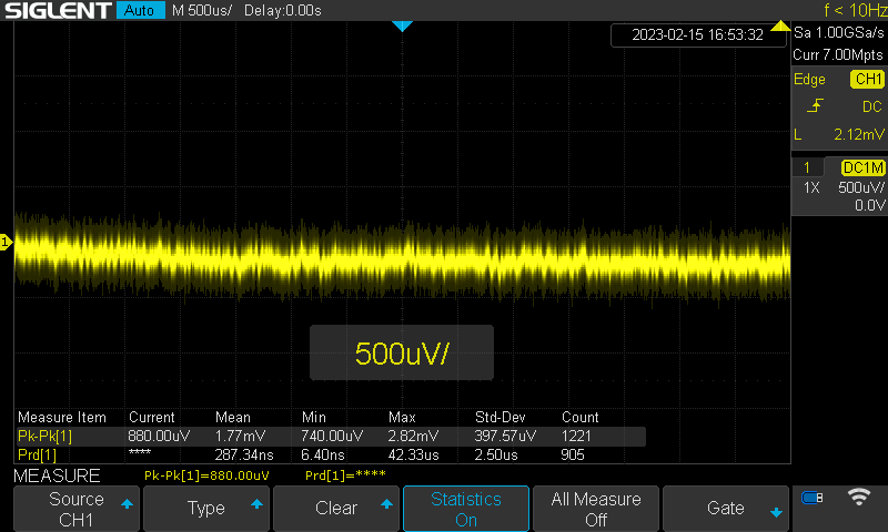

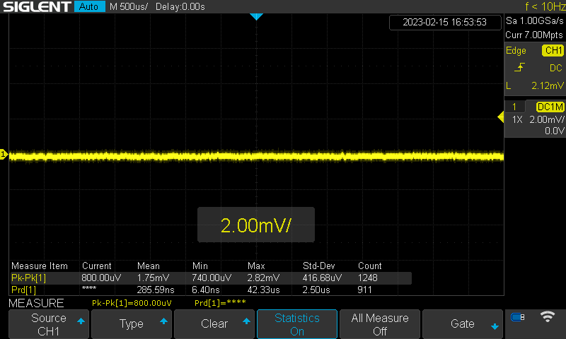

  • Lowest mV ranges show noise floor differences
    #12 20437246

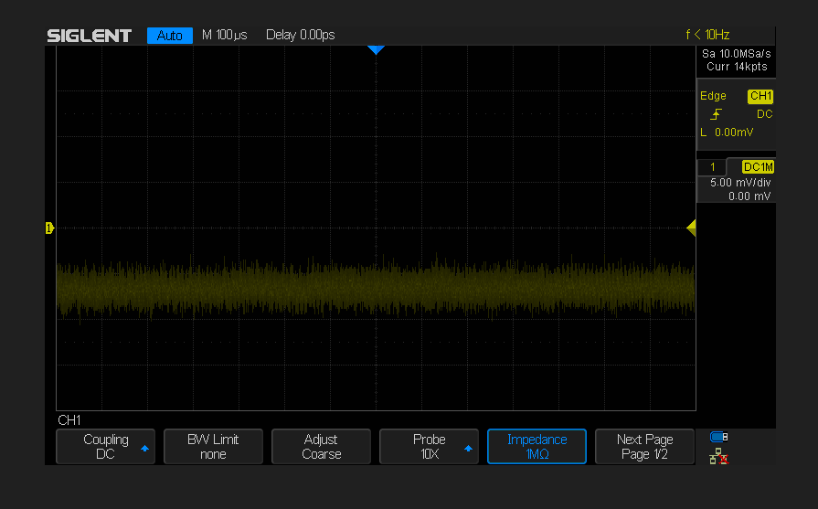

    zdzisiek1979
    Posts: 5457
    Help: 561
    Rate: 1254
    You have a screen shot of siglent 1102x at 2mV if you are interested in this voltage per plot.
    so take a quick look at the settings and evaluate.
    Seeking Recommendations for Affordable Digital Oscilloscope - No Analog or Computer Adapter Seeking Recommendations for Affordable Digital Oscilloscope - No Analog or Computer Adapter
    Note that one measurement is with the x1 probe setting, the other x10 I did not connect the probes to the oscilloscope.
    Any oscilloscope will do, only the lowest mV ranges per plot, then noise creeps in.

    #13 20437294
    rach_UMK
    Level 32  
    Posts: 1411
    Help: 208
    Rate: 399
    @tomaszwis1 you raise a completely different problem, so a new topic should probably be created.
    Do you want to directly examine the signal from the needle with an oscilloscope? forget it.
    @zdzisiek1979 with photos showed why. The oscilloscope is so sensitive that it collects a lot of garbage from the "air". LED lamp, inverter can already have an effect. Even though the oscilloscope is isolated, it also has its own noise.
    Of course you can do myk if you find it necessary to buy a fixed gain amplifier. And the other way around, i.e. when testing a phono preamp, make a silencer (like the Noise Reducer).
  • Cheap scopes show self-noise and 0.5 mV/div offset
    #14 20440128
    CosteC
    Posts: 5370
    Help: 401
    Rate: 1668
    @zdzisiek1979's screenshots from post #12 show two things: the self-noise of the oscilloscope and a large offset of 0.5 mV/Div - a classic for cheap oscilloscopes. Partially removable by switching to AC coupling and calibration after burn-in, but only partially. The hacked Rigol DS1054Z has very similar symptoms. Unfortunately, for PLN 2000-2500 it will not be better. On a different note, analog oscilloscopes usually hummed more, but it was less noticeable.

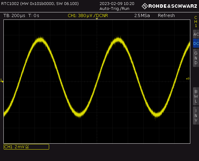

  • Calibration won’t fix the thick zero line at 2 mV/div

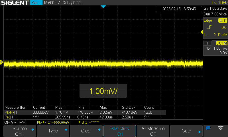

    #15 20440360
    zdzisiek1979
    Posts: 5457
    Help: 561
    Rate: 1254
    I'm afraid that calibration won't help much and it takes a long time. These types do. Taking into account the zero line and its thickness, these ranges are probably not a happy choice for measurements or rather observations. I did the calibration after it warmed up, you can feel it on the BNC sockets because they are warmer but ... I think it's more of a marketing ploy, these uV
    Here the signal and voltage per division 2mV

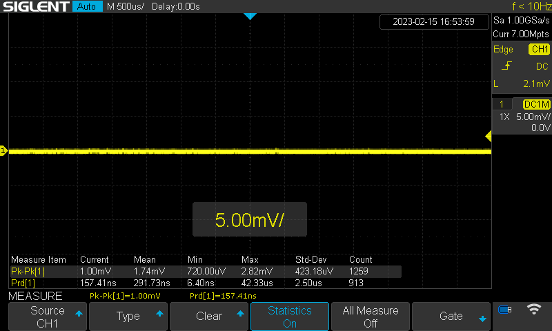

  • #16 20440485
    spy
    Posts: 770
    Help: 86
    Rate: 261
    Something will definitely help. 1104X-E:
    Seeking Recommendations for Affordable Digital Oscilloscope - No Analog or Computer Adapter Seeking Recommendations for Affordable Digital Oscilloscope - No Analog or Computer Adapter Seeking Recommendations for Affordable Digital Oscilloscope - No Analog or Computer Adapter Seeking Recommendations for Affordable Digital Oscilloscope - No Analog or Computer Adapter
  • Channel offsets shift when other inputs are enabled
    #17 20440733
    rach_UMK
    Level 32  
    Posts: 1411
    Help: 208
    Rate: 399
    @spy I have the same model. Turn on other channels and e.g. mix (1 and add 3 or 4). You may see strange phenomena.... ;)
    I don't know why, but for me channel 2 deviated the most (offset), but by combining channels (on, off) the offsets of individual channels changed slightly.
    The hotter it is, the closer it is to "0", except for channel "2".
    I don't remember, but let's assume channel 1 is like you in the picture, but by turning on, for example, channel 3, the signal on the screen with channel 1, for example, will lower it a bit.
    Just out of curiosity, @zdzisiek1979, what about the offset in Rohde (cold, warm) in relation to post #12?
  • #18 20440873
    ^ToM^
    Level 42  
    Posts: 9051
    Help: 495
    Rate: 2939
    zdzisiek1979 wrote:
    ....and also confused already. and an oscilloscope for 8k PLN
    Because it is a condition of today's constructions and it does not depend on the amount you spend. Even the more expensive ones have this problem.

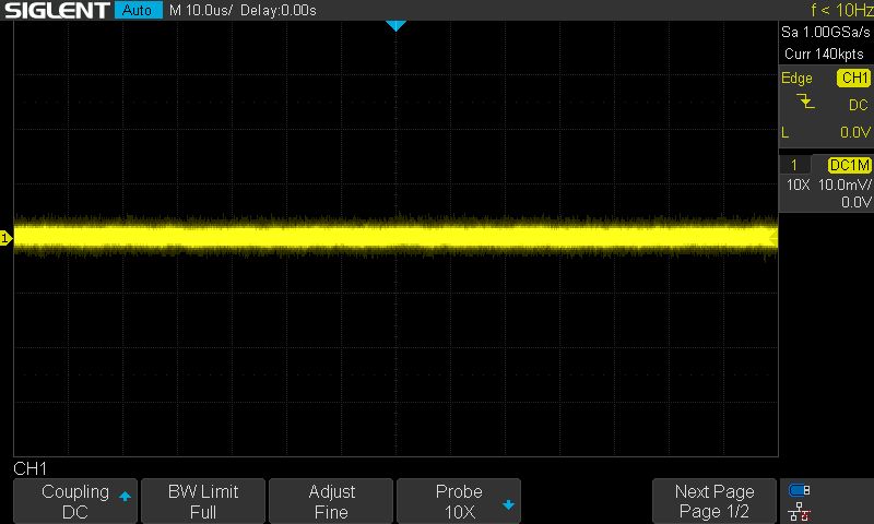

  • #20 20441182
    tzok
    Posts: 38885
    Help: 3175
    Rate: 6546
    This is what the offset and self-noise of the budget SDS1104X-U looks like:
