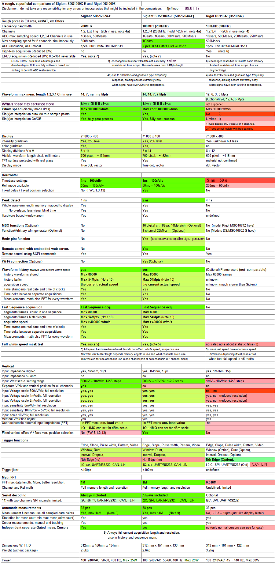

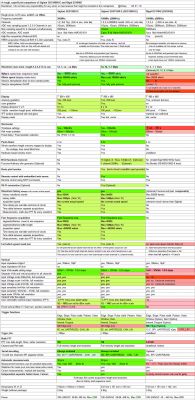

    Interestingly, Rigol has this table:
    https://ci73.aocdn.net/acton/attachment/1579/...78c-453e-9446-99b0feb30f83/1/-/-/-/-/DS1Z.PNG
    Which is not optimistic for 1000Z. You can see that Siglent is designed as a competitor - in many categories it is a bit better on paper.

    @mechatron97 You didn't mention what the main purpose of this device is. With such knowledge, more could be written.
    500uV in 1054Z doesn't work. Simply. (https://www.eevblog.com/forum/testgear/new-rigol-ds1054z-oscilloscope/1025/)
    "500uV is for another Rigol scope, the 1054z does not have that capability."
    "No, you enabled the software to use a hardware function the scope does not have. Not the same thing."
    And in Polish, info from NDN: https://www.elektroda.pl/rtvforum/topic3389900.html#16796053
    Comparing the 1054Z and 1104X-E is a bit pointless, because they are separated by an era. There is virtually no category in which Rigol would offer more or be better - both in terms of parameters and offered functionalities. Maybe there are some specific cases where something might look different/better, but in most cases Siglent works better or the same. It's like still driving on the opinion that the Passat 1.9TDI once won - great thing, but that's in the past. The table mentioned above is tragically weak, and the claim "a bit better on paper" is definitely out of place, because if you were to list the functionalities from Siglent's point of view, then the 1054Z column would be unhappy. This one is more interesting (http://teslacoil.pl/luzne-rozmowy/first-podstawowy-oscyloskop-cyfrowy-dla-poczatkujacych-t645.html):
    Rigol DS1054Z vs DS1202Z-E: Oscilloscope Selection Based on Channels, Frequency and Memory
    Additionally - there are more and more 1054Z appearing on the secondary market. People sell them as "practically new", "used a few times" for sick money (PLN 200-300 below the official retail price). Poles rarely sell something that is good and useful. Apparently, this is the last call to get rid of this equipment while still having a good reputation and add some change to buy something better. Of course, I have nothing to do 1054Z - it's a great piece of equipment and it's still useful for many, but at the prices that are demanded for it, it's currently a completely unprofitable purchase .

    mechatron97 wrote:
    mainly for working with microcontrollers
    Then 4 channels is what you need. After some time, you may find that even this amount is too small.
    mechatron97 wrote:
    The table is a bit exaggerated
    It's not overdone. She is reliable.
    mechatron97 wrote:
    because frankly, who needs the opportunity to buy a w-ifi dongle?? xD
    Anyone who has ever had the opportunity to work with an oscilloscope connected to a large monitor screen. Both oscilloscopes (Rigol/Siglent) do not have a VGA output, but Siglent has a web interface where it is possible to view the oscilloscope screen in near real time. Of course, with the limitations that are natural for VNC, which is used here. (yes, you can also connect via ethernet cable, but now almost everything works on wi-fi, so why not?)
    You will appreciate in a dual-monitor setup, where you have the code you are working on on one screen, the preview of what is happening on the oscilloscope on the other, and all the test equipment can be lying somewhere nearby, where coffee/cola/water will not spill on it/ nothing or no one will touch the cable with their elbow. Then you don't have to shake your head like a chicken or a pigeon. You can even leave the whole thing at work and connect to an oscilloscope from home to check what's going on with the equipment. The knobs can also be "turned" remotely.
