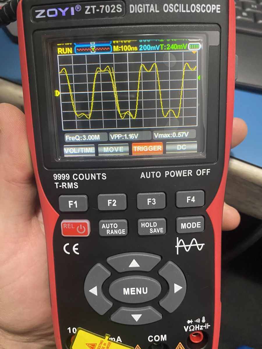

    My copy arrived today. I chose ANENG AOS02 because it was the cheapest and for the price of the basic set of PLN 258.97 I got the PRO version with additional test leads (theoretically it was a more expensive option). The order arrived within 10 days. I have software version 1.03.51.
    I checked the multimeter with a voltage standard and it is perfect, the error is +/- 1 of the least significant digit. Resistance measurement, also "on point" with my "standard" resistors. The multimeter`s measurement bandwidth is typical of 1 kHz (here the MT8206 with a bandwidth of up to 150 kHz simply "rocked"). The software version reminds you to use the correct measurement terminals each time you switch from voltage measurement to current measurement.
    The oscilloscope remembers the settings, but the multimeter does not, and the operating mode (oscilloscope/multimeter) is not remembered either.
    Indeed, waveforms above 2 MHz "float" a bit, but an oscilloscope up to 5 MHz is quite useful and you can easily recognize the shape of the waveform. 10 MHz with sampling 48 MSa/s is, of course, fiction. The interface is responsive and quite intuitive to use. The chart is refreshed very quickly, nothing "cuts off". Unfortunately, the sensitivity of the input track is poor - with the x10 probe, the minimum sensitivity is 200 mV/div. (old Velleman HPS40 had 50 mV/div), maximum only 100 V/div. There`s nothing crazy about the time base either - from 100 ns/div to 20 s/div (roll mode from 250 ms/div). In practice, this means that you can conveniently observe waveforms with a frequency of up to 2 MHz and an amplitude of at least 1 V. The trigger level is scaled proportionally to the sensitivity and it cannot be set to 0 V (for the highest sensitivity it is 10 mV in 20 mV steps) . After performing the calibration procedure, it can be set to 0, but there is approximately -3% offset relative to the indicated trigger level, i.e. for a sensitivity of 1 V/div. (10V visible on the screen), when setting the trigger level to e.g. 0V, in reality it will be set to -300 mV.

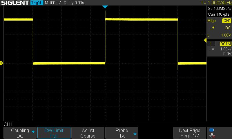

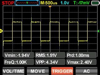

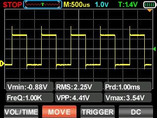

    Hello. My copy arrived on Saturday and I have a small problem with it. When I calibrate the probe on the x10 divider, the waveform is perfect, but as soon as I switch to 1:1, strong spikes appear and I can't do anything with them. System calibration did not help, software update did not help and with the 1:1 setting it does not respond to turning the control. Is this also the case in your copies? I've already checked the connections, but nothing helped. Could this be due to a poor probe? Thank you in advance for any help.
    Oscilloscope display showing an unstable waveform. Oscilloscope screen showing a square waveform and signal parameters. Oscilloscope screen showing a square waveform with signal parameters.
  • #8 20737266
    tzok
    Posts: 38693
    Help: 3162
    Rate: 6464

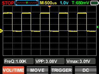

    Out of habit with a normal oscilloscope, I never use the x1 mode and for me it might not be there. This mode has no compensation and this is a general rule. I checked and such pins are also visible, I don`t know if it interferes with anything...
    Here is a comparison of the same probe with Aneng, on Aneng and on a real oscilloscope:
    Oscilloscope screenshot showing a square wave.
    Oscilloscope screen displaying a square wave signal.
    Just an auxiliary question - have you connected the ground cable of the probe?

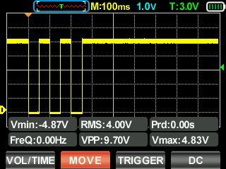

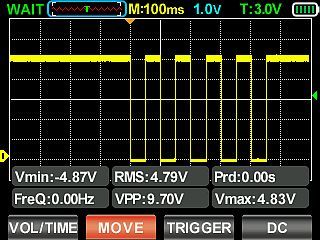

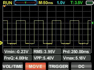

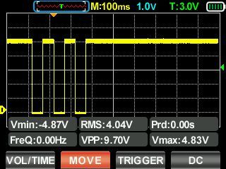

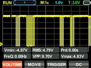

    I bought such an oscilloscope as additional support for controlling pulses with a fairly long duration of 50-300ms, so that I could have it in one compact device together with a meter. I was a bit surprised, the "NORMAL" trigger only works up to a base of 100ms and there are problems here, it loses impulses, triggers on one impulse in turn. The situation gets worse the further the trigger point is moved from the default center of the screen to the left. For a base of 50ms and below, everything works fine.
    Another difficulty is the problematic navigation of the memory buffer, recording signals with a long base allows after stopping the recording "STOP" to reduce the base and view the buffer with the "MOVE" function, but because the "memory map" on the screen is not recalculated for a given base (something changes there only in ranges below 250us, but this probably represents a limitation of the sample capacity) and when moving sideways there are no signs of movement, so navigation is quite inconvenient, but you can see something there.
    The above problems are rather software-related, so you can count on them being removed in newer versions, provided that the manufacturer puts in the effort.
    Oscilloscope screen displaying a waveform with visible pulses and measurement data.
    Correct 5 50/50ms pulses
    Oscilloscope screen displaying pulse waveforms with a description at the bottom.
    Two pulses lost
    Oscilloscope display with a pulse waveform on a grid background.
    Two pulses lost. Trigger on the second pulse
    Oscilloscope displaying pulse waveforms with triggering issues.
    Buffer with a base of 1 s/div filled with pulses, the map shows the whole thing (on the right you can see some remnants of previous waveforms)
    Oscilloscope screen showing a pulse waveform with parameters displayed at the bottom.
    The same buffer in a close-up of one of the series of impulses, we cannot see on the map where we are in the buffer

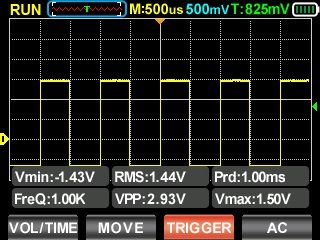

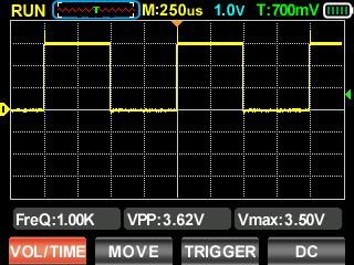

    A resolution of 1°C when measured with a K probe is simply... realistic. You can display the result with 3 decimal places, but why?

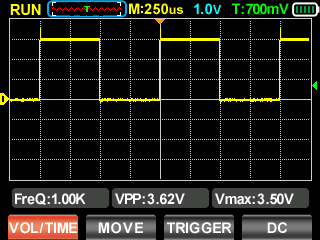

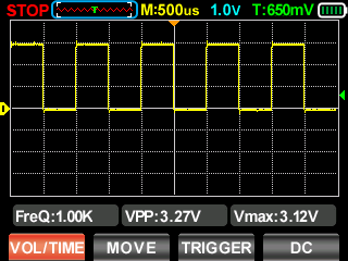

    The oscilloscope probe switch works correctly for me:
    - probe at x10 and x10 set in the menu: Vpp of the calibration signal = 3.08V (1V/div):
    A digital oscilloscope screen displaying a square waveform at 1 kHz frequency.
    - probe on x1 and x1 set in the menu: Vpp of the calibration signal = 3.27V (1V/div):

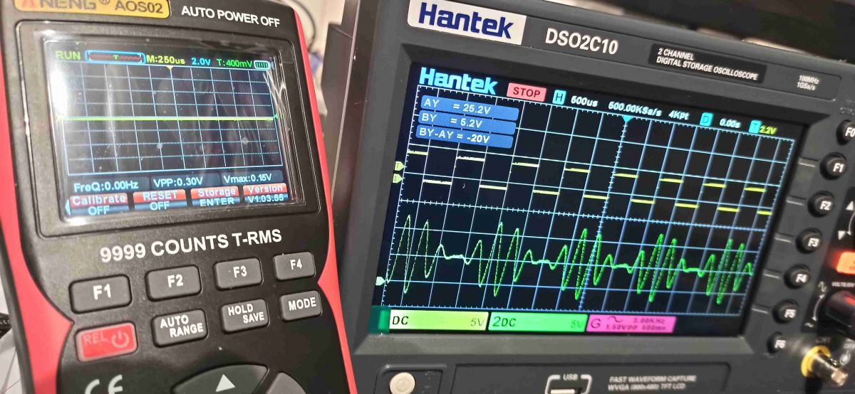

    Complete success with Hantek purchased in the manufacturer`s store motivated me to further experiments.
    PLN 200 is not a fortune, it`s a pity you can`t make a copy like you can with an oscilloscope.
    Hantek DSO2C10 digital oscilloscope and digital multimeter showing waveforms on their displays.
    Added: and after the procedure, the current firmware version is 58,
    I don`t know what it adds or improves, I just have such a rush to update everything.

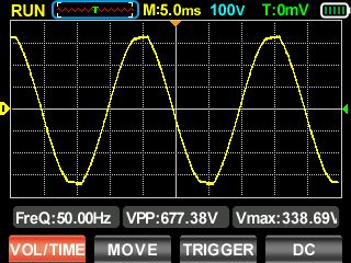

    ozgas wrote:
    Subsequent software corrections mean that the oscilloscope reproduces waveforms better and better. Unfortunately, there is still a lot of work ahead for ZOYI...
    It`s similar for me with DC coupling. However, after reducing the gain to 2V/div. indicates correctly. With AC coupling, measurements are correct regardless of the selected gain.

What causes the ZT702S/AOS02 NORMAL trigger to miss long pulses at slower time bases like 100 ms/div or 1 s/div, and what workarounds help?
Users traced the missed pulses to firmware behavior in NORMAL trigger mode at slow bases, not to a broken input. One tester using 50–300 ms pulses said NORMAL worked properly at 50 ms/div and below, but at 100 ms/div it started dropping pulses and could trigger on every other pulse. The same post also described awkward buffer navigation after capture. A workable approach is to capture, stop, reduce the base, and inspect the buffer with MOVE, though the memory map still stays confusing. [#20737656]
