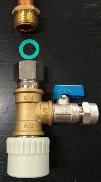

    hmm 3/4 external thread, I wanted to do the exit and entry of the PP32 CO pipe, so there I would have to give some reduction for 1 "or immediately the reduction from this external thread 3/4 immediately under the pipe pp32? what do you think (see diagram) yes I will had all the valves etc. Connecting the central heating and hot water installation to the gas furnace

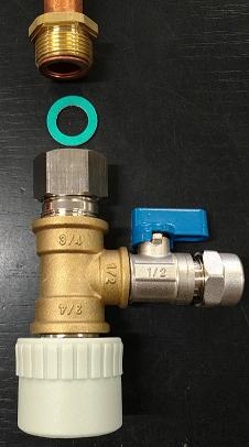

    I would do like this:
    I would give half-union 3 / 4-3 / 4 + tee 3 / 4x1 / 2x3 / 4 + PP32 weld fitting with 3/4 "external thread. In outlet 1/2 in the tee it is good to give some drain valve for later servicing of the boiler. supply and return the same.

    A very nice combination :) this 1/2 valve is instead of this water discharge what's on the diagram?
    and you supply WHAT also do without a 1/2 valve?
    and connecting the boiler with the storage tank? (maybe you also know a good way to later not spit in the chin "why I didn't do it right now ...." ??? thanks

    Do the same with the valve. Drain valves under the boiler are always useful - even to flush the boiler. You close the installation and do whatever you want with the boiler.
    To connect the tank I would give a half union without a T-piece, only a shut-off valve and a transition adapter for the pipe you will be connecting. When you give the shut-off valves you will be able to disconnect the tank if something happens to it and the boiler continues to work.
