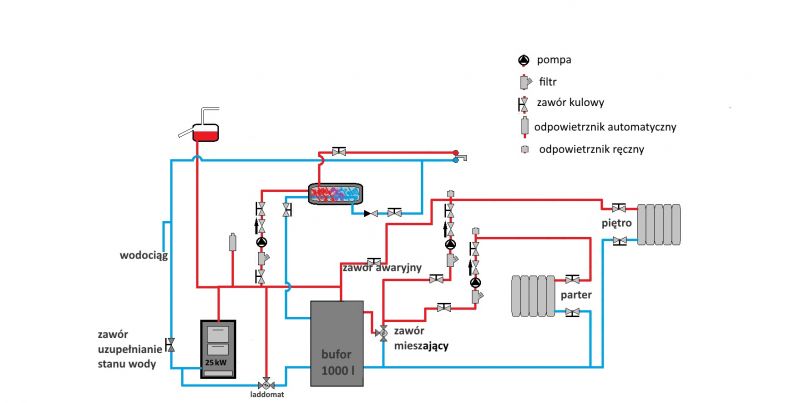

    I plan to do the installation at home myself, I drew a diagram, please give feedback and comments if something is wrong.
    The drops in the central heating installation are significant and will be as shown in the diagram.
    I plan to connect the pipes to the buffer at the same height as in the diagram.
    The valve marked as emergency will be opened in the event of a power failure during burning in the furnace or other failures.
    Diagram of central heating and domestic hot water installations with a buffer -
    I am asking for opinions and comments on this scheme.

    What is this boiler? Connections between the boiler and the buffer should be made with thick pipes, preferably min. 5/4, or better 6/4 "with appropriate slopes, it will facilitate work in natural circulation.
    http://czysteogrzał.pl/instalacja-grzewcza/bufor-ciepla/
    I recommend the diagram according to nilsan, the last one in the given link.

    The pipes will be as large as possible. I was wondering if the valves between the boiler and the buffer are a good idea?
    I do not understand the given diagram, I do not see the possibility of precise regulation of the return temperature. For me, this diagram to which the link is given in the post above is somehow overcomplicated.

    This layout (according to nilsan, not others) just has no drawbacks of the ladomat, read the whole topic carefully.
    The temperature can be regulated very precisely, which is why there is a ZT valve, i.e. with a thermostatic head and a sensor with a capillary 9, which measures the return temperature and corrects the opening of the valve on an ongoing basis to create a mixing effect.

    The IMO system is overcomplicated. Well, I have the opinion that the simpler the better.
    The furnace of the type specified by you requires a power supply. No power supply means that all pumps are stopped (including the entire Laddomat) and the furnace is stopped.
    And there is no LADDOMAT. There is a circulation pump and a three-way thermostatic mixing valve, which is simple and understandable. Some crooks have come up with a new name for the elementary set of pump + mixing valve, put it in one box and do business. Probably the largest on the included flare nuts. I am of the same opinion about the famous ball valve which is supposed to enable gravity operation in the absence of electricity, especially in floor heating systems with a decent gas boiler.

    You will have a beautiful venting through the expansion vessel
    And I just don't want to vent through the expansion vessel.
    The boiler is to operate at high temperatures and it is better if the air escapes through the vent than through the pipe to the expansion tank.
    I know what is happening when there is a lot of gas in such a pipe to the expansion tank, I saw the effects.
    I even want to install a tee so that the leg leading to the tank points downwards, so that under normal conditions the pipe does not get air in it.
    [quote = "seiko.36"]
    I wonder what did you see? Sure how it throws the water out of the vessel? It throws out and with such a connection as in the diagram it will be thrown out. The vessel connection is wrong. It should be like this Diagram of central heating and domestic hot water installations with a buffer -
    Unless you've seen something else, but I can't imagine what - a properly connected vessel naturally ventilates the installation and has no negative effects
    And this is against the regulations - the pipe to the vessel should be led ascending all the time, without siphoning. I advise you to review the standard.

    What have i seen Like water in a boiler, it boiled so much that it fired, and the water from the expansion tank did not run out, because the steam did not release.
    OKAY . valuable note, it will be in accordance with the rules of course.
    hajtaler wrote:
    you are looking for applause for your inventions rather than advice
    You have a right to think so, but I'm seeking advice.
    There will be two pumps, because I do not use thermostatic heads, but room regulators on both levels.
    This is what I thought of and it will be so. Is it legal?

    It must have been a badly connected vessel. If you connect to the vessel as in the diagram I added, and lead from the boiler as vertically as possible (preferably as in your last diagram to this vent). Then you can cook at will and nothing bad will happen. The water will not be thrown out from the vessel, but the steam will escape through the upper pipe and crash against the water level in the vessel, and excess will escape through the vessel's venting.
    The regulations only regulate the protection of the boiler. What and how you mount it on the installation is up to you.
    Then ok, but I don't know (I'm not sure) if you need a separate mixer for each pump
    Below you have the standard for connecting the vessel. Especially point 2.6

    What about the safety tube?
    In point 2.2 it is not listed as "Basic Safety Devices" so it doesn't have to come from the boiler, I conclude.
    The diagram below is changed.
    hajtaler wrote:
    Then ok, but I don't know (I'm not sure) whether you need a separate mixer for each pump
    I plan to use a HERZ MIXING VALVE 6/4 "with a KVS 25, so I don't see a problem with blocking or anything. Each pump will get what it takes.

    It is entered - 2.2b as securing tubes and in 2.6 it is specified what kind of tubes they are. The safety pipe is among them. As you have in the diagram, it may be better if it goes straight from the boiler. If you leave it like you do now, it is worth giving 90 ° bends to a longer section of 2x 45.
    This automatic air vent must not be there - with the return pump, the air vent on the suction side of the pump will draw in air
    The regulations do not prohibit it, so it will be.
    I saw an air vent above the buffer in various diagrams, for me it will be close to the boiler with a minimum drop towards the buffer.
    The expansion tank will be 6 meters above the boiler and it is not possible to suck in air through the vent, because there will be a pressure of 0.59 bar above the stove.
    Now I will show you what is my idea for a safe connection with the expansion tank. Now you can write that I am wise :D
    It doesn't meet the rules, I know, but is it such a bad idea :?:
    In such a system, I would definitely not use an automatic air vent.

    It is not about the static pressure of the water column, but about the negative pressure - the installation with the pump on the return works under negative pressure, so it will suck, but you are right - it is not forbidden.
    Such connection of the vessel as shown in the diagram is in accordance with the standard (required when there is more than one boiler in the installation. As there is one boiler, RB and RW can be common. Everything is in the standard)

    It is compliant with the standard - in installations with one boiler it is possible to install only separate pipes. I would install one pipe but lead vertically into the vessel as in the last diagram
    When the vent will draw air, just turn it off.
    Filling up the installation should not be done "rigidly" only, for example, through a hose from a washbasin faucet or a toilet or an ordinary garden + quick coupler
    Added after 5 [minutes]:
    If you will leave the RB with your knee, you must remember about the dependence of the length of the vertical section from the boiler to the first bend to the sum of the length of the horizontal sections, which is 10x the vertical length. It is a bit complicated and in practice it means that if you use a bend, e.g. 10cm above the boiler, the sum of the lengths of all horizontal sections of the RB is max 1m (if you use slants, 45st bends are the length of the horizontal projection)

    With an open system, there is no need to use additional protection in the form of valves 1f, 2f or cooling coils, but there is also no prohibition. In this case, the boiler-buffer gravity flow is ensured.
    This valve 1f has an opening temperature of 95 ° C with high hysteresis, which means that the real opening temperature will be close to the operating temperature range of the boiler.
    I would install. So as to cut off the buffer both from the boiler and from the central heating - in the event of any work, renovation, service, etc., it would be a pity to drop 1000l of water ...
  • #25 18090681
    seiko.36
    Posts: 61
    Rate: 28
    I modified the scheme, put the valves at the bottom.
    Now it remains to choose pipe sizes, list couplings, valves, etc., and it's not easy to understand everything.
  • #26 18097051
    hajtaler
    Level 21  
    Posts: 346
    Help: 52
    Rate: 78
    Bad connection at the cookware. DHW circuit when you take the power from the boiler circuit, it also returns directly to the boiler return - I corrected it. Check valve on the return to the buffer so that the 3d valve for cold water mixing does not take from the buffer only from the return of the radiators
  • Buffer outlet should stay at the highest point
    #27 18097113
    seiko.36
    Posts: 61
    Rate: 28
    It is actually better with the cookware.
    As for the check valve, I am not sure if it is really needed, because the pumps will create pressure, or rather the movement of the water, so cold water will be taken first from the return from the radiators, and not from the buffer.
    As for the return from the DHW heater, such a connection is not an option, because the return to the boiler must be controlled by the Laddomat, and in this connection the temperature of the water returning to the boiler cannot be controlled.
    I do not understand what is wrong in my scheme, I wanted the DHW heating water outlet at the highest point of the buffer.
    The pipe connecting the boiler outlet and the buffer serves two functions: when the boiler is working, hot water goes to the buffer and, if necessary, to the heater, when the boiler is not working, water is taken from the buffer, I see nothing wrong here.
  • Buffer tank and gravity bypass prevent boiler boiling
    #28 18097876
    andrzej lukaszewicz
    Level 42  
    Posts: 7034
    Help: 626
    Rate: 2121
    seiko.36 wrote:
    Kot-huncwot wrote:
    I do not know how such a boiler behaves in the absence of power, but probably completely different than when powered by electricity. And this is what I wanted to draw my colleague's attention to.
    The only dedicated safety device is the BVTS single-function cooling valve z
    1.3 m capillary, and on my side, an emergency valve that allows gravity circulation bypassing the pump.
    After all, the system with a buffer itself prevents boiling, because there is a flap valve on the return to enable work in natural circulation. A fully filled 25kW boiler will never boil 1000l of water.
  • Buffer tank prevents boiler from boiling
    The installation works for several months, it has never boiled, one charge will never boil 1000 l of water, I confirm.
    I provide the final, field-proven installation diagram that I can recommend.
