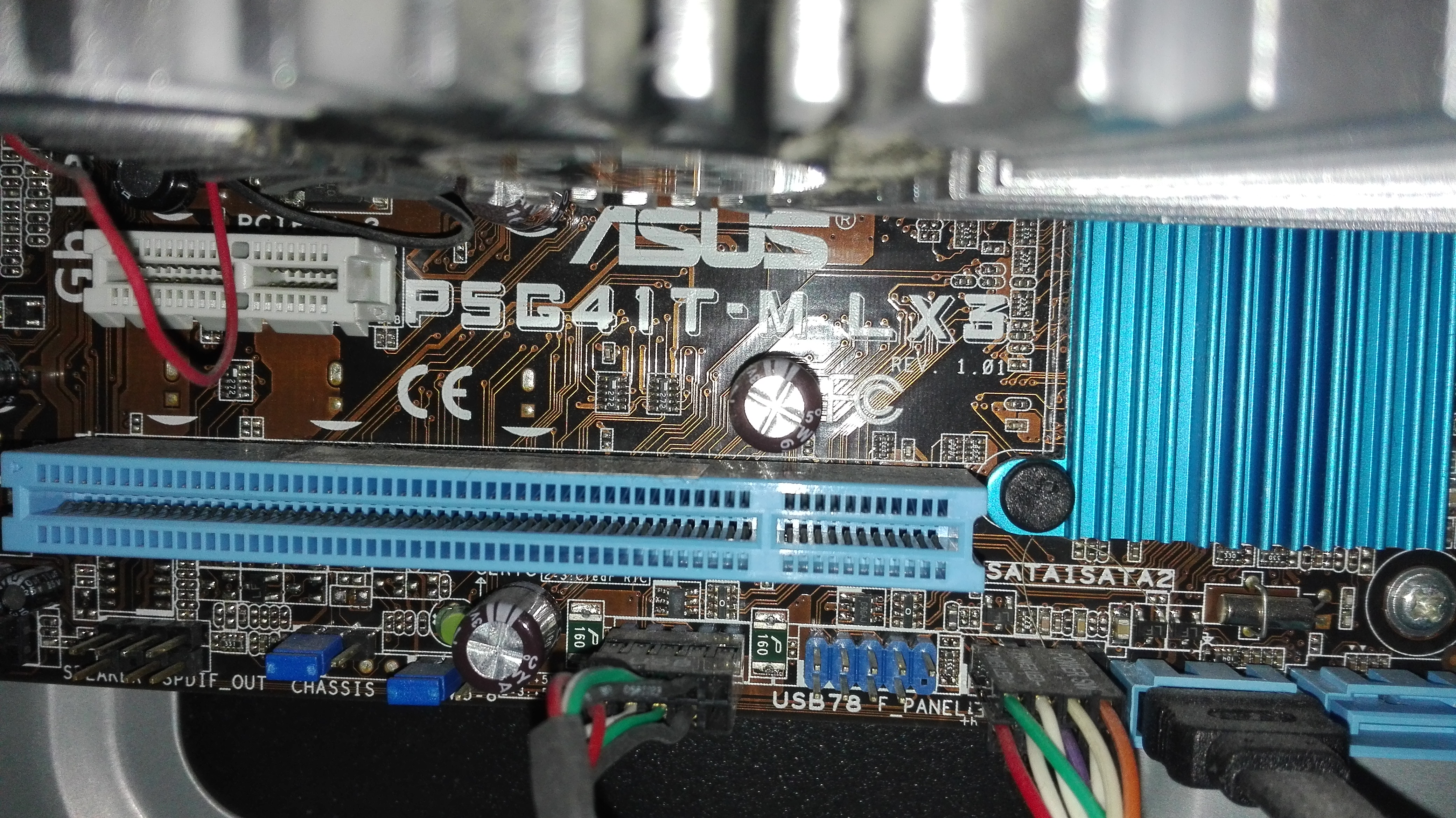

    The motherboard is an asus P5G41T-M LX3
    You can enter the bios, the keyboard also works in it
    In bios, I read that the connected usb devices are 1 mouse and 1 keyboard
    • Mouse and Keyboard Inactivity Post-Disk Format: Stuck on Language Selection Screen 1512768357381-409061973.jpg (4.15 MB) You must be logged in to download this attachment.

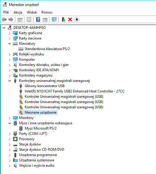

    What does the device manager look like? Do you have everything installed or maybe there are any devices with missing drivers?
  • #13 16880520
    MeXu
    Posts: 18
  • #14 16880548
    Kolobos
    IT specialist
    Posts: 85178
    Help: 17171
    Rate: 10456
    Enter the ID of this unknown device (ven and dev). For this give an error message regarding the USB controller and its identifier (ven and dev), you have everything in the properties.
  • #15 16880560
    MeXu
    Posts: 18
    unknown device
    \ VEN_8086 & DEV_27C9 & SUBSYS_81791043 & REV_01 \ 3 & 11583659 & 0 & E9
    \ VEN_8086 & DEV_27C8 & SUBSYS_81791043 & REV_01 \ 3 & 11583659 & 0 & E8
    Are the controller these 3 Universal USB Serial Bus Controllers?
  • #17 16880593
    MeXu
    Posts: 18
    Yes.
    Check these drivers for VEN_8086 & DEV_27C9:
    https://devid.info/41328/Intel(R)+N10/ICH7+Family+USB+Universal+Host+Controller+-+27C8
    Unpack the file after downloading and select driver updates in device manager, selecting the directory with unpacked drivers.
    \ VEN_8086 & DEV_27CA & SUBSYS_81791043 & REV_01 \ 3 & 11583659 & 0 & EA
    \ VEN_8086 & DEV_27CB & SUBSYS_81791043 & REV_01 \ 3 & 11583659 & 0 & EB
    I have a problem, one of these controllers tried to update and it disappeared and I got this message

    Check if the system searches for drivers via Windows Update.
  • #19 16880603
    MeXu
    Posts: 18
    device unknown has updated the drivers.
    No.
    Thanks !!!! Savior
    i used the same drivers wherever there was an exclamation mark and now it works. Thanks !!!
