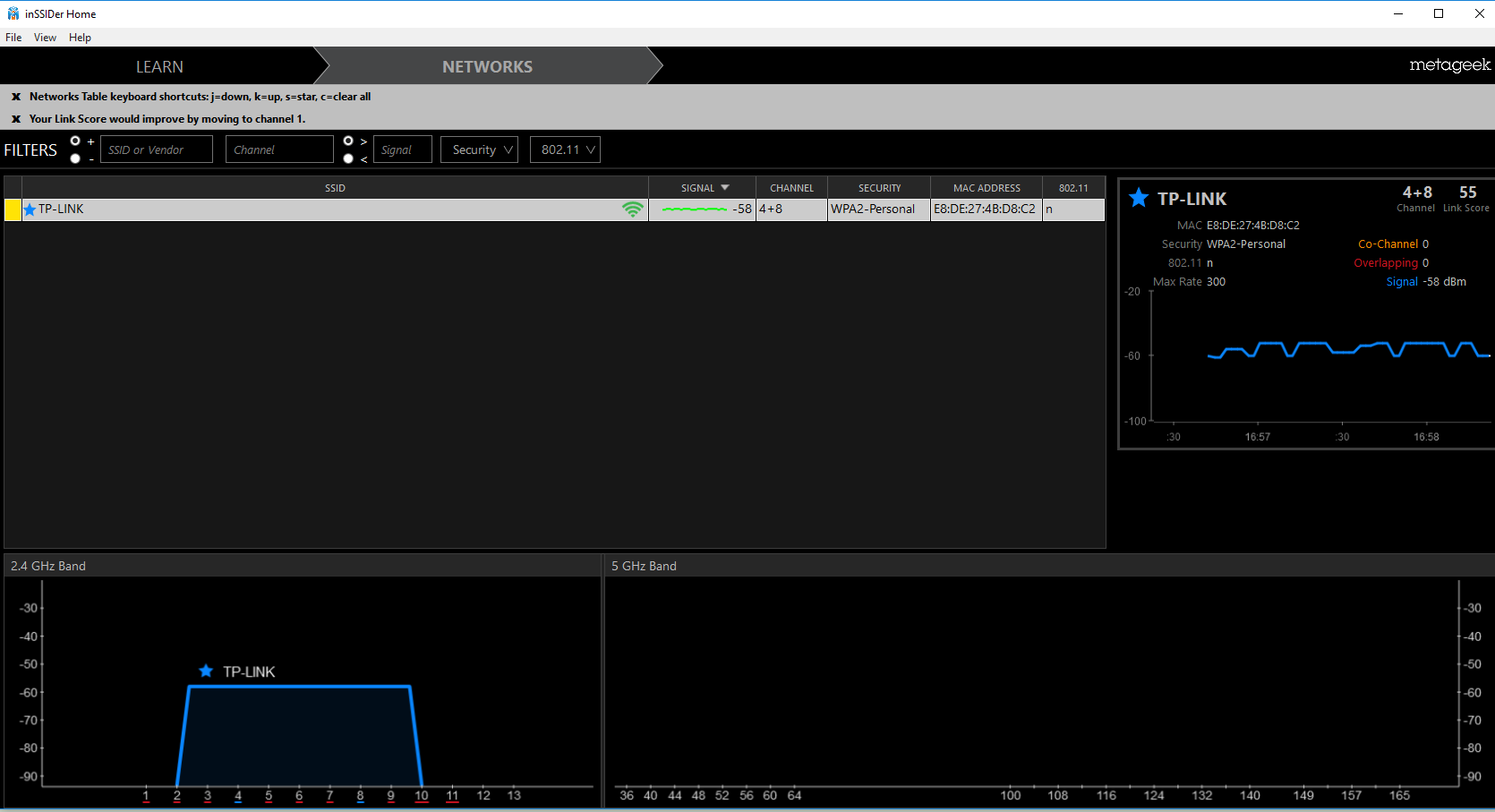

    Do you have a dual card on a laptop? scan the network with inssider 2.x, both bands 2 and 5ghz, show the results.
    If you have a piston at 2ghz, push the 5ghz (dual band) router.

    At 2.4GHz you have clean, so I would leave N, with good winds you will get 120Mb / s. More at 5GHz, but do all your devices support this band?
