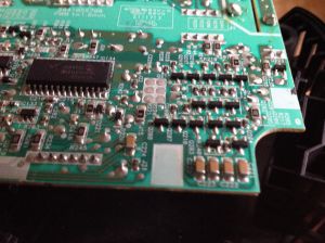

  • #4 16890724
    nik23
    Posts: 32
    Rate: 18
    Dewalt 105dcb Battery Charger Issue: Red LED Flashes, Not Charging, Eadp-84 CD, Troubleshooting Dewalt 105dcb Battery Charger Issue: Red LED Flashes, Not Charging, Eadp-84 CD, Troubleshooting Dewalt 105dcb Battery Charger Issue: Red LED Flashes, Not Charging, Eadp-84 CD, Troubleshooting
  • #5 16891485
    michalek1988
    Level 26  
    Posts: 675
    Help: 68
    Rate: 181
    To start with, at the output of the charger, where you plug the battery, once without it and once with it, if you have another functional, you can take measurements on both, and make an analogy. Determine which of the pins is mass and measure its next. When writing about photos, I wanted electronics more than housing.

    In the first post you have measurements without battery on Sunday, I will take measurements on both and disassembled this inoperative and I will give a photo

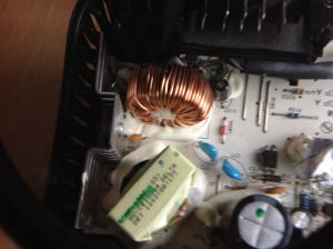

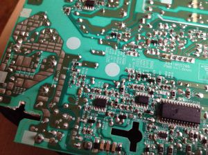

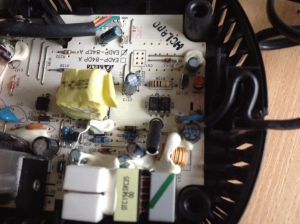

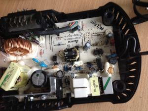

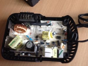

  • #7 16900589
    nik23
    Posts: 32
    Rate: 18
    Dewalt 105dcb Battery Charger Issue: Red LED Flashes, Not Charging, Eadp-84 CD, Troubleshooting Dewalt 105dcb Battery Charger Issue: Red LED Flashes, Not Charging, Eadp-84 CD, Troubleshooting Dewalt 105dcb Battery Charger Issue: Red LED Flashes, Not Charging, Eadp-84 CD, Troubleshooting Dewalt 105dcb Battery Charger Issue: Red LED Flashes, Not Charging, Eadp-84 CD, Troubleshooting Dewalt 105dcb Battery Charger Issue: Red LED Flashes, Not Charging, Eadp-84 CD, Troubleshooting Dewalt 105dcb Battery Charger Issue: Red LED Flashes, Not Charging, Eadp-84 CD, Troubleshooting Dewalt 105dcb Battery Charger Issue: Red LED Flashes, Not Charging, Eadp-84 CD, Troubleshooting Dewalt 105dcb Battery Charger Issue: Red LED Flashes, Not Charging, Eadp-84 CD, Troubleshooting Dewalt 105dcb Battery Charger Issue: Red LED Flashes, Not Charging, Eadp-84 CD, Troubleshooting
    How do you remove this white silicone or glue? Heat hot air or some solvent? So as not to damage the disc
    Added after 53 [minutes]:
    Dewalt 105dcb Battery Charger Issue: Red LED Flashes, Not Charging, Eadp-84 CD, Troubleshooting Dewalt 105dcb Battery Charger Issue: Red LED Flashes, Not Charging, Eadp-84 CD, Troubleshooting Dewalt 105dcb Battery Charger Issue: Red LED Flashes, Not Charging, Eadp-84 CD, Troubleshooting Dewalt 105dcb Battery Charger Issue: Red LED Flashes, Not Charging, Eadp-84 CD, Troubleshooting Dewalt 105dcb Battery Charger Issue: Red LED Flashes, Not Charging, Eadp-84 CD, Troubleshooting Dewalt 105dcb Battery Charger Issue: Red LED Flashes, Not Charging, Eadp-84 CD, Troubleshooting Dewalt 105dcb Battery Charger Issue: Red LED Flashes, Not Charging, Eadp-84 CD, Troubleshooting Dewalt 105dcb Battery Charger Issue: Red LED Flashes, Not Charging, Eadp-84 CD, Troubleshooting Dewalt 105dcb Battery Charger Issue: Red LED Flashes, Not Charging, Eadp-84 CD, Troubleshooting Dewalt 105dcb Battery Charger Issue: Red LED Flashes, Not Charging, Eadp-84 CD, Troubleshooting Dewalt 105dcb Battery Charger Issue: Red LED Flashes, Not Charging, Eadp-84 CD, Troubleshooting Dewalt 105dcb Battery Charger Issue: Red LED Flashes, Not Charging, Eadp-84 CD, Troubleshooting Dewalt 105dcb Battery Charger Issue: Red LED Flashes, Not Charging, Eadp-84 CD, Troubleshooting
    Added after 7 [hours] 21 [minutes]:
    I got a charger with the same disc, I got it from a work colleague but it is damaged, it has burned paths and torn pads, I took it for this part, but first I will try to cover the path and the pads, it may stand up
