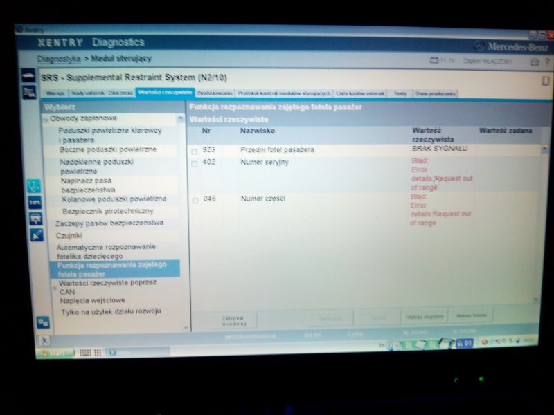

    I was at a guest today at XENTRY but none of this, the mat module is invisible at the weekend I check the plug cables maybe something will flicker I attach a photo with an error or rather Error

    Hello, gentlemen, after a short break, I fought a little bit about the subject, I checked the fuses, the cubes, the transition to the module, but there is nothing to cling to everything factory-wired. Maybe somebody has some scheme with SRS system. maybe someone knows what to check on the output in the cube under the chair is to be voltage resistance. Please, if anyone has access to the schematics, share a piece about the safety system.

    Mr. "Night" on the basis of my VIN showed me the number of the mat that will work in my car. And that's how the mat with the parcel was purchased for around PLN 150. solved the whole problem. What was my surprise when after connecting the mat and turning on the ignition the red pillow light went out on Amen, there was no need to even reset errors.
    Still, my good advice do not play any emulators because first there are no emulators for the Mercedes W204, and secondly it is not worth it if for this price you can buy a used mat and have a fully functional system on which the lives of your loved ones depend. If you are struggling with the mat, you should also check the fuses that are responsible for the SRS system. And in the yellow cube from the mat under the armchair with three pins you can check the weight is on one and the voltage + 12v to +15 on two after turning the ignition is roughly hopefully useful
