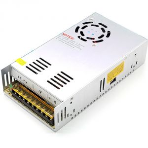

    I used a bipolar serial connection, but to power it I used a 24V power supply with S-360-24 nominal and 15A capacity;
    Stepper Motor Control: Direction, Speed, JK86HS78-4802-04 Model, AVR Microcontroller, TB6600 Driver
    Theoretically, I would like to remain with this tension for technical reasons of other elements of the project. For example, the control lamps or 24v fans used, which are more easily available and cheaper than models with a nominal 48v voltage. Apart from the very fact of the driver's limitations, where the maximum possible voltage is 42V, which significantly excludes the use of a 48v power supply, although you could use a 36V power supply and 48v fans which usually work from 24 to 52v but only if we would like to improve the performance of the stepper motor, i.e. obtain more torque at higher revs, which translates into an increase in maximum revolutions.

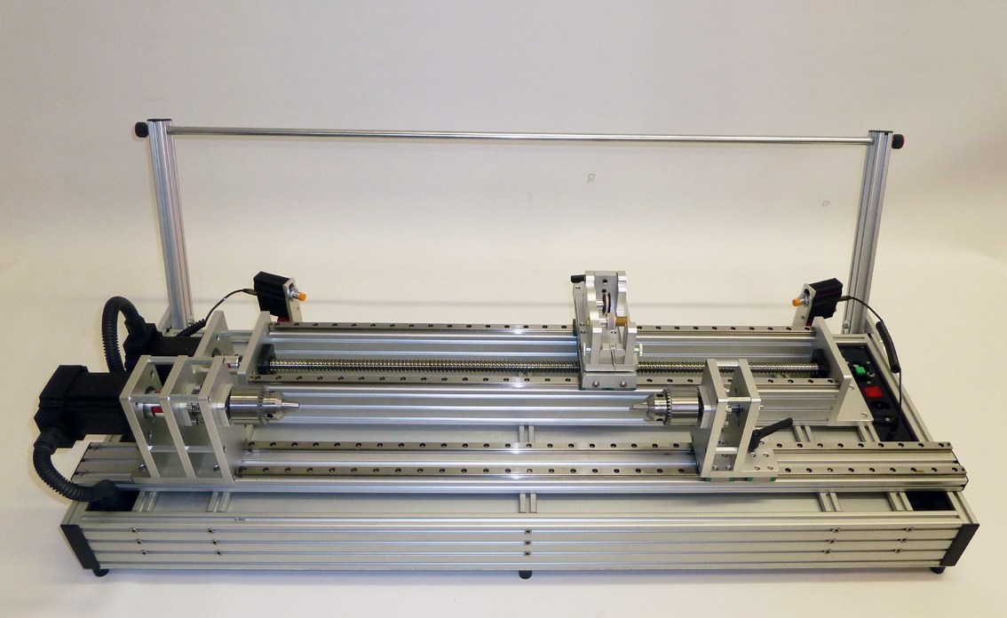

    Maybe let's approach the topic differently ...
    https://www.youtube.com/watch?time_continue=74&v=sl8cYPr-soY
    We have two stepper motors there. The main motor in this topic and the feed motor. It is difficult for me to determine what the max RPM is there, but from what I have read it is probably 2200RPM, moreover, you can see exactly "ramping". Rapid motor movement could break the thin wire, so slow acceleration and braking is necessary.
    From the video above, it looks like this:
    and even though there are several versions of the project: mini, 200mm, 600mm and even bigger, and a lot about it at http://www.ukcnc.net/
    my project is to be different but the principle of operation of the engine is similar ...
    In the projection shown in the movie, the controller is connected to a computer and controlled by software installed on the unit. But in my case, at least initially, the control is to be without a computer. The drivers that I chose at least initially, not necessarily the TB6600, compared to the drivers of the above-mentioned project, are "giants", and the main engine itself is large, but my project requires it.
    The software topic that I am familiar with is the following:
    https://www.elektroda.pl/rtvforum/topic3212515.html
    a DC motor was used there, which you also mention, but it does not expect such high revolutions, and the tension force of the stepper herds.
    I think it will be easier now ... to write software for the controller to achieve the above effect.
