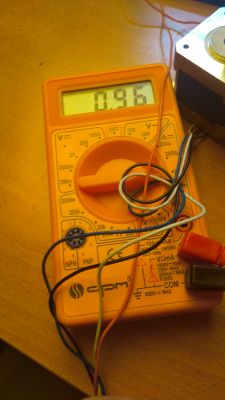

    I also have the NEMA 1.7 A set and A4988 stepsticks. Yesterday I regulated them at 1.20 V - this is the maximum value that I can set (I read that Chinese controllers have a blockade of just 1.2 volts so as not to burn them). Unfortunately, I can't spin the engine at all. Zero reaction on his part. Anyone know what the problem is? Is it the fault of the stepstick and too low reference voltage for this motor (according to the formula should be 1.34V)?
  • #13 18009172
    qavr
    Posts: 60
    Help: 6
    You confuse voltage with tension. Upload a diagram and layouts.

    xChrislinex
    Forgive me for delay.
    I use the kit purchased from the ABC RC website (https://abc-rc.pl/pl/products/zestaw-elektroniki-reprap-ramps-mega2560-ch340-r3-a4988-4szt-drukarka-3d-7211.html).
    The parts are:
    Arduino Mega CH340 clone,
    RAMPS 1.4 RepRap controller,
    Stepsticki: (https://abc-rc.pl/pl/products/sterownik-silnika-krokowego-a4988-stepstick-drukarki-3d-reprap-cnc-6332.html) Mine are red, although apparently it depends only on the lot )
    Resistors on them are R100,
    Nema 17 42HB34F08AB 1.7A stepper motors (https://abc-rc.pl/pl/products/silnik-krokowy-nema17-42hb34f08ab-1-70-36mm-8252.html).
    I use a borrowed power supply because I haven't bought one yet. Of course I set it to 12 V.

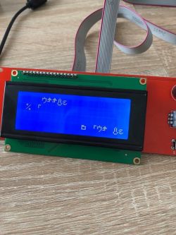

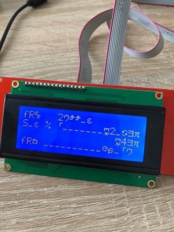

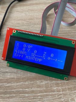

    Speed up NEMA 17 Motors (0.51 Nm) & Reduce Squeaking with Arduino, A4988 Driver & RAMPS Stepstick .
    I noticed that by adjusting the current on the stepsticks, my LCD display stopped working. Earlier - at the beginning it fired nicely
    in a moment:
    Now no ants are showing up, it's okay.

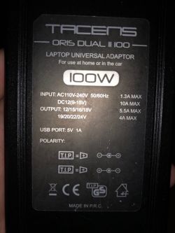

    Hi I bought a NEMA 17HS4401 (1.5A) motor + A4988 stepstik. I used a 19V 2.37A laptop power supply and a 100 microF capacitor.
    Reading the different forums, the stepstika setting should look either according to the pattern as in the post above, i.e. (in my case):
    Vref = 1.5A * 8 * 0.1 = 1.2V
    or according to another theory this stepstick has Rcs = 0.050 ? or newer = 0.068 ? so it should be:
    Vref = 1.5A * 8 * 0.068 = 0.816 V
    Not sure, I set this lower value. The engine was running but the stepstick was buzzing strangely. After some time I saw sparks next to VMOT, GND pins. I checked the connections several times and everything is correct.
    After disconnecting all cables from the stepsitka and connecting only the power supply, there is probably a short circuit because the diode at the connector from the power supply flashes. Did the stepstik burn? How so what did I do wrong?

    Leszek-s
    Vref voltage now does not matter too much, but it is better to set in the middle trimmers. Connect the + 5 volt contacts S1, S2 and the motor will run smoother. Check the correct connections as for the charge you have on arduino if you have Glbr 0.9 or 1.1 then connect the pins from arduino to A4988 step and dir
    The current you want to set on the trimerku he regulates the holding force of the motor between the steps I have already eaten three by shyld what I bought were mixed paths on the PCB good luck in connecting and testing

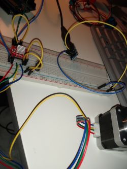

    Welcome back. Finally DRV8825 driver came to me. It seems to me that I connect badly the 17HS4401 motor pins to this driver.
    Four cables come out of the engine in turn: blue (PIN 1), yellow (PIN 3), green (PIN 4) and red (PIN 6).
    On the controller it is difficult to read the markings because they are cut off, and the board is slightly different from the one visible on the Internet under the same code - it's probably some original clone.
    Anyway, I connected in such a way (pins on the left as in the picture above, on the right on my board)
    B2 - green (it's B1 on my board)
    B1- red (on my board it's B2)
    A1- blue (on my board it is A2)
    A2 - yellow (on my board it's A1)
    connected by experiments. And it works, i.e. it turns right and left, no disturbing sounds are heard. But as in the program I give a pause (delay) at low voltage then the motor does not spin (ok) but you can hear a humming sound at that time.

    Humming results from the principle of the stepper motor, it is called holding torque which blocks the engine in a given position. If you want this not to be the case, you need to change the EN (enable) signal to the opposite, but then the motor axis can be turned, which will lead to "losing" steps, if the mechanism you control does not exert torque on the motor axis, you can turn off the EN during standstill.
    pozdr

    As I understand correctly, I should lead an additional signal from arduino, and when I want to 'turn off' the engine I should send a high state to the 'enable' pin - at the moment I do not use this pin?
    As I understand, I should lead an additional signal from arduino, and when I want to 'turn off' the engine I should send a high state to the pin 'enable' (I do not use this pin at the moment)?
    In addition, because I didn't mention it before, pin reset and sleep are connected together to 5V on arduino.
  • #30 18662002
    Slawek K.
    Level 35  
    Posts: 3020
    Help: 259
    Rate: 1301
    Yes, a high state on EN will turn off the engine, this logic is inverted.
