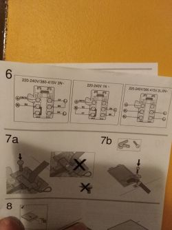

    Hello, I set up a new thread because I did not find a similar one, I apologize in advance if I litter the forum.
    I have an oven and an induction hob to connect, I would like these devices to be connected to a separate 3-phase circuit 5x2.5mm
    The induction cooker is Bosch PIF651FC1E, the oven will also be the same company, will anyone be familiar with the topic and look at whether the following diagram is correctly made? I will add that the connection will be made by an electrician with permissions, but despite this I would like to know what and how not to let an electrician put on some sort of cleaning.
    Bosch PIF651FC1E Induction Hob & Oven Connection: 3-Phase Circuit 5x2.5mm, Wiring Diagram Bosch PIF651FC1E Induction Hob & Oven Connection: 3-Phase Circuit 5x2.5mm, Wiring Diagram Bosch PIF651FC1E Induction Hob & Oven Connection: 3-Phase Circuit 5x2.5mm, Wiring Diagram
    He does not need a colleague to know.
    A colleague is not an inspector from checking the qualifications of an electrician.
    The diagram is a colleague's work.
    The schema is incorrect - not compliant with the standards.

    I do not want to check the electrician only to ask if the given scheme I made (because I did not write anywhere that an electrician did it) is correct. If a colleague claims he is not, which connection is wrongly done?

    Gray wire for induction in your image is unnecessary and figure 3N seems to be wrong because there is no 3L there is a 2N system with a mirrored L1.
    Generally, the oven and induction should be on separate circuits.
    Connections are correct - but only on paper.
    Theoretically "Lines" in the diagram go wherever you need.
    But .... It can not bear the load.
    (I ignore non-compliance with standards)
    A colleague needs to earn an extra perimeter to the oven.
    Then it will be ok
    Provided that a colleague does not call back connection techniques.
    Because I do not believe in this "electrician".

    If I make an additional circuit for the oven, then the phase from circuit 3f will be left unused, I will add that the circuit breaker is B20 A 3-phase.
    I'm just wondering if this gray GY wire bridged with the brown BN wire is not from the induction hob display? how do you guys think?
    The manual does not mention this.

    Do not combine.
    Do you have two receivers?
    You have, so you should power them with separate circuits and not worry about the unused phase.
    In what you propose to damage one receiver will also immobilize the efficient receiver.

    Gentlemen, write to yourself not to bother with the third phase, from what I know every phase must be loaded uniformly, the induction is 7.4 KW and the oven 3.6 KW, if I understand correctly for each of these two phases, the induction will be 3 , 7 KW and for one 3.6 KW. The 2.5mm cable load capacity in tubes or closed trays on the wall, in the wall or in the floor is 19A, i.e. I still have a spare. If I'm wrong, correct me

    It is this third unused phase that is supposed to feed the oven. But this oven should be fed with a new, separate circuit

    You misunderstand, because you do it so that it is more convenient for you.
    I wrote about a separate circuit dedicated to the oven.
    A three-pole circuit breaker in the oven circuit can be left. The fact that one phase will not be used is not a reason for its conversion into a two-zone camera.
