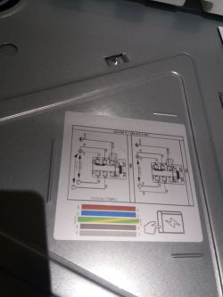

    I want to connect a Bosch induction hob to a 3-phase network. I connected the wires in the board according to the diagram on the bottom of the board (visible in the attached photo).
    The power supply conductor has five cores, namely: 1 green-yellow PE conductor, 1 blue neutral conductor and 3 phase L conductors - black, brown and gray.
    The board has 5 cores of the same color, 2 phase (black and brown), 2 neutral (blue and gray) and PE. (The board veins visible in the photo are placed with the ankle).
    Two questions:
    1. Is the cube too poor and shouldn't I replace it with a more stable one?
    2. Should the wires be connected as follows: PE core of the board with PE core from the power supply, black core of the board with black core of power supply, brown core of the board with brown core of power supply, gray core from the power supply as the 3rd phase (for the board, the third phase is no longer needed) remains unconnected only a self-weighed, blue power wire with two blue and gray board wires?

    It also adds photos to the preview of how I connected the wires in the board.

    1. No.
    2. Good reasoning, although I don't get it:
    martamarta_2008 wrote:
    remains unconnected only self-weighed
    as above: black power supply from black plate, brown power supply from brown plate, earth power supply from earth plate, blue power supply from blue and gray plate (need to be bridged) and guitar playing. Generally, connect as below in the red circle

    If you have at least two phases connected to the power supply, then as you write.
    Ended with a wago connector and not connected anywhere.

    From what you have given - photo stickers on the disc, 1 is not used for you.
    This picture 6, first from the left, also from your manual?
    The manual sometimes has too many variants ...
    Are you talking about the first clamp?
    #22 17769465
    artaa
    Posts: 15090
    Help: 1820
    Rate: 1701
    Yes, terminal 1 on the right "phase" side.

    Why inactive? If I put a gray wire under this terminal (as suggested in the diagram of another model with a three-phase power supply), it would be active :)
    Then I would connect the gray and brown wires from the board to one phase conductor of the power supply. I am just wondering why my board model didn't foresee this for users with three phases. Connecting Bosch PUE611BB2E Induction Hob to 3-Phase Network: Wiring, Color Codes & Safety

    It is better not to combine with this clamp, we do not know what it is connected to inside, maybe for nothing (you would have to unscrew the board :-P to find out).
    Now let's talk about the above quote, if the gray from the board was to be phase, then to relieve one phase in the home installation, it would have to be connected to the gray one from the power supply, and not to the brown one, because this one already has its counterpart on the board. I suspect that the board only needs 2 power phases, because its connection power does not exceed 5kW, but only 4.6kW. According to common sense, if the cable is 2.5mm2, you should pass up to 2-2.5kW through it, although at 2kW it will already heat up. Hence the power supply in two phases. Of course, the manufacturer could envisage the power supply of three for a lower load on the wires, but why. Apart from that, flats in blocks of flats / tenement houses are powered by two phases from WLZ (although usually one), in houses they are sometimes three phases. Maybe the manufacturer provided just such a power supply for the disc.

    Gray to the phase? good. There is a factory bridge between gray and blue. If there is a set between gray and L2 or L1 intended for 230V power supply, good luck with 415V there. What do you think why the manufacturer did not provide for a 3-phase power supply?

    Gray to brown (phase) is the manufacturer's diagram as you can see in the photo in my 15th post, not my invention. You're not the first to be surprised.

    Well, producers don't always know what they're doing. You see that the gray one in the photos, not from your model, is derived from a different clamp?
