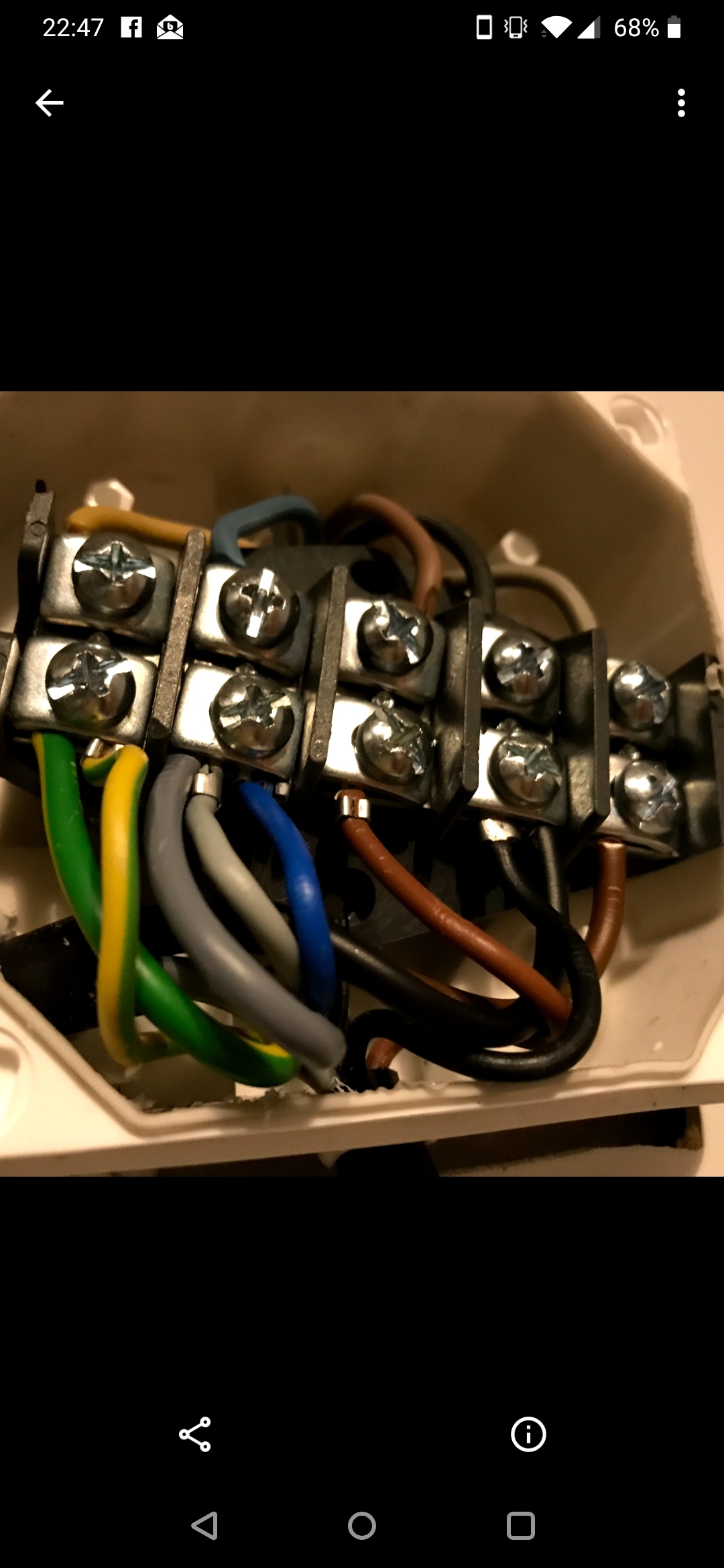

    Hello, I am sorry to reheat the chop, but I would like you to confirm me in doing it well or discouraging me from smoking my record. In the apartment, cables come out of the can like the first photo in 5 colors. I want to connect my motherboard in two phases, i.e. where in the second picture, the first diagram is L1 and L2.
    Bosch PIE631FB1E Board Connection for 3-phase Installation: Wire Role & Fuse Replacement Bosch PIE631FB1E Board Connection for 3-phase Installation: Wire Role & Fuse Replacement
    Is my reasoning ok?
    "junction box on the wall" - "connecting cube" - "plate socket no."
    "yellow-green" - "yellow-green" - "GN / YE No. 6"
    "blue" - "blue" - "BU No. 5"
    "brown" - "brown" - "BN nr 2"
    "gray" - "gray" - "GY nr 4"
    black "-" black "-" BK No. 3 "
  • #8 17762162
    ta_tar
    Posts: 6491
    Help: 699
    Rate: 2052
    Not knowing what is on each color (brown, gray, black) or how many phases we have, it's hard to tell here. I hope blue is neutral and yellow-green is protective.
  • #9 17762190
    Robert2207
    Posts: 34
    The apartment is from a developer, the rules are rather preserved. How can you verify this?

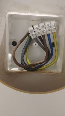

  • #10 17762217
    witexus
    Posts: 27
    It looks like this to me
  • #11 17762263
    ta_tar
    Posts: 6491
    Help: 699
    Rate: 2052
    Maybe you can show us a board with protections, maybe you can see your power supply from it. Maybe there will be a description on the security. Take sharp photos and post them here.
