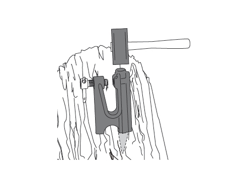

    wojtek2004 wrote:
    My opinion about people who shoot without removing the chain is bad. You can crush the guide bar with a vice.
    With proper attachment there is no option to damage the guide. There are even vices for "field" chain sharpening during work.
    Using a Chainsaw Gauge: STIHL File & Ruler for Oregon Chain, RYOBI RAC221 Sharpening & Angles Using a Chainsaw Gauge: STIHL File & Ruler for Oregon Chain, RYOBI RAC221 Sharpening & Angles Using a Chainsaw Gauge: STIHL File & Ruler for Oregon Chain, RYOBI RAC221 Sharpening & Angles Using a Chainsaw Gauge: STIHL File & Ruler for Oregon Chain, RYOBI RAC221 Sharpening & Angles
    You hammer into the stump, attach the saw by the guide bar and easily sharpen the chain.
    Youtube >>>> link . link . link . link .

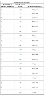

    The chain must match the size / pitch of the chain saw, i.e. the pitch of the chain (the size of the star at the end of the guide bar and drive rack is associated with it) and the width of the guide groove.
    Size tables:
    http://polskidrwal.pl/artykuly/jak-prawidlowo-zamowic-i-dopasowac-lancuch-do-swojej-pilarki/
