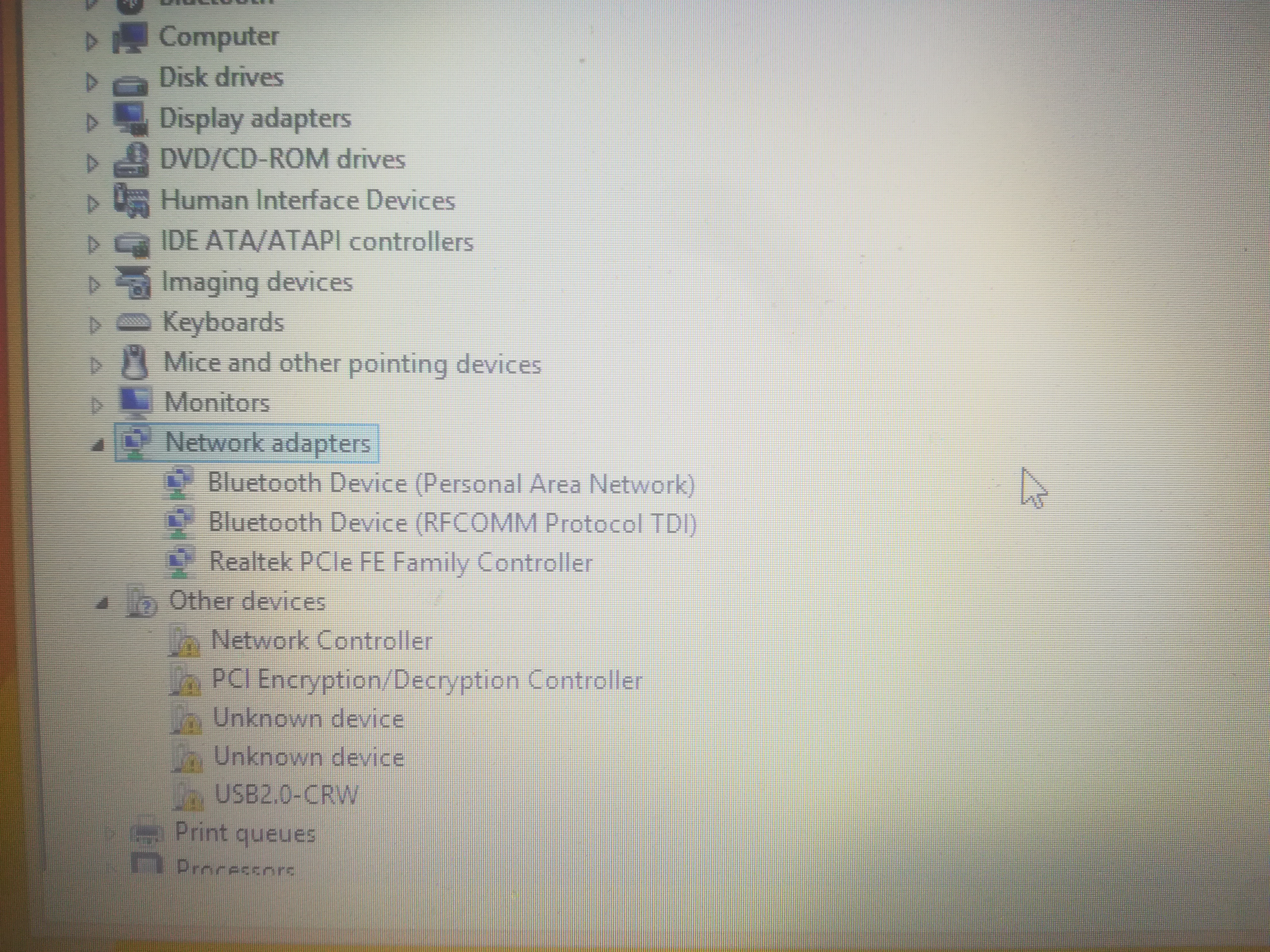

    What did I ask for? Where's the SS from the device manager? How can anyone help you if you do not provide basic information?
  • #7 16909963
    Patkawariatka18
    Posts: 6
    Please, that's it?
    • Dell Inspiron 15 7560: Can't Find/See WiFi Networks after Reset - No Connections Available IMG_20171223_212730.jpg (4.93 MB) You must be logged in to download this attachment.

    There is clearly a lack of drivers for the Wifi card as well as a few others. Enter the device ID "Network Controller" and the system version.

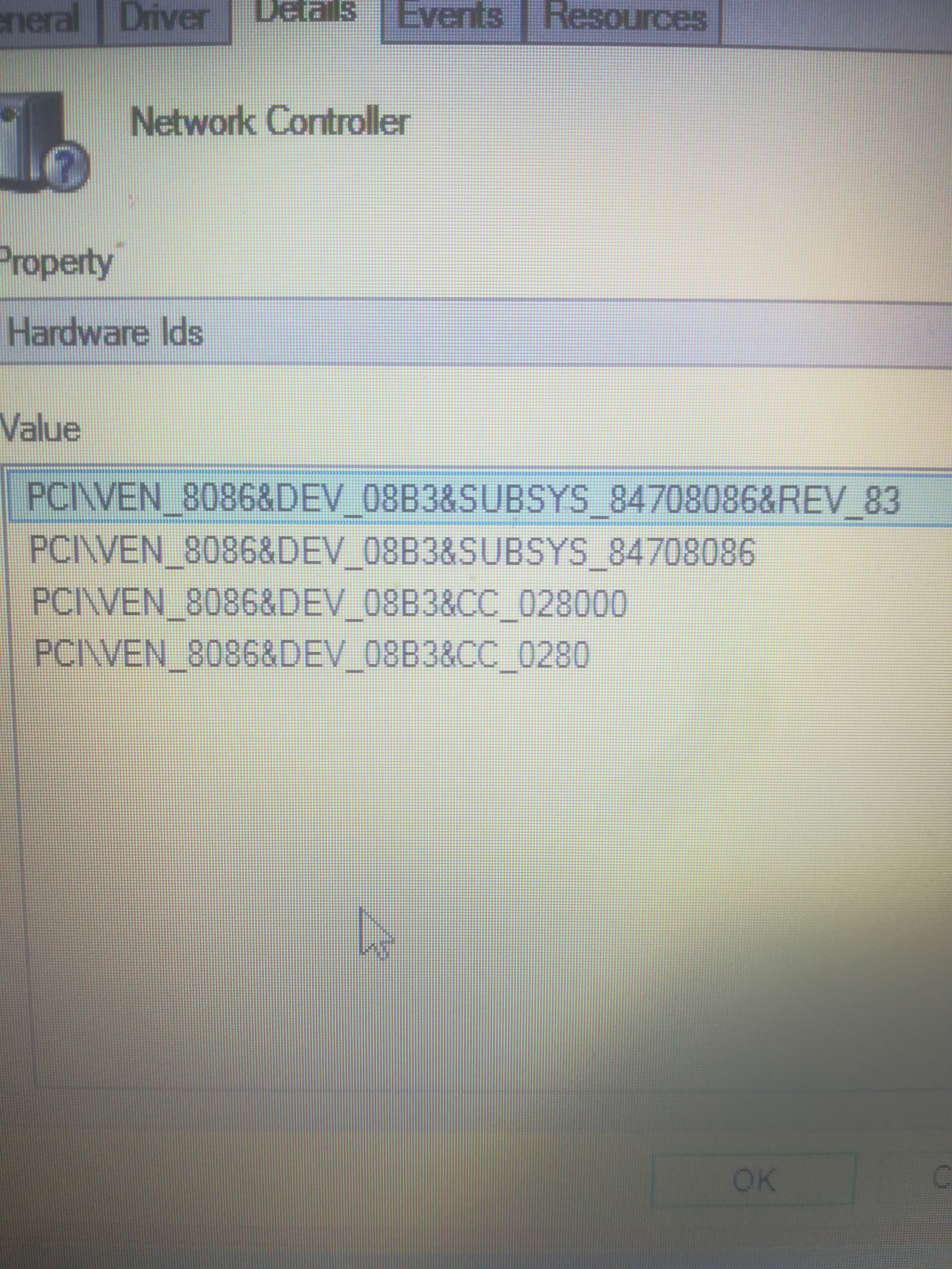

    So, as far as I know, you probably mean Windows 8 Version 6.3, but the device id is sorry, where should I find? haha
  • #11 16910075
    Patkawariatka18
    Posts: 6
    miecho18 wrote:
    Patkawariatka18 wrote:
    but the device id is sorry so where should i find?
    https://www.elektroda.pl/rtvforum/topic1228905.html
    32 or 64 bit?
    64

    From what I see on the manufacturer's website there is only support for Windows 10 x64. As for the Inspiron 15 7560 model. If you provide the ID, we'll see what is the Intel or Qualcomm Wifi card there.

    The card is Intel Dual Band Wireless AC 3160.
    Drivers to download:
    Windows 8 x64: https://downloadmirror.intel.com/24863/eng/Wireless_17.16.0_De64.exe
    Windows 8.1 x64: https://downloadmirror.intel.com/27310/eng/WiFi_20.10.2_PROSet64_Win8.1.exe
    The rest of the devices should also be installed (generally, everything that appears as Other Devices).

    Thanks so much for your help! I knew from the beginning that I had no drivers, but none of them worked, apparently I am downloading the wrong ones, thanks again !!!
