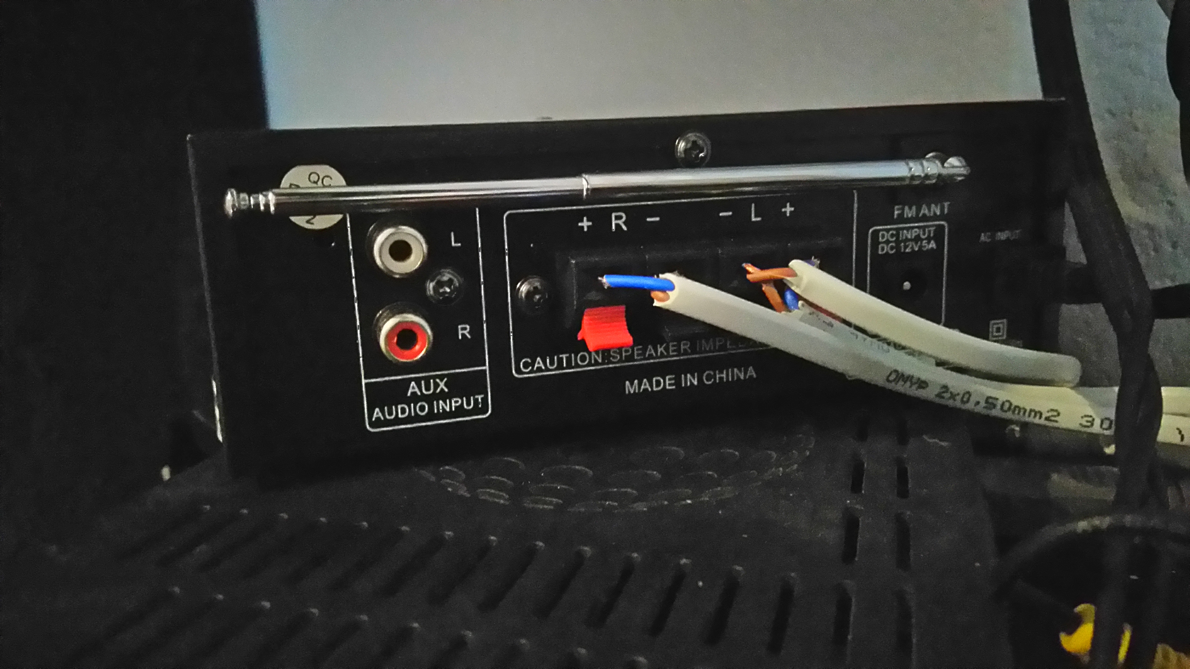

    I have a TV LG 43lh50, a Polsat digital decoder and an amplifier like the one below. The decoder is connected to the TV and I would like to connect the amplifier to the TV so that the voice from the decoder is on the speakers connected to the amplifier. There are two chinchas coming from the amplifier and when I connected the other two to the TV, the voice is still on the TV speakers and not on the speakers from the amplifier. I tried to do something in the settings but it didn't help. I bought a euro converter but I also don't know what's going on ... Maybe I'm doing something wrong ... (the amplifier and speakers are working, because after plugging in the phone or USB everything works as it should). Below I put pictures of everything I have.
    Please, somebody help me and explain how to connect it, set it up and maybe I'm missing something ...
    Many thanks in advance ?

    I don't know what it is supposed to look like, but I assume that you want to pass the sound from the decoder to the amplifier. You need a euro -> chinch cable, which will have 2 R and L outputs, which need to be plugged into the amplifier's phono inputs (last photo) audio input.

    Plug yourself this scart / RCA to HD 3000 adapter and the RCA cable to the amplifier.
    As long as it is an "outgoing" version of the adapter, or it has an in / out switch that should be set to out.
    Fix, has a switch, was not seen on the thumbnail.
    You only connect red and white, the rest do not interest you, to the aux in the amplifier and of course you have to select this source in the amplifier.

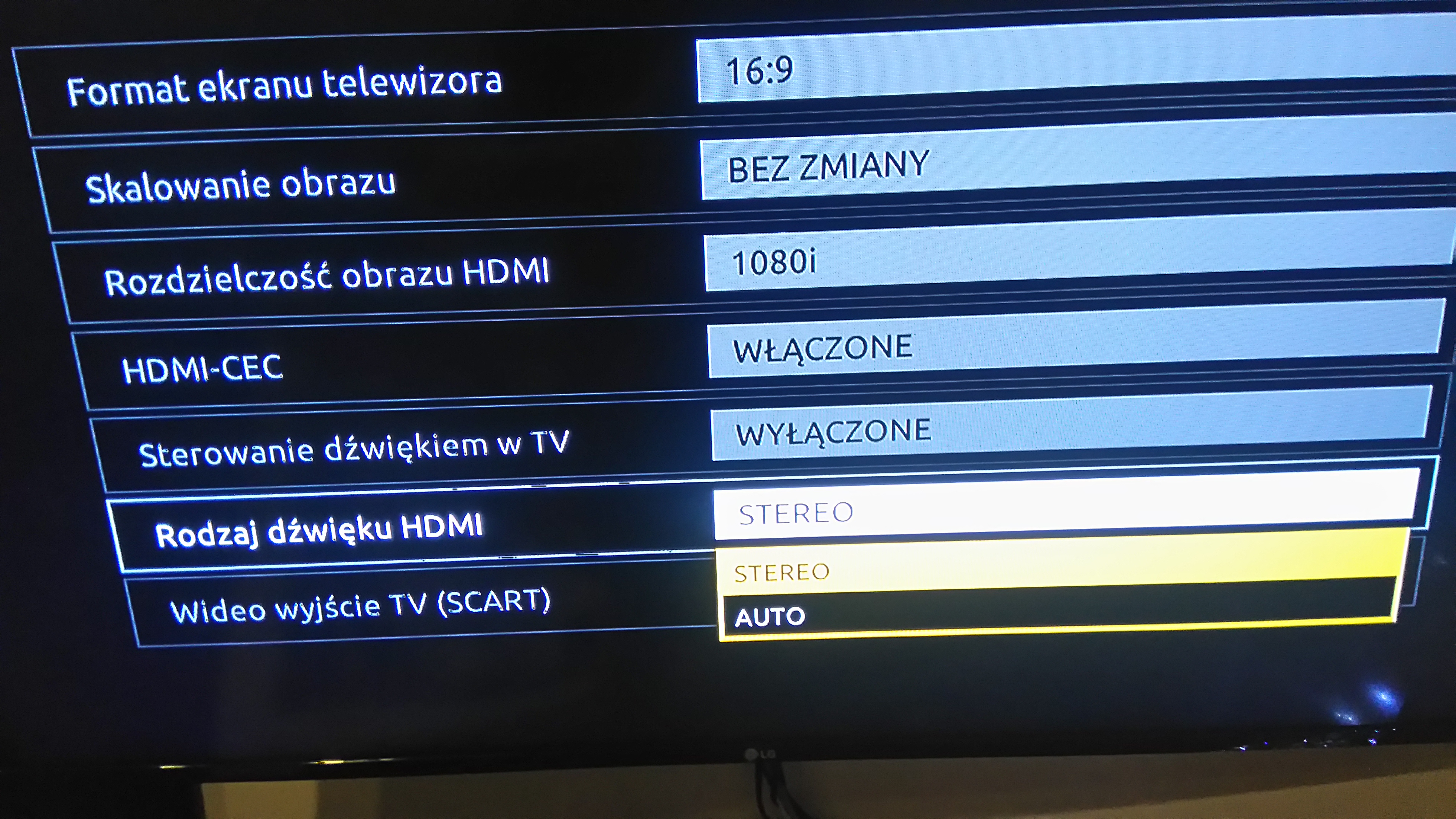

    Lukarskiii
    Posts: 7
    mihal2002 wrote:
    mihal2002 wrote:
    Did you switch to AUX in the amplifier?
    Did you check the decoder settings?
    Yes, I tried in the settings. I sent a photo of the settings on the decoder what I have. And on the amplifier I only have two fm and LINE functions. But when I have a line and connect a cinch and jack to the amplifier and telephone, everything works so I don't know why the TV does not work.

    bestboy21
    Level 40  
    Posts: 7129
    Help: 566
    Rate: 782
    Set the video output (scart) to STEREO.
    Check the position of the switch in the euro adapter.

    Lukarskiii
    Posts: 7
    VIDEO OUT SCART can only be set to RGB or CVBS. I was checking the adapter.
