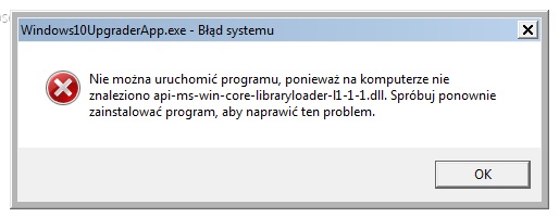

    I am trying to take advantage of the last free occasion (until the end of this year) WIN7 upgrade to WIN10.
    After running Windows10UpgradeAssisatnt, the application downloads from the network what it needs, checks my hardware - everything is OK, and with a specific attempt to update the following message appears:
    The program can not be started because the computer was not found api-ms-win-core-libraryloader-l1-1-1.dll Try reinstalling the program to fix the problem.
    I will add that I have an HP laptop, WIN7 32 bit, normal legal version, registered, everything OK.
    After a few unsuccessful attempts, I reinstalled the WIN7 system on this laptop, I downloaded all the updates that were possible and when trying to upgrade to WIN10 there is the same problem.
    What should I do to solve this problem?

    @Kolobos it looks like the transfer (removal?) of wimgapi.dll fixes the problem ...

    The method with the substitution of wimgapi.dll immediately solved my problem.
    WIN7 has been able to get to WIN10 without any problems.
    So the biggest thank you for the idea with this file replacement.
    I will stay on the 32 bit system, I do not need to change to a 64 bit system, everything I need works on this system OK.
    I will also add to those interested, I checked that after this upgrade, ProduKey detects the same activation code in WIN10, which was previously in WIN7.
