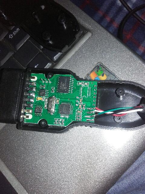

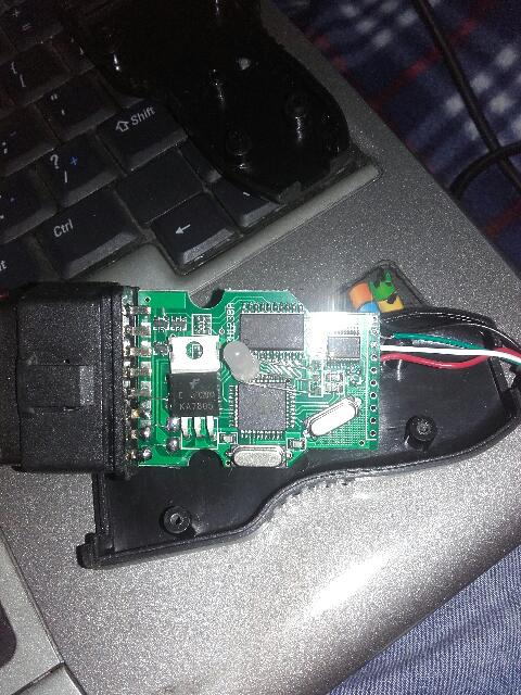

    Have any of you tried to update to 1.94 on Atmega 162 via the cable
    Added after 6 [minutes]:
    I have such a face with version 1.84 on atme 162.
    MProg 3.0 reads eeprom but I can not program it with my batch to version 1.94 or 1.96
    • VCDS Update 17.8: Upgrade HW 1.84 to 1.94 on Atmega162 - MProg 3.0 EEPROM Programming Issues 20171224_121108.jpeg (77.52 KB) You must be logged in to download this attachment.
    • VCDS Update 17.8: Upgrade HW 1.84 to 1.94 on Atmega162 - MProg 3.0 EEPROM Programming Issues 20171224_121055.jpeg (82.18 KB) You must be logged in to download this attachment.

    #3 16912222
    bodziojano
    Posts: 38
    Hello, what do you mean, you program the Atmege cable in the socket or in this version you have goldpins, you make a simple programmer from the LPT cable, then you connect, for example, the PonyProg batch program and program by powering the Atmega + 5V
    Added after 7 [minutes]:
    https://www.elektroda.pl/rtvforum/topic2659311.html
    here you have a link how to program it there is a lot of it in the network from the back you will not program it from the FTDI side

    #7 16969356
    bodziojano
    Posts: 38
    Because you have this cable for 232BL and it is not supported by usb, apparently only cables for 232RL Your flash cable is loaded properly and the eeprom is not anymore, so only the programmer.
