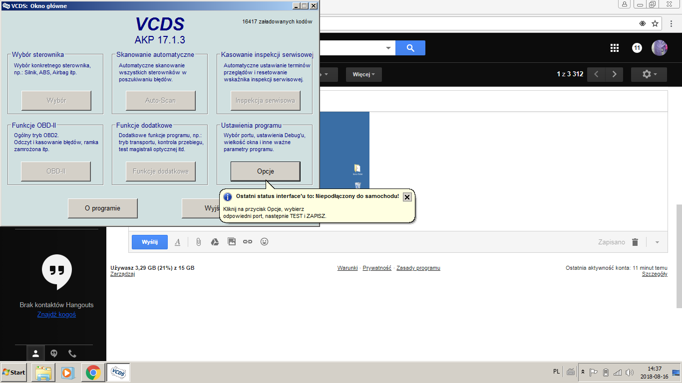

    I have a VAG012 cable and it was working normally for me, but a few days it stopped.
    The computer was connected to the internet all the time and it's possible that it started to update and got off the cable software, or I don't know.
    Symptoms:
    Cable connected to the car, the green light and red light comes on, after a second the red light goes off, VCDS on and after pressing TEST everything is OK, only at the end there is a message: Not connected to the car.
    Would anyone advise what exactly I need to do to get everything working again?

    You have not installed anything else for the same USB?
  • #3 17387844
    kotaphone
    Posts: 44
    Rate: 7
    No. It stopped working during diagnostics.

    I'm sorry I was silent for so long.
    Unfortunately, I did not manage to solve this problem, because the topic turned out to be "too heavy" for me and the cable is lying and waiting for better times.
    I wrote to the company from which I bought the cable and got the answer that by trying to update the software, the cable was "damaged" and it should be reprogrammed and they can do it for a fee of PLN 50, so I gave up, because it will come out with shipments around PLN 80.
    If I ever find a way to program this cable, I will try to share the solution. But for now, I don't know where to start.

  • #11 17648162
    strucel
    Level 36  
    Posts: 3088
    Help: 271
    Rate: 623
    If you are counting on getting fix_kabel.exe, you had to write to Saint Nicholas, today is a magical day ...
    The cable to repair should be dismantled and see what processor it is built on - these better / more expensive versions have golpins on the board to which you connect the interface and program the processor
    http://www.eobdtool.com/blog/2017/08/how-to-repair-vcds-interface-for-any-language/
