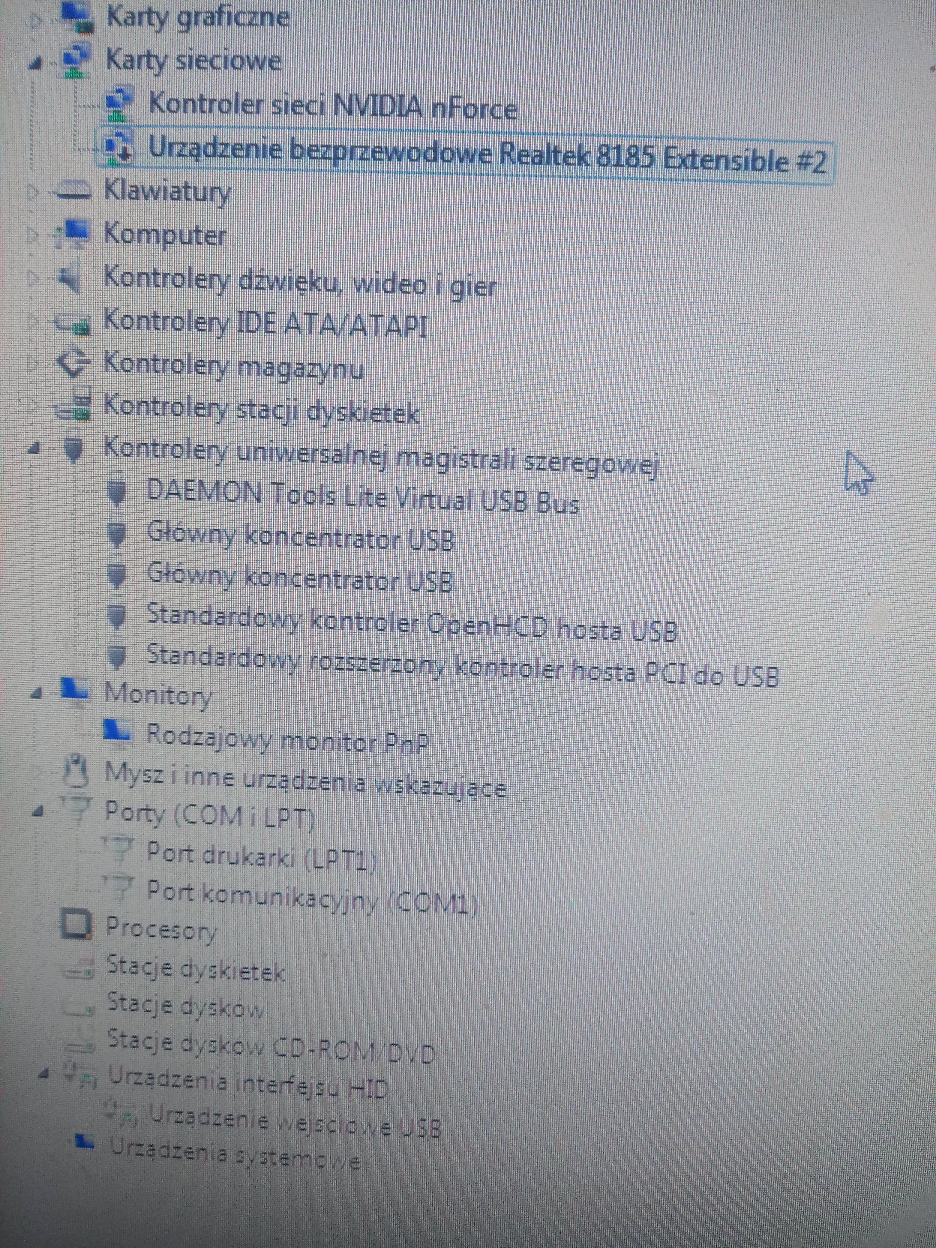

    Hello, I am connecting to the computer adapter (this is what I call it?) Xg-760n but the computer can not see it, the same in the case of smartphone and tethering option (in fact, the computer does not notice that I connect the phone at all). Yesterday, everything was OK.
    I admit that I am green in these themes and I do not know if I need to install any drivers? Maybe it's a virus (although I recently downloaded nothing)
    I have Windows 7

    System device manager also does not detect anything?

    Show the device manager after connecting these devices.
  • #6 16910961
    Kalahandziu
    The diode is on
    The photo flies in the attachment
    (If it was not a pirate because I use a daemon, I had a game bought on GOG, and it was more convenient to download it from the torrent: p, but it has been removed so long ago so it's not)

    You have connected the USB flash drive as suggested by your friend @jimasek ?

    #8 16910984
    Kalahandziu
    Unfortunately, I do not have a pendrive
    I will add that the USB mouse works and the phone charges after connecting.
    Edit
    Now an error appeared to me
    "Instruction from 0z75d6d33d refers to the memory at 0.34313136. Memory can not be read."
    I did nothing, it came out of itself. I do not know if this has anything to do with the problem.
    Added after 9 [hours] 23 [minutes]:
    I made a format
    Still nothing
    Explains someone why the mouse works and how to connect to the same USB input this adapter or phone is a computer does not respond?
    No dedicated drivers or software to operate the given hardware (there may be a driver).
    Detecting and installing hardware you have active and Windows alone has to do it by looking for drivers?
  • #10 16915050
    mk89rak
    Posts: 34
    Possibly here a link to the driver that I used to install about 2 months before http://www.orange.pl/ocp-http/PL/Binary2/1979824/4054680766.zip
    If it does not go, download UVCView and connect - check if it shows something.
