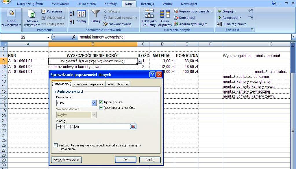

    sanatarium wrote:
    Can you format the text in the drop-down list?
    Sorry, I don't understand the question :cry:
    Excel: Create Simple Cost Estimate for Video Monitoring - Dropdown, Sheets & Material Pricesformat.JPG (144.16 kB)You must be logged in to download this attachment.
    As you can see in the screenshot, you can always format the cell into which you enter data from the drop-down list :ok:

    I asked a little wrong. I will introduce the topic. Based on the "protrys" file on the right is a list of all the works that I divided into groups. Group names are listed in the drop-down list and separated by gaps, but I would like to see them in the format that I format.
  • #8 16963865
    Prot
    Posts: 2580
    Help: 574
    Rate: 297
    This is just not clear :!: if you want to "format" it - literally, put some color and typeface or text alignment in the drop-down list - the answer is - NO!
    But I feel through my skin that you mean something else? Look carefully at my previous dump - you can see what range ($ G $ 11: $ G $ 20) this drop down list has.
    You can drag down the same drop-down list, you can change the range for the next cell, you can specify the range with a neat formula, e.g. by displaying only the first letter from any action list :D e.t.c
