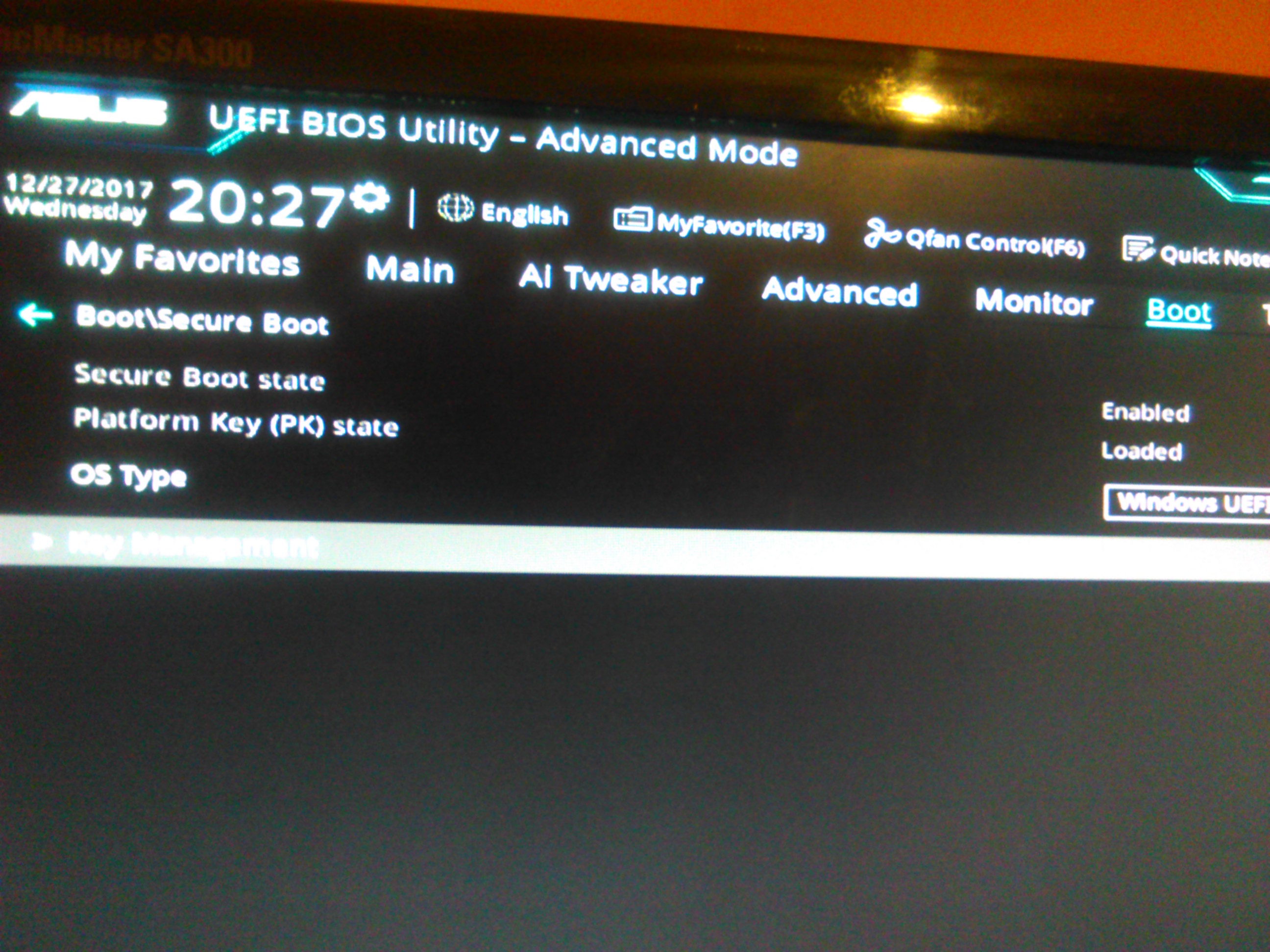

    Hi . I have a problem. I installed windows 10 pro yesterday. Everything works fine but when I download something and want to run it, the message "Your organization has used the Windows defender application control function to block this application" pops up. I tried several ways to disable this program but it does nothing .. Please help :) thank you in advance.

  • #5 16917437
    GaBo0712
    I got into the bios but I can't switch it to "Disaabled" Windows 10 Pro: Defender Blocks All Downloads - How to Disable Application Control?

    #8 16917533
    Kolobos
    IT specialist
    Posts: 85178
    Help: 17171
    Rate: 10455
    Otherwise you will not disable Secure Boot, and as you can see the problem may cause this option.
    You can also try to reinstall the system, but it does not always help.
  • #9 16917538
    GaBo0712
    Well thank you. I did the reinstallation and gives nothing. I'm going to do it and let you know today whether it worked :D
    Added after 21 [minutes]:
    I was able to turn it off and what should I do next? :)
    Added after 28 [minutes]:
    It worked ... surgery in the bios helped. Thank you for your help . I consider the topic closed :D
