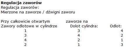

Helpful post #2 16915187 26 Dec 2017 20:23 Heinzek Heinzek Network and Internet specialist Posts: 3732 Help: 554 Rate: 494 » | Helpful post? (+5) Helpful post Post #2 16915187 26 Dec 2017 20:23 https://obrazki.elektroda.pl/2736777300_1514316149.png
#3 16915277 26 Dec 2017 21:06 matriks97 matriks97 Level 2 Posts: 4 Rate: 4 » | Topic author Helpful post? (+1) Post #3 16915277 26 Dec 2017 21:06 thanks buddy Heinzek and what valves should have looseness and how to set them are some signs or something to set them.
Helpful post #4 16915322 26 Dec 2017 21:23 Heinzek Heinzek Network and Internet specialist Posts: 3732 Help: 554 Rate: 494 » | Helpful post? (+2) Helpful post Post #4 16915322 26 Dec 2017 21:23 The one who explained it had a nice "departure" but treat the intake as suction and departure as exhaust. You adjust when the exhaust is open according to the table, e.g. the first open exhaust is the 3 suction and 4 exhaust.
#5 16915661 26 Dec 2017 23:51 matriks97 matriks97 Level 2 Posts: 4 Rate: 4 » | Topic author Helpful post? (0) Post #5 16915661 26 Dec 2017 23:51 thanks, buddy, you helped me a lot
