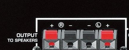

    Hello, I bought a Yamaha NS-SW200 active subwoofer today. Everything would be fine if I didn't have a problem with connecting it. In my old subwoofer I connected with an aux audio cable

    Not good, after connecting the sound source to the subwoofer, you only hear the bass. You blew me away with this: V
    After all, this is the task of a subwoofer, to reproduce lower frequencies. Not only do you need an AV receiver as well as an AV receiver and speaker system.

    I have a loudspeaker set .. When I connect the speakers, I can not hear anything through them, only the bass from the subwoofer. So only the receiver is needed and everything should play?

    Where are you connecting these speakers?

    I am explaining this, in the subwoofer you have a high-level input, if you have a stereo amplifier, you can connect the speaker system through the subwoofer - it will "steal" some signal from the speakers and amplify it. There is no amplifier for the front speakers.
    It looks like this graphic from the internet:
    Connecting Yamaha NS-SW200 Active Subwoofer: Do I Need an AV Receiver for Proper Audio?
    With an AV receiver with active subwoofer output you don't need to use the high level inputs at all.
