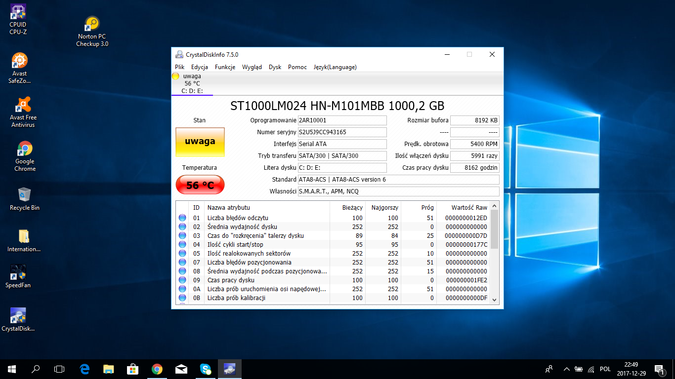

    Hello, I have a problem with the Lenovo G580 laptop, the laptop turns on a long time after turning on a terrible musule, the laptop has a nova button but even after pressing this button and after selecting the bios menu option, the laptop turns on and not the bios tal as if it was blocked. After turning on the laptop it is very slow it turns silent.
    After inserting another new disk, it only lights up the screen but nothing happens.
    Laptop specification:
    Windows 10
    Intel Celeron CPU B830 1.8 1.8 Ghz
    4 GB RAM memory
    X64 operating system

    Embed screen from CrystalDiskInfo.

  • #4 16923095
    Kasek21
    Posts: 45660
    Help: 4981
    Rate: 3547
    The whole window - it's enough to stretch it.

  • #10 16923198
    safbot1st
    Posts: 21951
    Help: 2719
    Rate: 1585
    hequu wrote:
    The problem is that you can't enter the bios
    And DEL?
    Can I enter the BIOS with the drive disconnected?
    You have damaged mechanics or the surface of the plate. This is evidenced by read and write errors (01) and (C8)
    You have Momentus Spinpoint.
    For this disk (01) it should be 0.
    The disk makes some disturbing noises? Can you hear him spinning plates?
