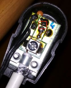

    I have no idea what's wrong. Mesh antenna, plug-in power supply, cable well machined, there is no right to be short-circuited and yet there is a problem. The power supply goes off by itself, i.e. the LED goes out, after a few hours or even a whole day it lights up and everything returns to normal. There is no rule, he acts as he wants. What could be the reason?

    Apparently the "hair" from the braid of the cable in the antenna plug or when connecting the amplifier in the antenna sometimes short with the middle vein. That's the whole reason. Well, possible but unlikely damage in the power supply. In total, detection is a matter for even a beginner.

    And sometimes there is no "here" cause, somehow this February looks suspicious in this plug, maybe sometimes they make a short circuit when they heat up.

    February beautiful, I don't know what you don't like about them? Same with this hair? It moves itself and it does itself short once and not once? This is most quickly something in the antenna amplifier - raid, tarnished or some C. See, replace the amplifier. Well, unless something with the power supply or power supply.

    You are right, I do not know enough, but exactly I meant this place (green arrow) do these two soldering places do not come together sometimes (from the photo it looks like this, or maybe it has to be? :cry: )
