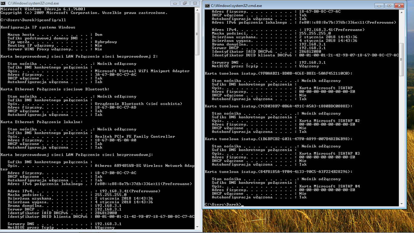

    Everything goes on wifi, nothing is connected to the router (when it comes to receivers) The service I have from our local company (radio) is an antenna on the roof, adapter, PoE / LAN power supply, router
    • No Internet Connection on TP-Link Archer C20 Router: WiFi Issues on Z3 Phone, Laptop & Tablet Bez tytułu 1.png (278.84 KB) You must be logged in to download this attachment.

    At the time you took this screenshot, you were using a wireless network adapter on your computer. What does this card connect to?
    - with some operator device outside the window?
    - with some operator device (router) in your apartment?
    - directly with the antenna mounted on the roof?
    You write that you have an antenna (rather CPE), power supply to it - so I expected the computer to be connected to this device via twisted-pair cable.
    Unless you have one operator router and you want to buy a second one for some reason (only here, the question is whether you want to replace it or connect yours for some reason).

    The laptop is connected via wifi to the tp link archer c20 router as I wrote above, radio internet on the roof antenna cable from it goes to the LAN adapter and from it to the router from which I have internet for the whole house I do not use the cable connection all the equipment connects to router using wifi

    I noticed that when the internet is available, the IP is 192.168.3.XX and when there is no internet the IP is 192.168.2.XX. What to do to assign an IP device in the range of 192.168.3.XX ??

    Has someone already set up this router to work on this network?
    - if so, go to the management of this router through the browser and show the settings for WAN
    - if not, then insert the LAN cable from the PoE adapter directly to the computer (by the way, make sure that you are not connected to WiFi at the same time) - is this the way the internet works? If so, then do ipconfig / all and pop it up.
