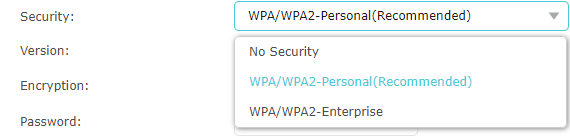

    Everything is already working stably, timeouts when pinging are rare, however one of the PCs connects to a PLAY router which is further away and has worse speeds, is there any way to set archer as a priority access point for this PC?
    Screenshot of network security settings with a dropdown menu. Screenshot of a dropdown menu for selecting Wi-Fi security options. .
    Is this OK, or should I choose WPA-2PSK/WPA3-SAE (AES)
  • Use WPA2 AES PSK and separate SSIDs

    xyzixyqr wrote:
    Is that OK, or choose WPA-2PSK/WPA3-SAE (AES)
    I don't think this C6 has WPA3 yet, so just set WPA2 AES PSK alone on both.
    xyzixyqr wrote:
    PC connects to PLAY's router which is further away and has worse speeds, is there any way to set archer as priority access point for this computer?
    It doesn't. There would have to be an AP and a card in the laptop with 802.11k,v,r. Only half-measure is different SSIDs, and then indeed in Windows you can set priorities or manually force SSIDs.

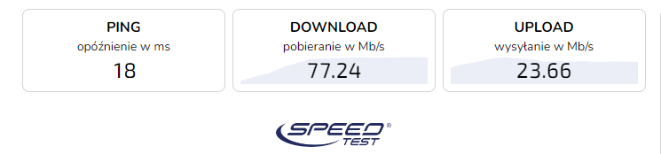

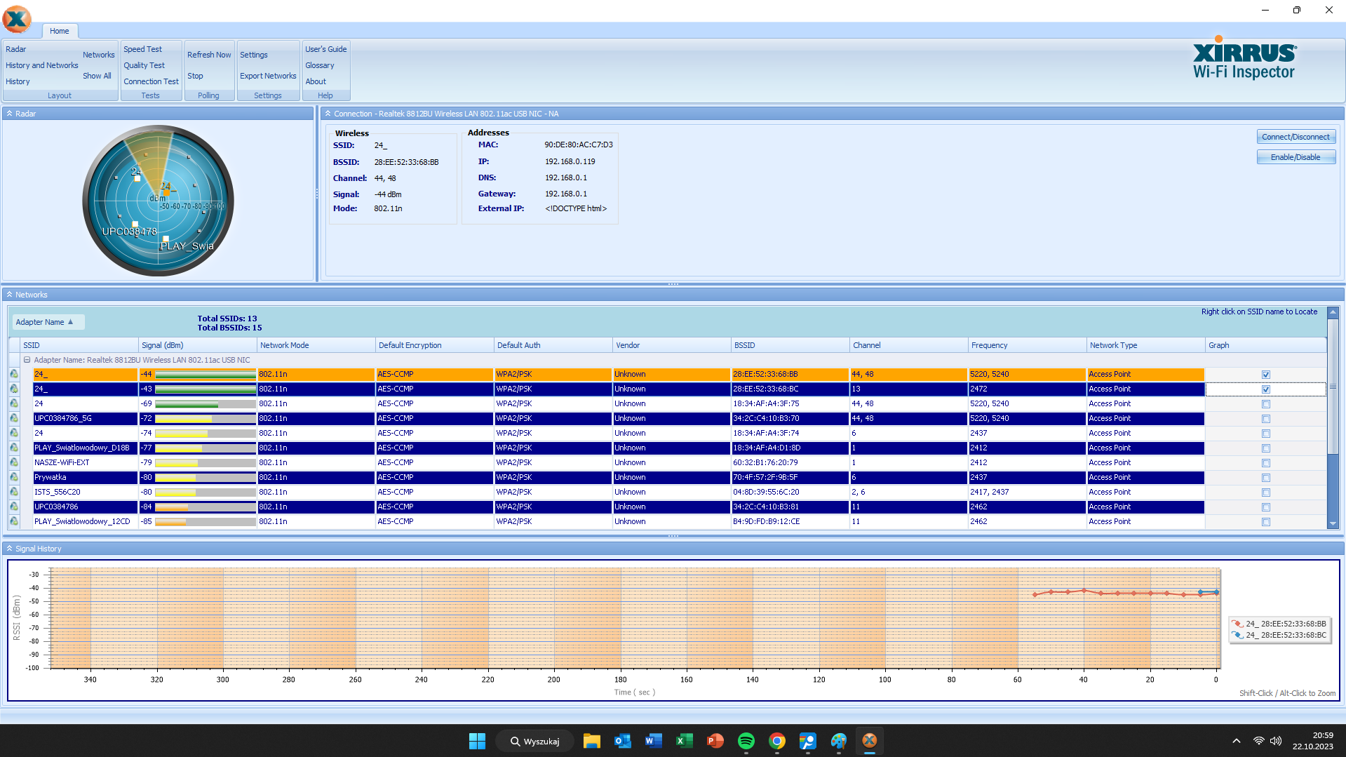

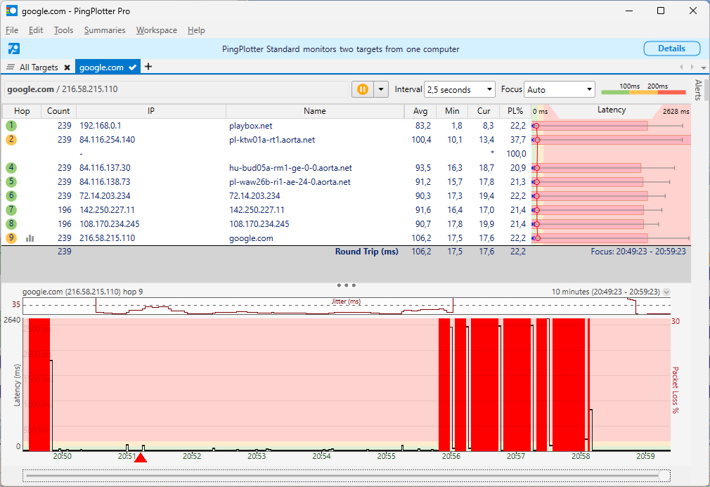

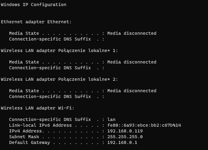

  • #15 20781144
    xyzixyqr
    Posts: 15
    I just took to testing and diagnostics when it was unstable Screenshot of Windows IP configuration showing disconnected Ethernet and two LAN connections, with active Wi-Fi connection.
    Internet speed test results showing a ping of 18 ms, download speed of 77.24 Mb/s, and upload speed of 23.66 Mb/s. Screenshot of Xirrus Wi-Fi Inspector showing a list of available wireless networks, their signals, and signal history. Screenshot from PingPlotter Pro showing network connection analysis to google.com with instability and high latency.
The discussion revolves around Wi-Fi instability issues experienced after switching from UPC to Play, specifically using a PLAY BOX NET HFC router and a TPLINK Archer C6 router. The user reports frequent disconnections and poor performance on Wi-Fi devices, despite having a stable wired connection. Various troubleshooting steps were attempted, including resetting routers, changing Wi-Fi channels, and configuring the Archer C6 in Access Point mode. Suggestions included using WiFi Analyzer for network scanning, setting different SSIDs for each router to facilitate testing, and ensuring identical security settings. Although some improvements were noted, the user continues to experience intermittent connectivity issues, particularly with the Play router. The conversation highlights the challenges of managing multiple routers in a shared living environment and the complexities of Wi-Fi performance in densely populated areas.
