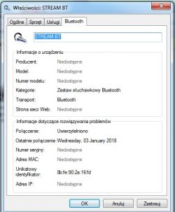

    I am also trying to connect it to no effect.
    The "Control" option is missing.
    Win 7 Unable to Detect Tracer Bluetooth Speaker: Solutions for Connection & WIDCOMM Issues
