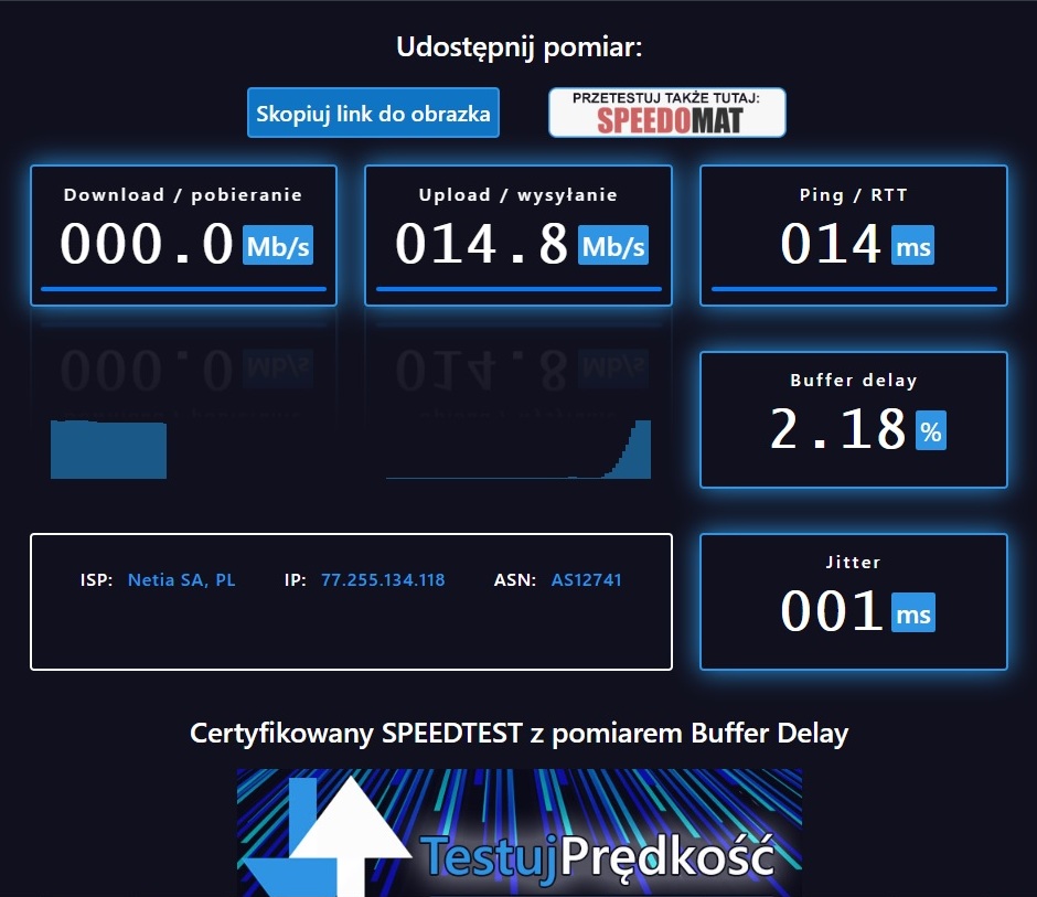

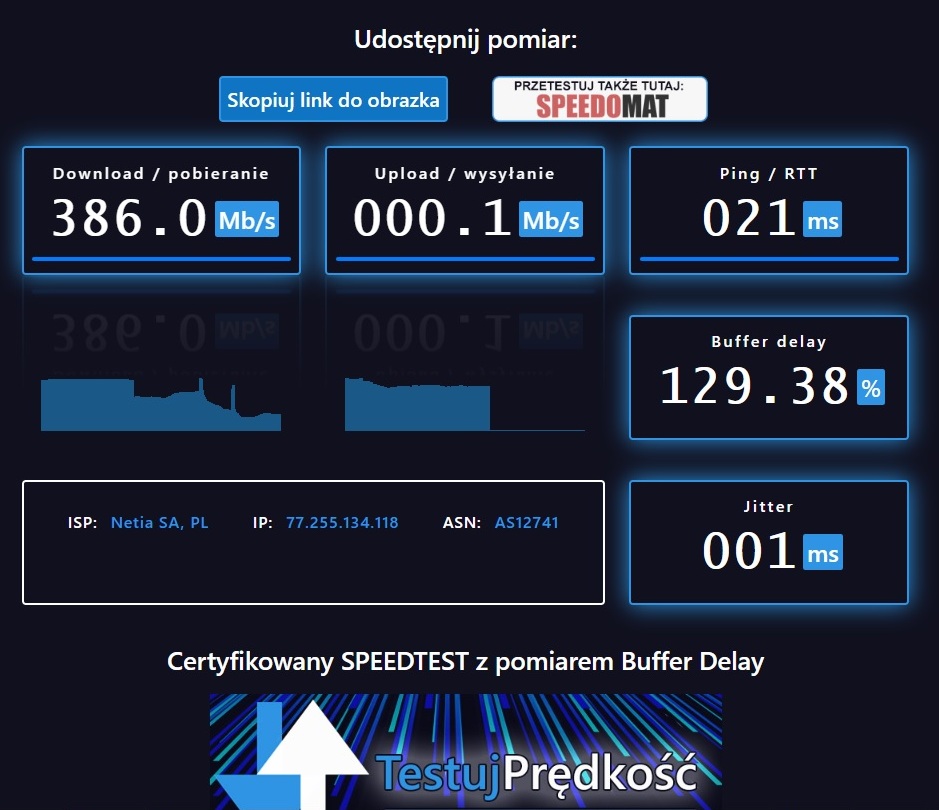

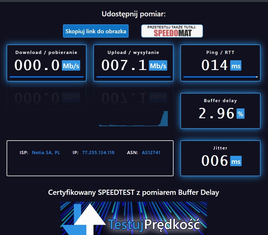

    I have had the Internet from Netia for several years, it is optical fiber to the house, Netia router (now replaced) Huawei OptiXstar HG8245X6-10. Bandwidth 1 Gbps. For over a month and a half, circuses with the operation of the Internet have begun. At random intervals, throughput drops dramatically, even to zero. Then after a while it jumps to the maximum level, 1180 MB/s. The technician, both on-site and remotely, determined that there was no interruption in the connections between the router and the control panel (equipment). There is no change in the diode signaling on the router (the same diodes flash the same). The problem manifests itself in specific lags, regardless of the type of connection: WiFi, cable via a switch, cable directly to the router.
    The measurements taken at https://testujpredkosc.pl/speedtest show a decrease or increase in speed in the graphs.
    I am uploading a PDF with the measurements and a few screenshots of these charts. Sometimes it even happens that the measurements do not start.
    The operator recommended that I perform a certified Pro Speed Test. I`m halfway through (1 day, 6 tests) and 4 were OK, but two were terrible: about 30 Mb/s and just over 1 Mb/s. And until then he did nothing.
    I hope you will be able to say something more after the test results. Or maybe you can even tell us where to look for the causes of these jumps?
    I will also add that these measurements were made in a working environment, with a browser and devices connected to the network. I need a working connection, not a laboratory connection to measure reference measurements. Resetting the router doesn`t change anything.

    I did not specify that it does not matter how the devices are connected to the router. I have the same problem on a computer or phone connected via WiFi, on a laptop connected directly to the router and on another connected via a switch.

    Then you submit a telecommunications complaint in writing to the operator - there is nothing more that neither you nor we can do.
    If there is a problem on any equipment, any device and any transmission medium, the operator must check everything.
