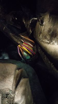

  • #7 17139560
    DEFROZ
    I had the same case yesterday. All voltages including signal were OK. There was a voltage problem when the controller attempted to start the engine. The voltage dropped and caused a communication error.
    The reason was a frayed cable in the bundle passing next to the right rear corner of the battery base. Vibrations and time have done their job. The remaining patina was conducting something, so the idle tensions were OK. Skoda Octavia II 2 - Front wipers not working, Washers approx.
