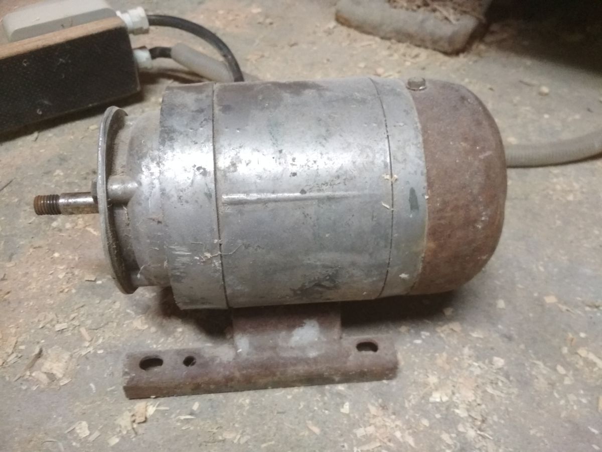

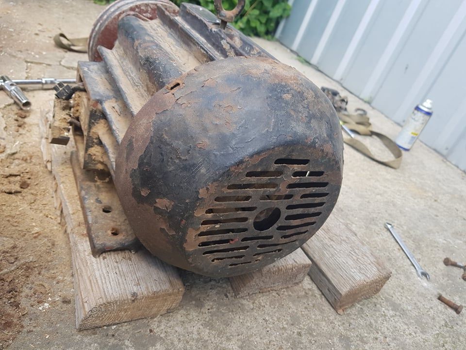

    Hello, I found an old engine in the attic. Unfortunately, without the nameplate, and here my question appears: Is it possible to check the engine power without this nameplate?
    greetings
  • #2 16940354
    sp3ots
    Posts: 3073
    Help: 524
    Rate: 674
    Show engine.
  • #3 16940410
    Krzysztof Reszka
    Posts: 10574
    Help: 609
    Rate: 1551
    Mixerios wrote:
    Hello, I found an old engine in the attic. Unfortunately, without the nameplate and here comes my question: Is it possible to check the engine power without this plate?
    It can be roughly stated if it is not an unusual motor, and three-phase or single-phase. Please give photos of the engine.

    Rezystor240
    Level 42  
    Posts: 9241
    Help: 689
    Rate: 1651
    Measure the diameter of the motor shaft.

    Check Engine Power Without Nameplate: Measuring Old Attic Engine's Power Capacity

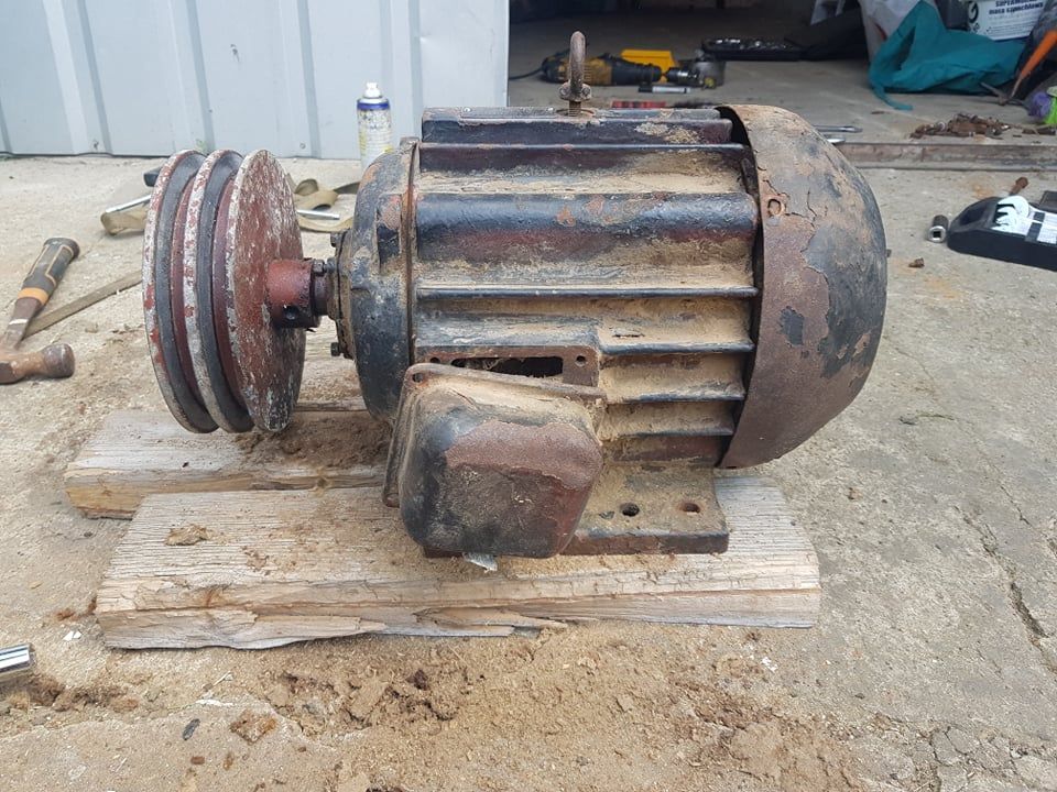

  • #11 17034056
    xdawidek05

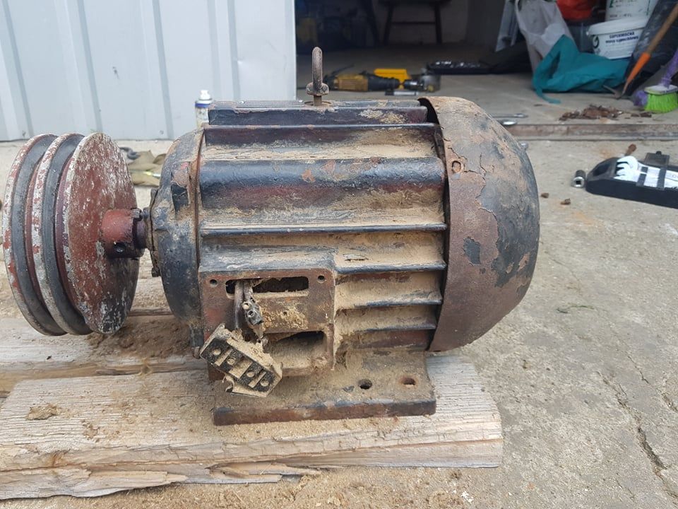

    Hello, I have a similar problem. I have a motor that is without a nameplate:
    Check Engine Power Without Nameplate: Measuring Old Attic Engine's Power Capacity Check Engine Power Without Nameplate: Measuring Old Attic Engine's Power Capacity Check Engine Power Without Nameplate: Measuring Old Attic Engine's Power Capacity Check Engine Power Without Nameplate: Measuring Old Attic Engine's Power Capacity
    Will anyone be able to determine the parameters of this engine (power, rotational speed)?
    What dimensions do I need to provide? (according to the drawing from the previous post)

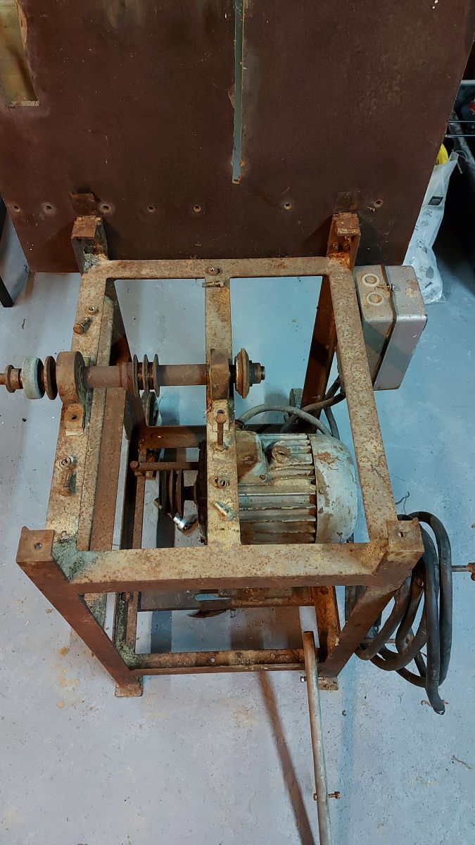

  • #12 18994579
    Szmajdek
    Posts: 6

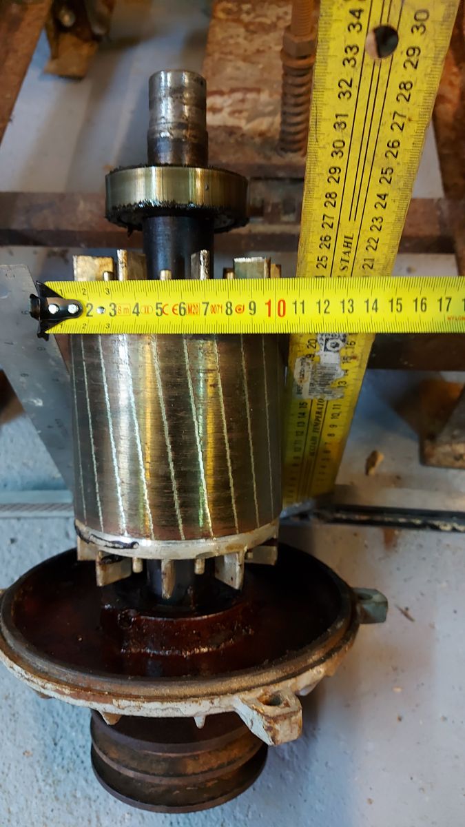

    Hello. I will not start a new thread because I have a similar problem. I found my grandfather krajzege in the garage and he wants to reactivate it. Referring to the scheme as above
    A - 115
    B-190
    D-28/30
    E-60
    The cable is also "tired" so I will replace it but I do not know what square is there and what to replace it. 4-wire 3-phase motor.

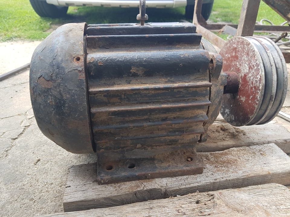

  • #13 18994628
    sp3ots
    Posts: 3073
    Help: 524
    Rate: 674
    Hello !
    The engine shown in the photo is damaged (burnt).
    Do not connect it to electricity /
  • #14 18995106
    Szmajdek
    Posts: 6
    The engine worked until I unscrewed it and opened it ...

  • #17 18995223
    krzysiek7
    Moderator of Electricians group
    Posts: 4880
    Help: 678
    Rate: 1953
    Such an overheating of the winding proves that the motor worked in the absence of one phase and even if it is still working, its hours are numbered, and further use in this state is not very safe.
    It is one of the SZJe motors, four-pole, so about 1440 rpm. If you enter the inner diameter of the core and the length of the core, I will give you exactly which motor it is.
  • #18 18995230
    Szmajdek
    Posts: 6
    The one on the fight is 11x15.5 cm
  • #19 18995234
    krzysiek7
    Posts: 4880
    Help: 678
    Rate: 1953
    Which length is it and whether you measured with aluminum or the core itself, and the core is important here.
  • #20 18995237
    Szmajdek
    Posts: 6
    That was it?
  • #21 18995244
    krzysiek7
    Posts: 4880
    Help: 678
    Rate: 1953
    Yes. It is a SZJe 34a motor, 3 kW, 1430 rpm, rated current 6.5 A at 380 V, star connection.
    For formalities, the core diameter is 112 mm.
  • #22 18995246

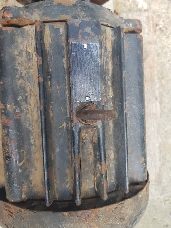

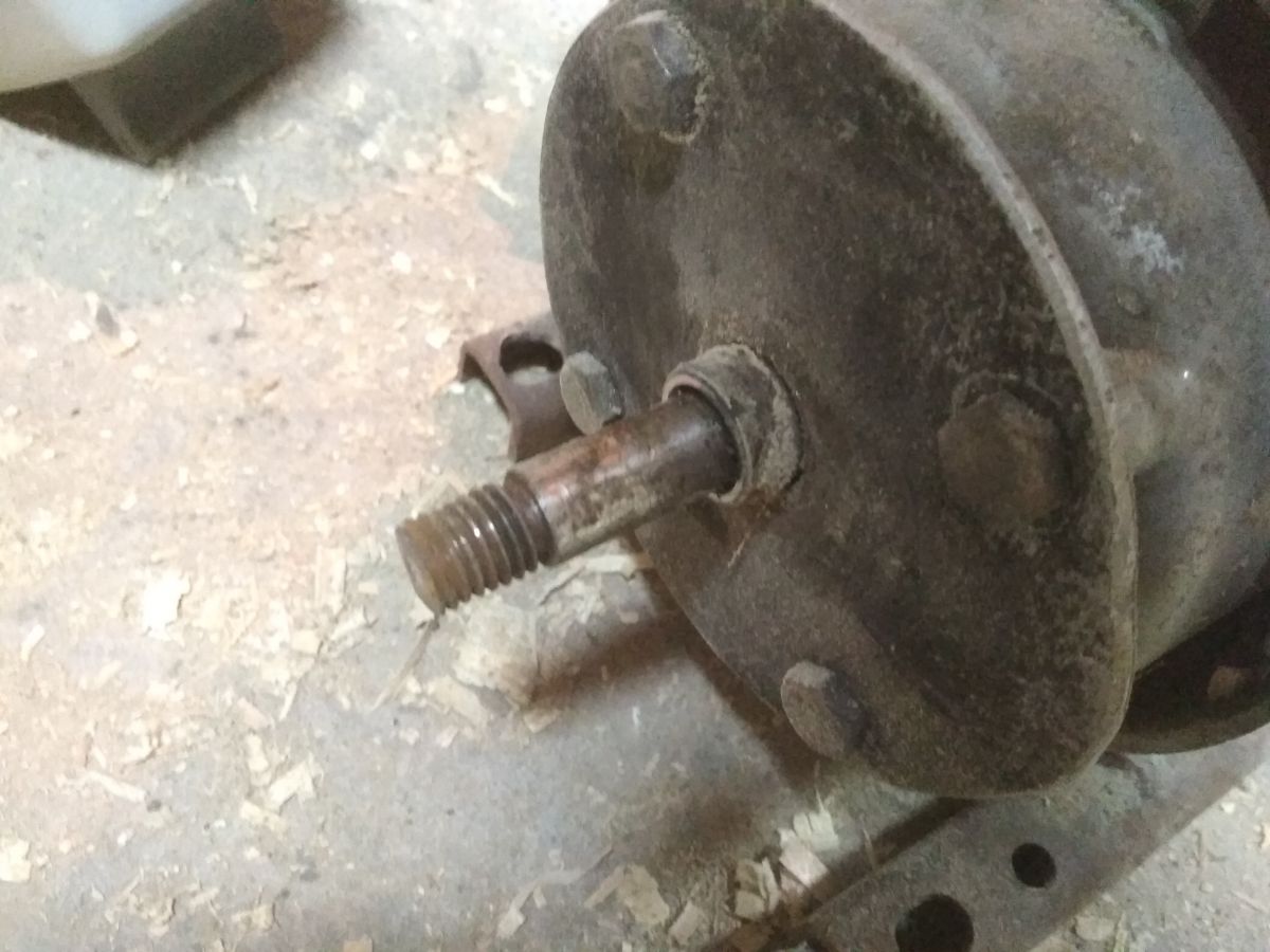

  • Requesting motor power and speed identification from M6 marking
    #26 19064534
    vampa
    I have a similar problem, the engine without a plate.
    What might its power and turnover be? Low speed or not?
    The only information I could get is the M 6 marking.
    Distance between screws for fixing 150 mm
    Shaft length 60 mm
    Shaft diameter 15 mm
  • #27 19068126
    e2rd.o
    Level 21  
    Posts: 317
    Help: 39
    Rate: 111
    These motors were produced 1-phase 180W 1400 rpm.
    3-phase 400W 1400 rpm and 600W 2900 rpm.
  • #28 19070011
    vampa
    Thank you very much for help.

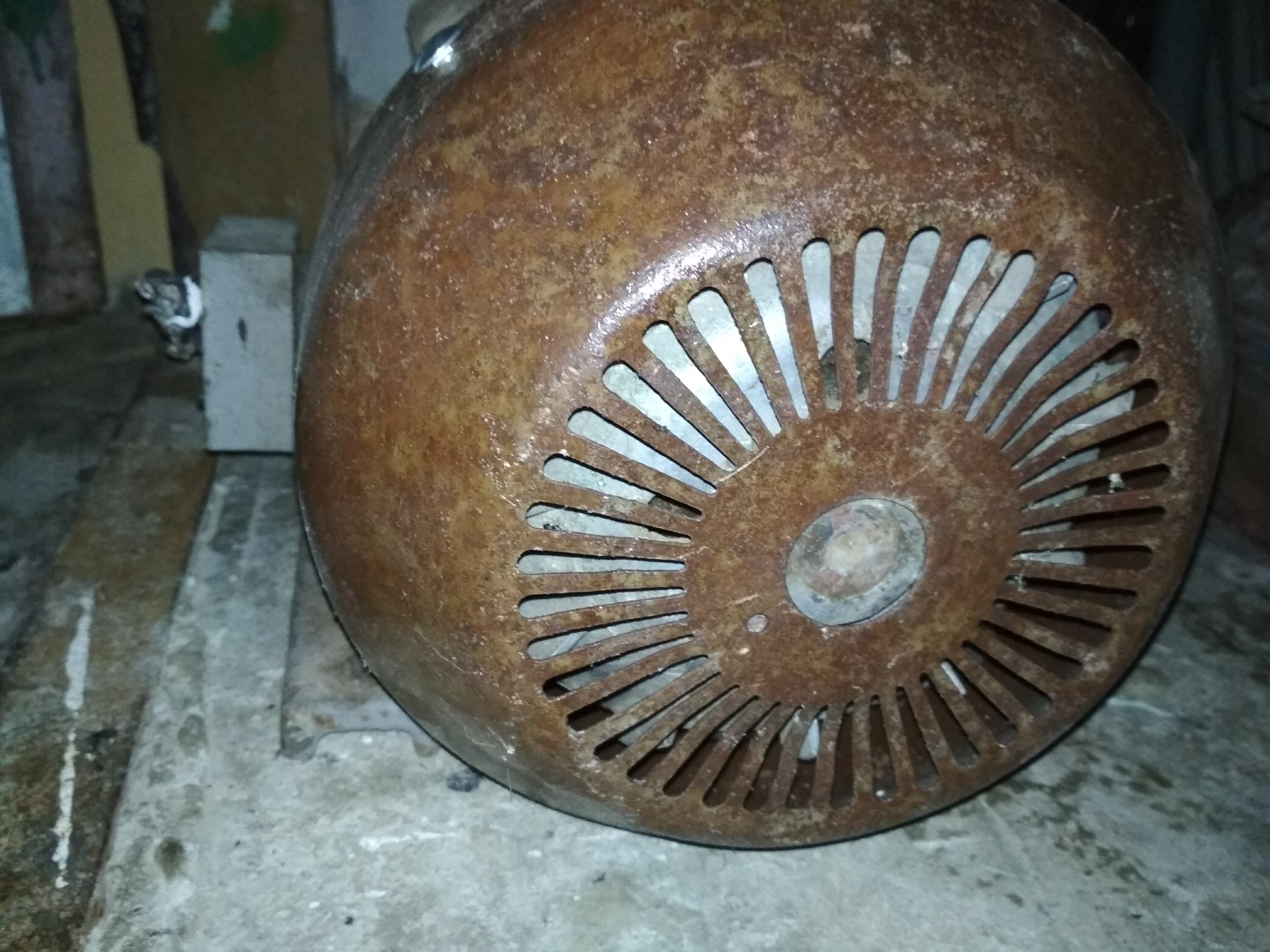

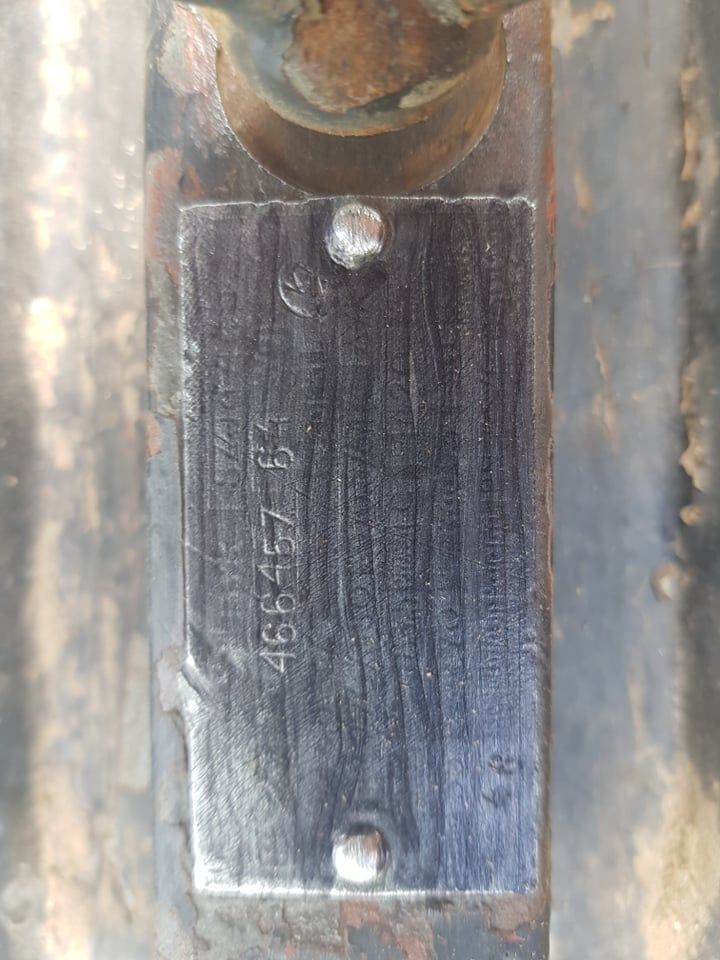

  • Identifying a Celma SZJd 44a motor from nameplate scraps
    #29 19534813
    Mazda6125
    Posts: 27
    Rate: 8
    I dismantled the country frame and it left my engine. I do not know what power it has, because the plate is illegible, but it is rather strong, because my finger cut off my finger less than a year ago without a problem :D
    The plate was covered with two layers of different paints, after delicately scraping individual numbers and letters can be read, but not all (especially power). In the beginning, at Uncle Google, I started looking for her by appearance - to no avail. Then I looked for photos of nameplates and looked between mine and those from the shared data network. Something has been established, but not much.
    I was able to read from the plate that the engine spins up to 1420 rpm (if I read it correctly, but rather well). The model is hardly readable, but I believe that SZJd 44a is written there.
    One more comment (not very helpful) - I come from Cieszyn (just like this circular saw) and there is a Celma factory in this city, which produced (I do not know if further) just such engines. Maybe it's some model of them?
    Can anyone recognize the beast from these few photos and scraps of information? :)
    Check Engine Power Without Nameplate: Measuring Old Attic Engine's Power Capacity Check Engine Power Without Nameplate: Measuring Old Attic Engine's Power Capacity Check Engine Power Without Nameplate: Measuring Old Attic Engine's Power Capacity Check Engine Power Without Nameplate: Measuring Old Attic Engine's Power Capacity Check Engine Power Without Nameplate: Measuring Old Attic Engine's Power Capacity Check Engine Power Without Nameplate: Measuring Old Attic Engine's Power Capacity Check Engine Power Without Nameplate: Measuring Old Attic Engine's Power Capacity Check Engine Power Without Nameplate: Measuring Old Attic Engine's Power Capacity
  • #30 19534814
    vorlog
    Level 40  
    Posts: 8347
    Help: 527
    Rate: 2586
    Moisten the plate with kerosene / WD40, then (at the right angle) it will become more readable :)
