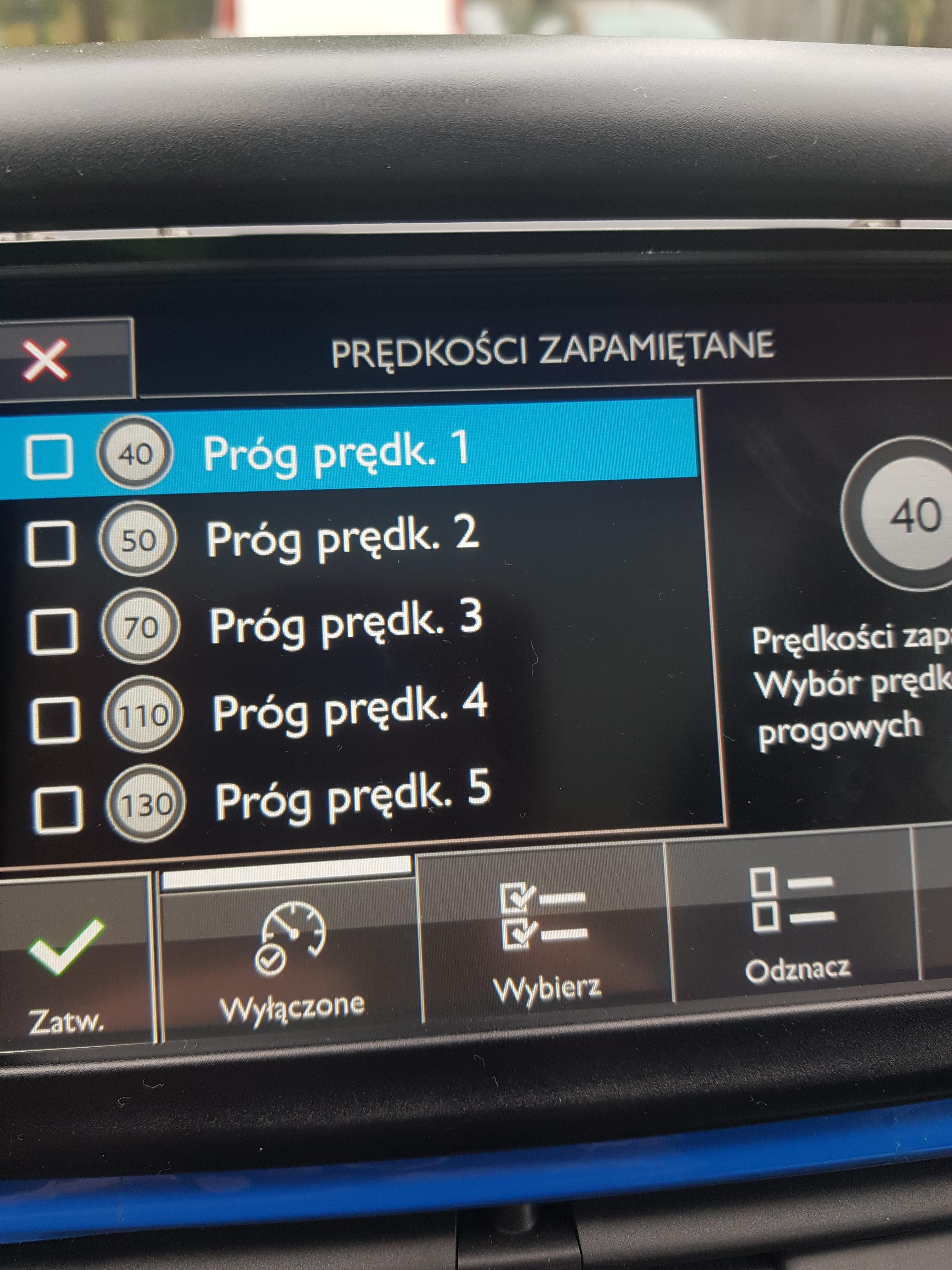

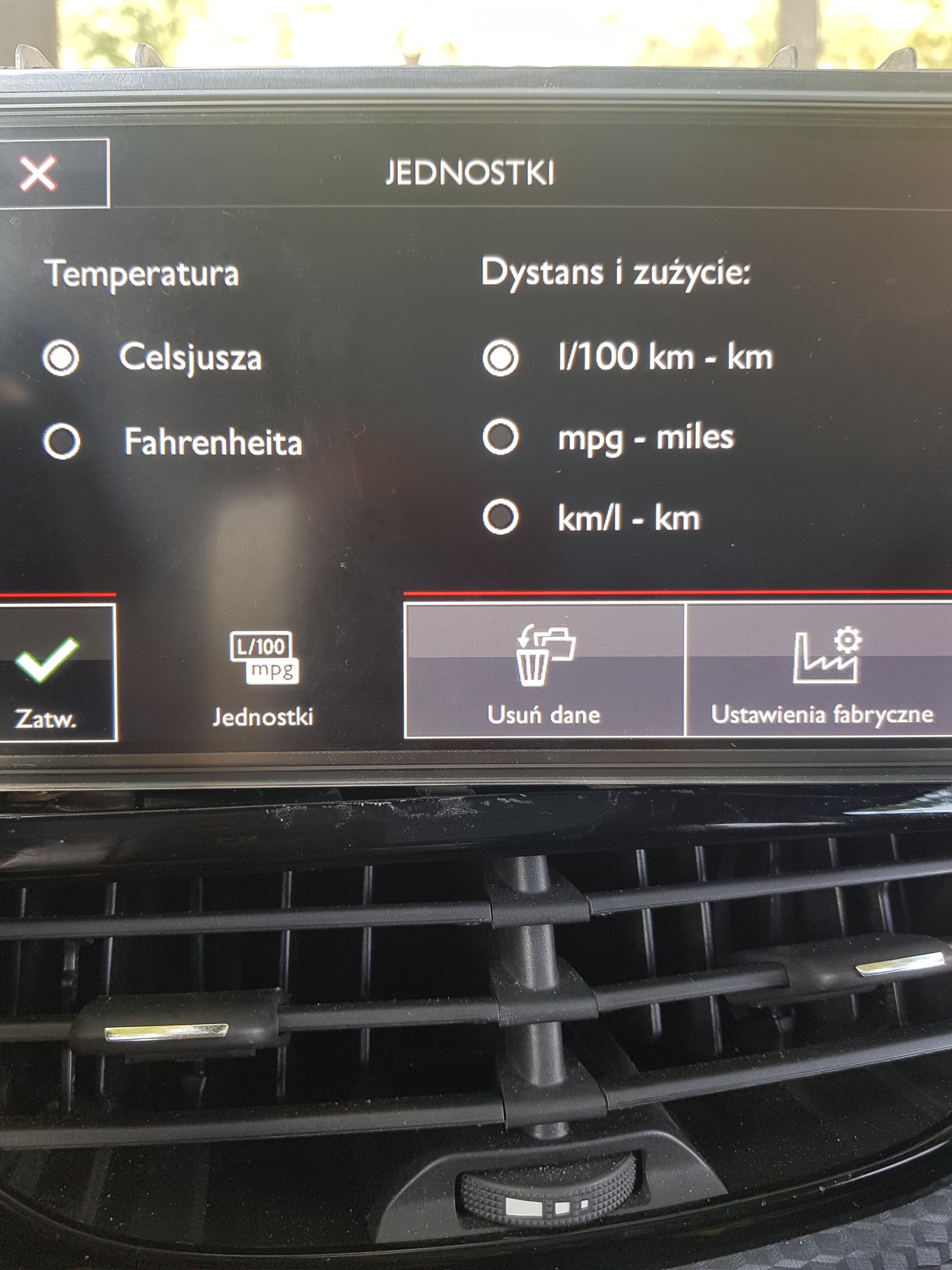

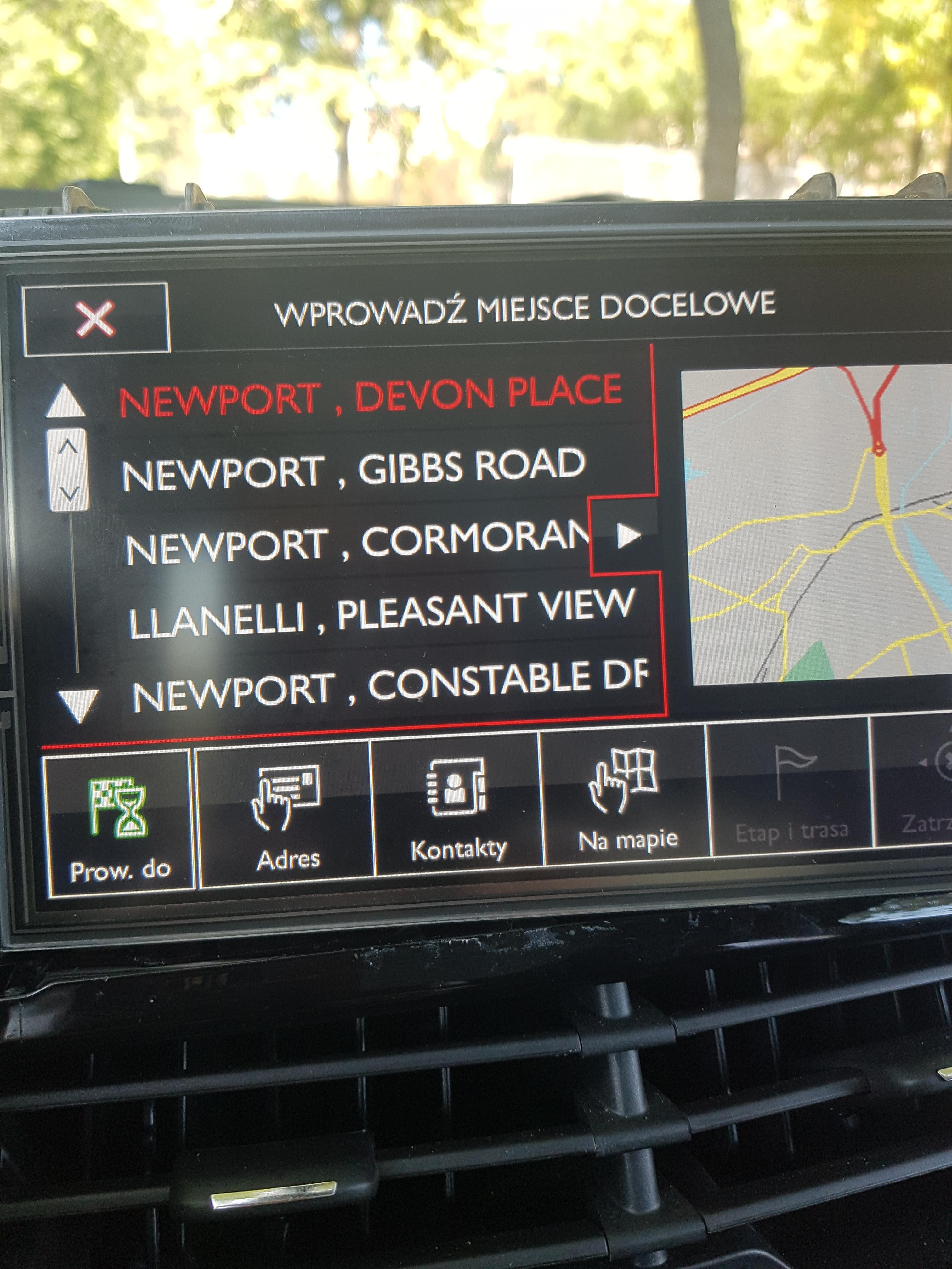

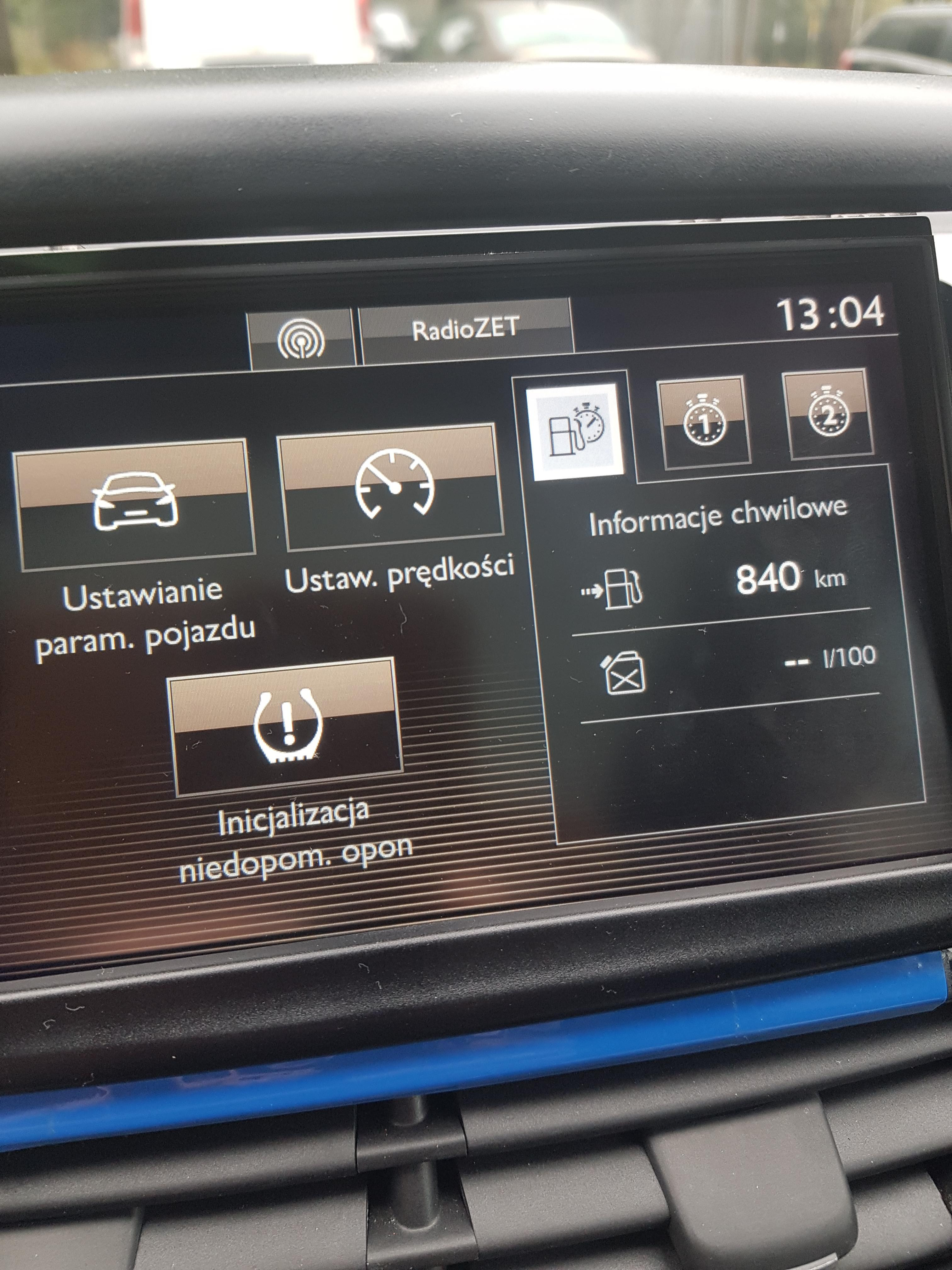

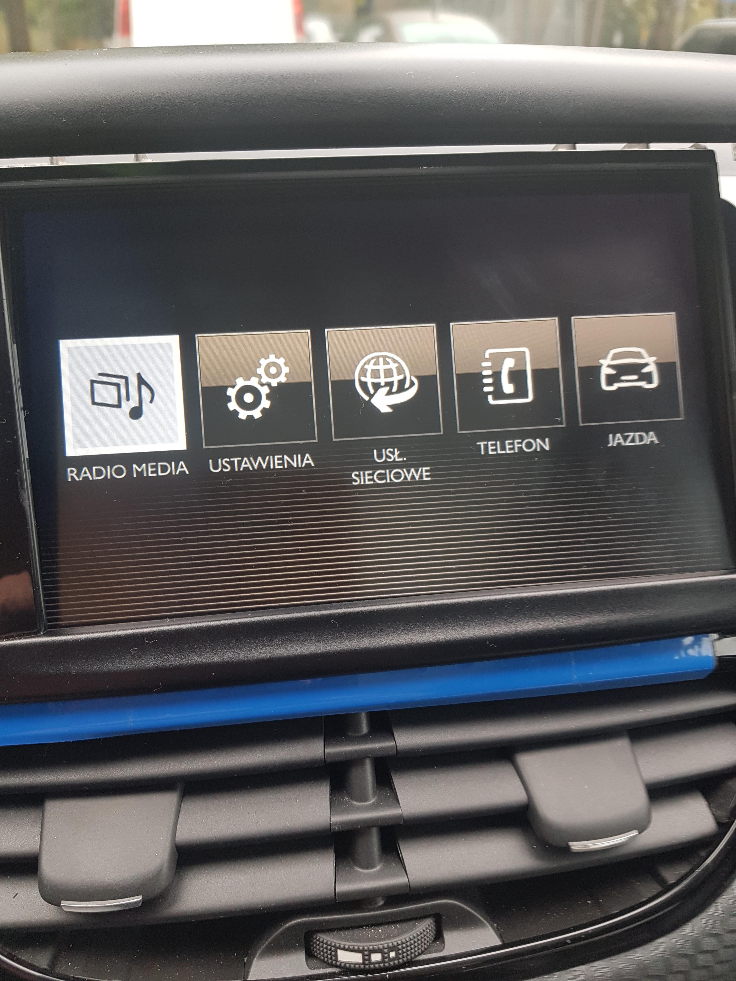

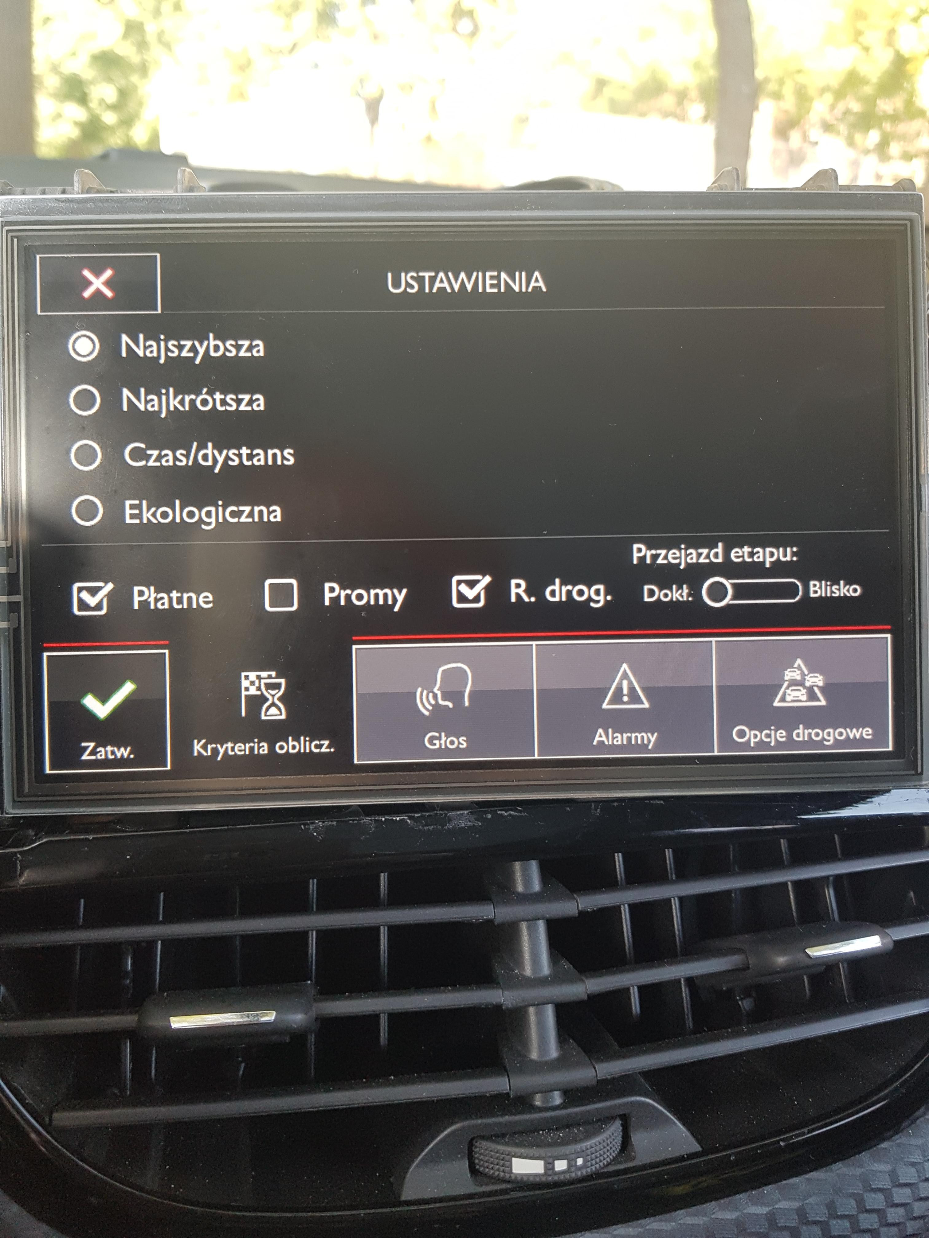

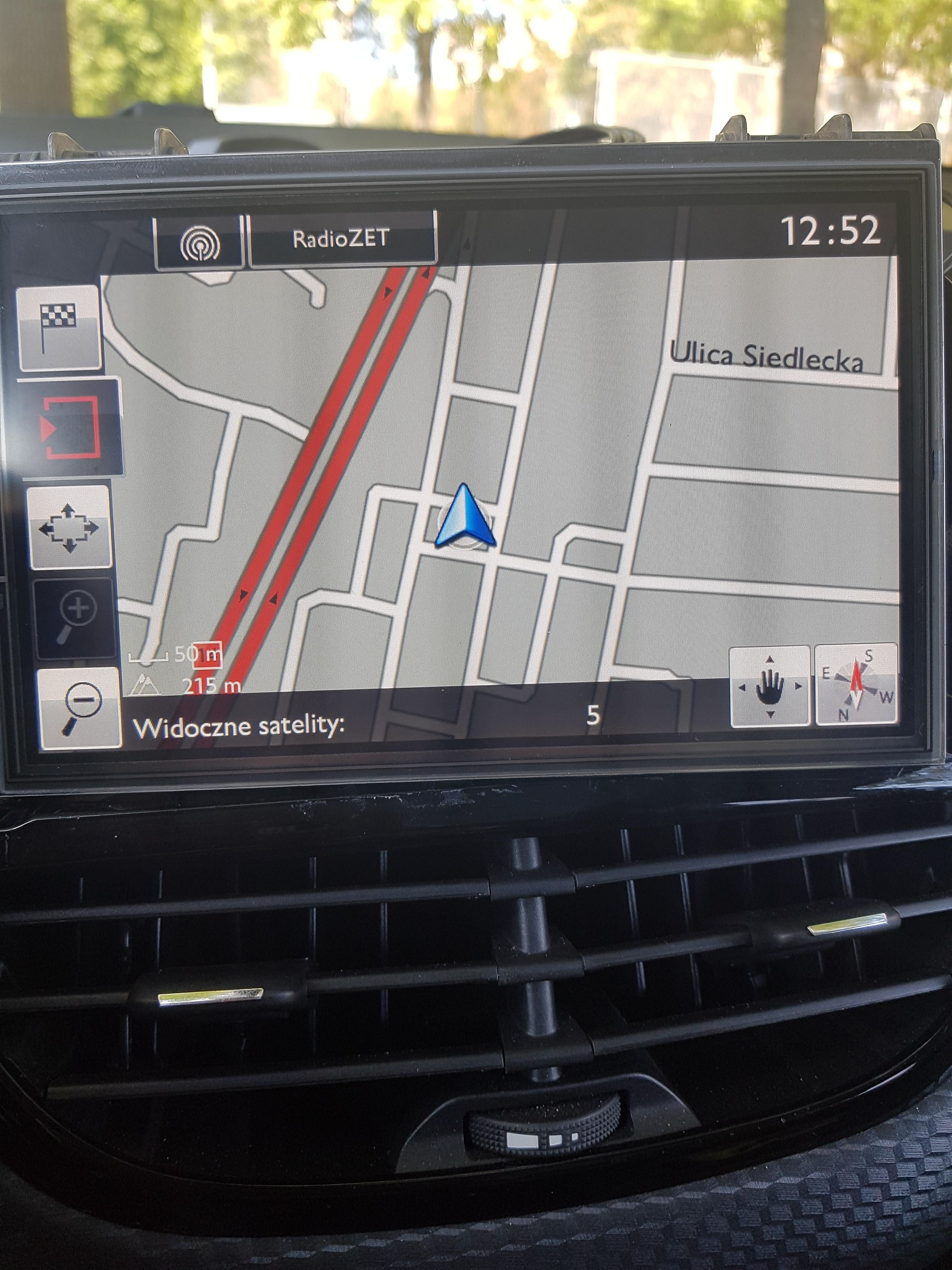

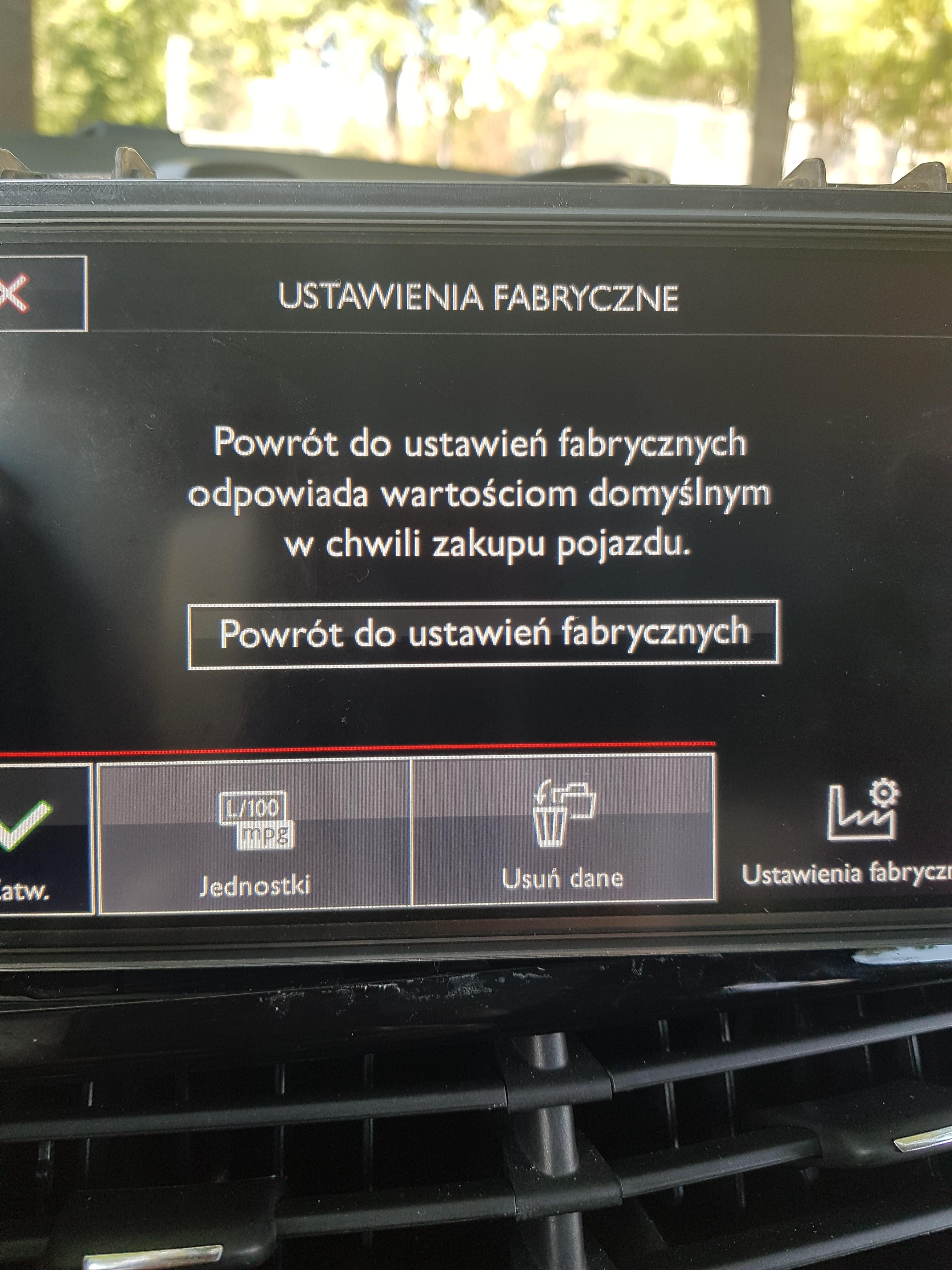

    >>21231868 Something has changed, but one by one, here are the menu pictures of my original radio:
    • Peugeot 208 Original Navigation Installation: Plug & Play or Modifications Needed? 20240913_130642.jpg (1.55 MB) You must be logged in to download this attachment.
    • Peugeot 208 Original Navigation Installation: Plug & Play or Modifications Needed? 20240913_130539.jpg (1.53 MB) You must be logged in to download this attachment.
    • Peugeot 208 Original Navigation Installation: Plug & Play or Modifications Needed? 20240913_130532.jpg (1.49 MB) You must be logged in to download this attachment.

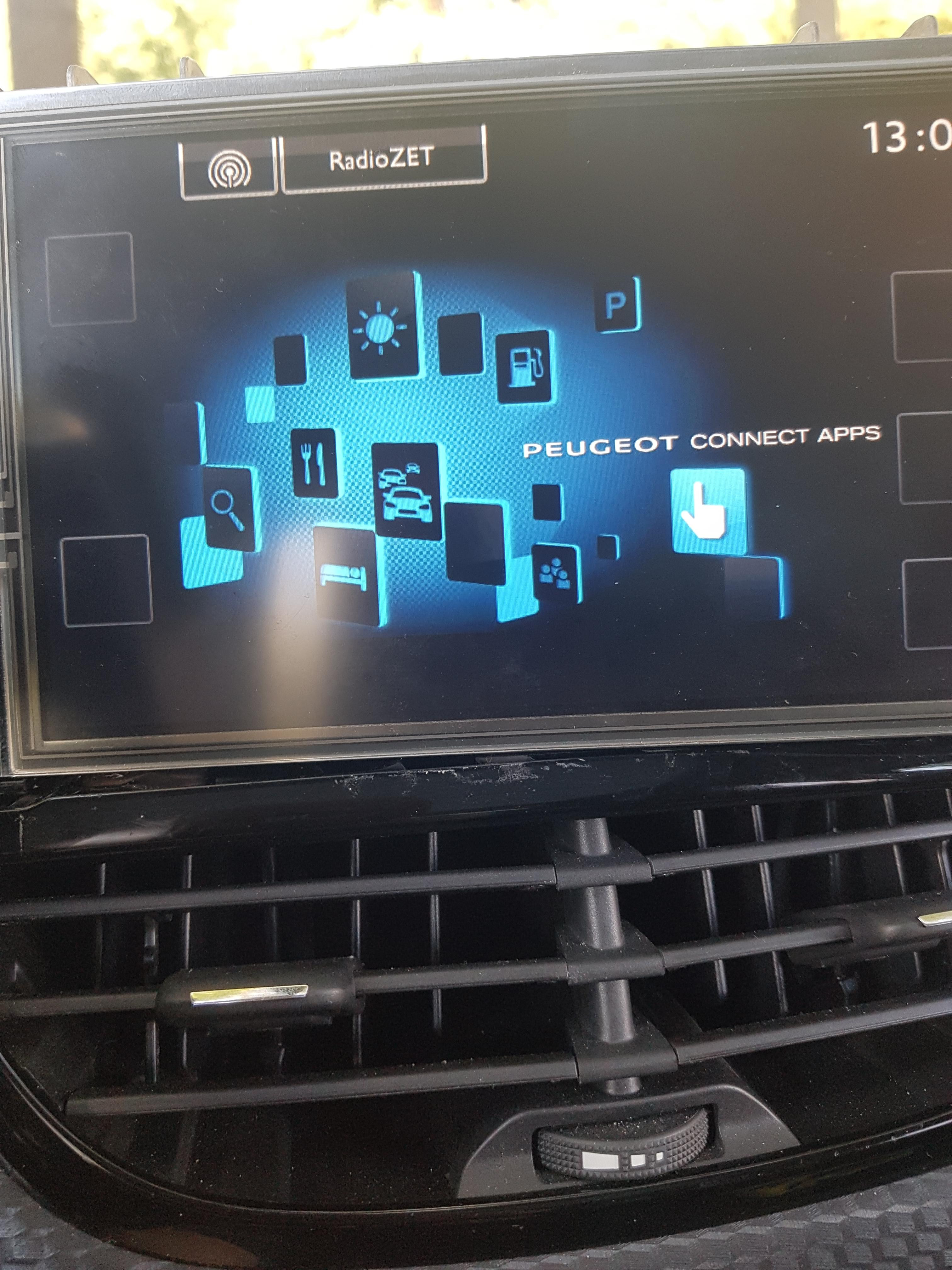

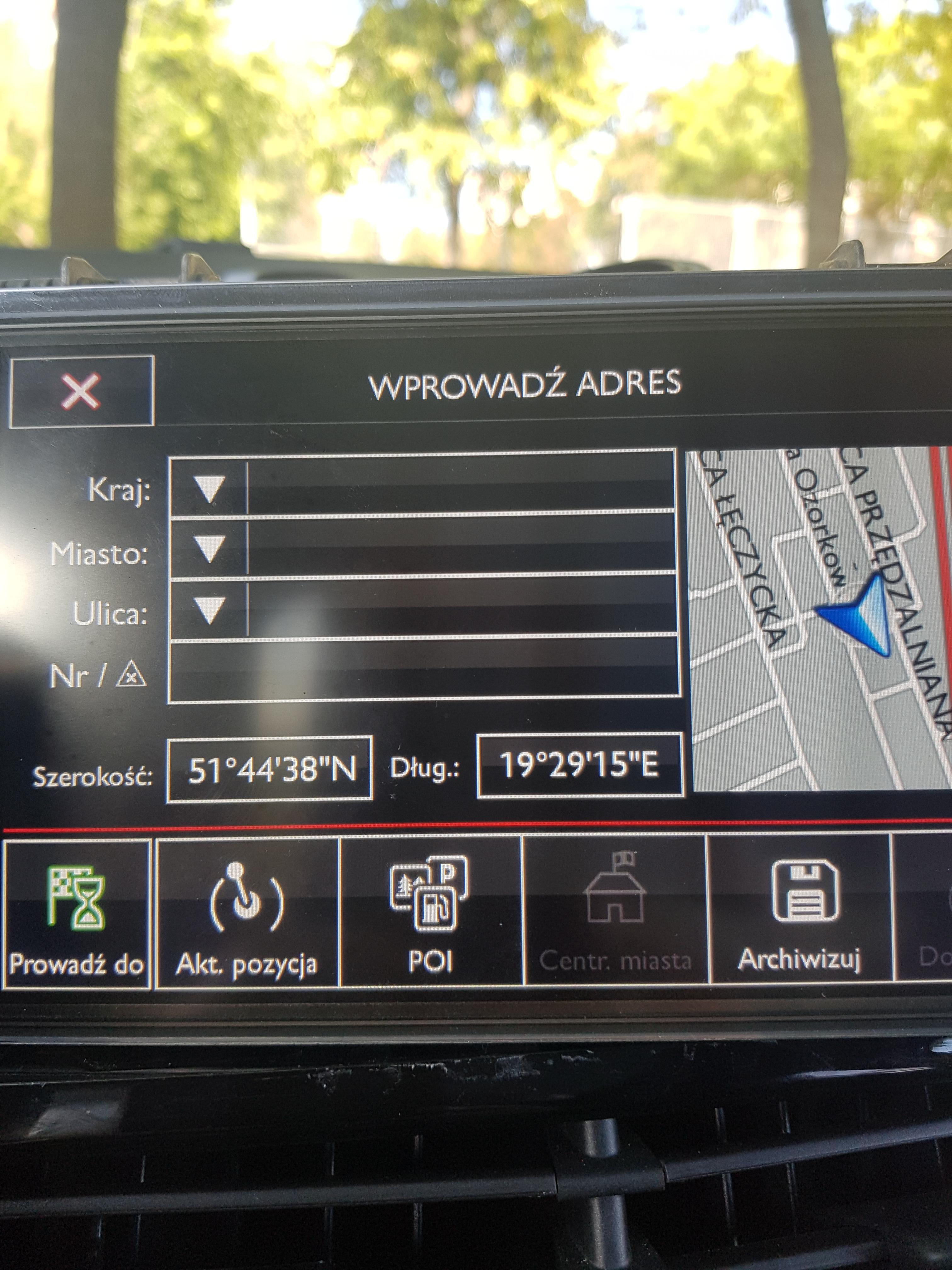

  • #32 21232455

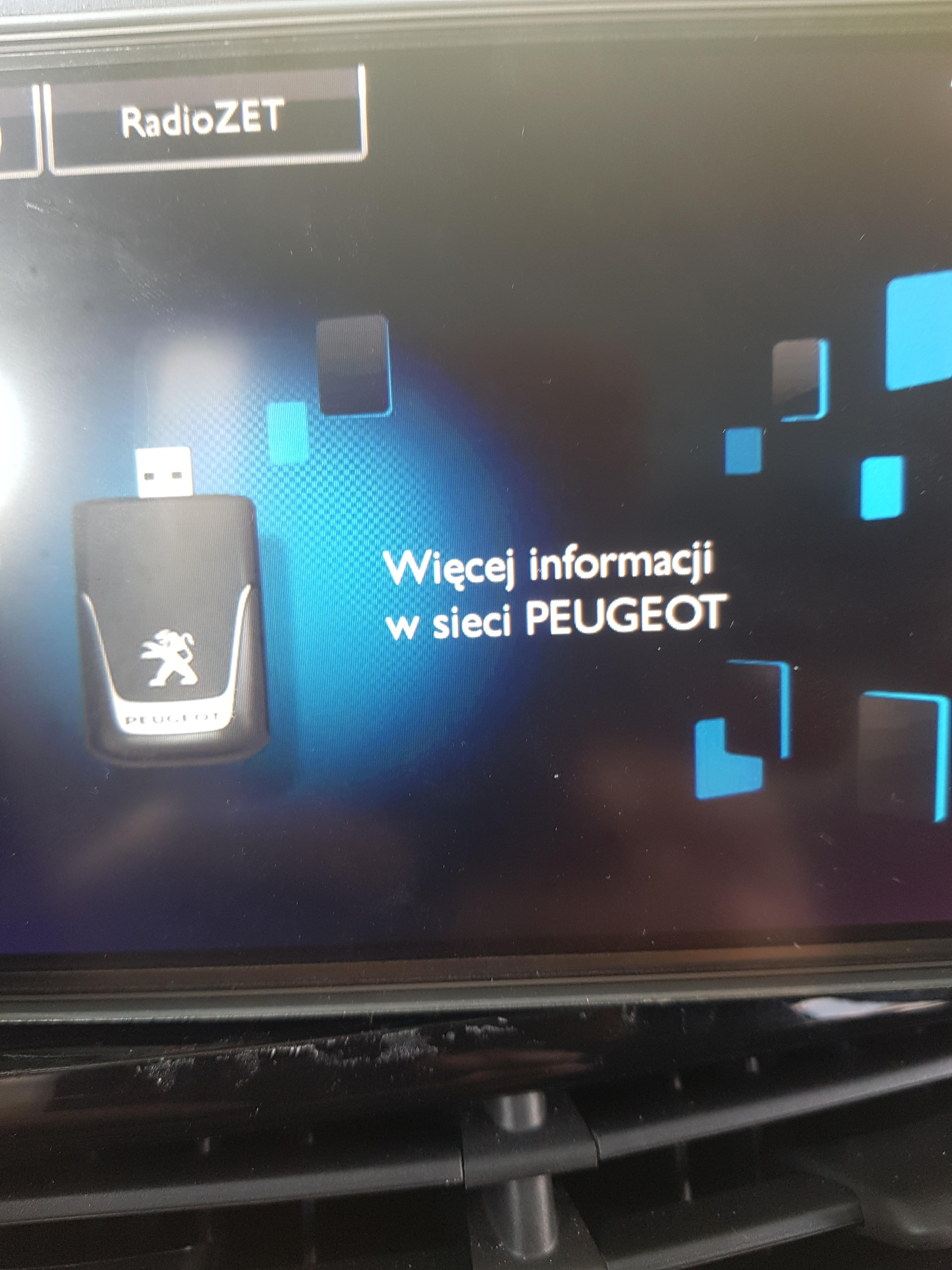

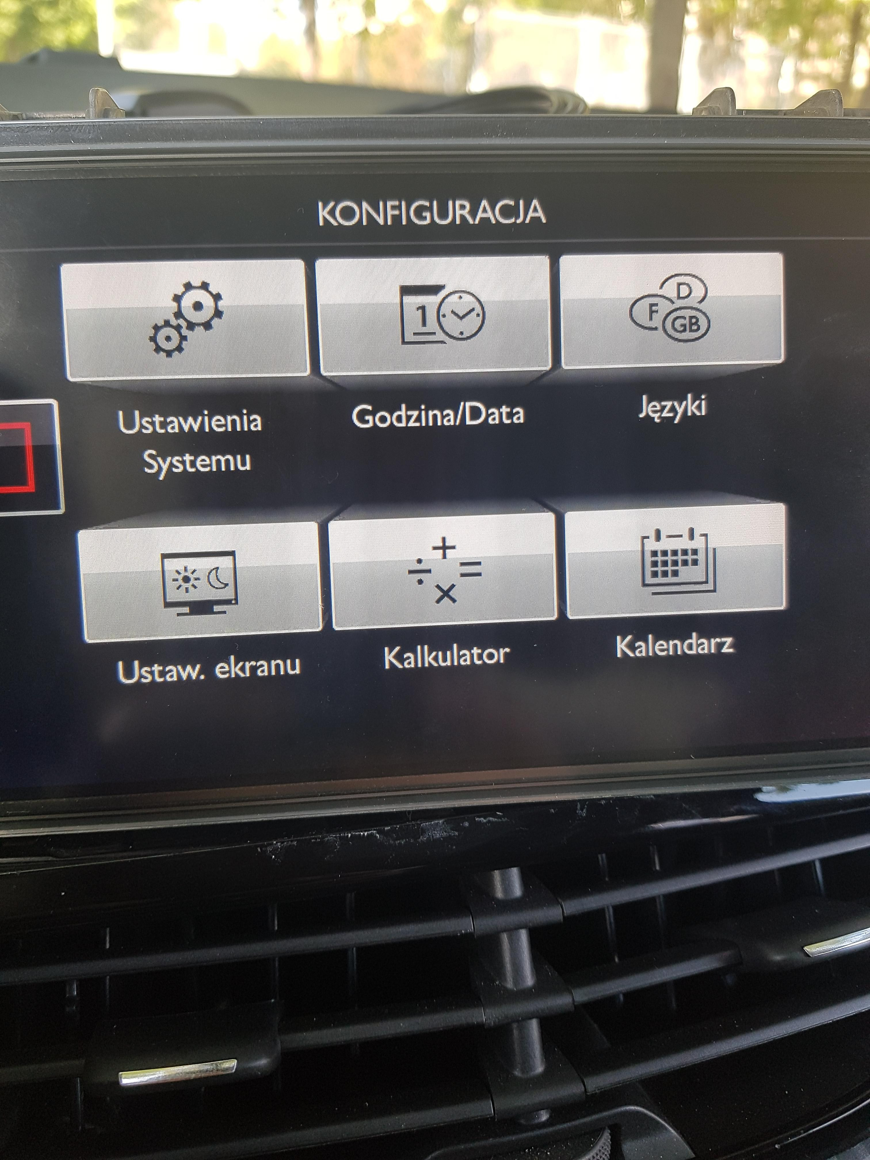

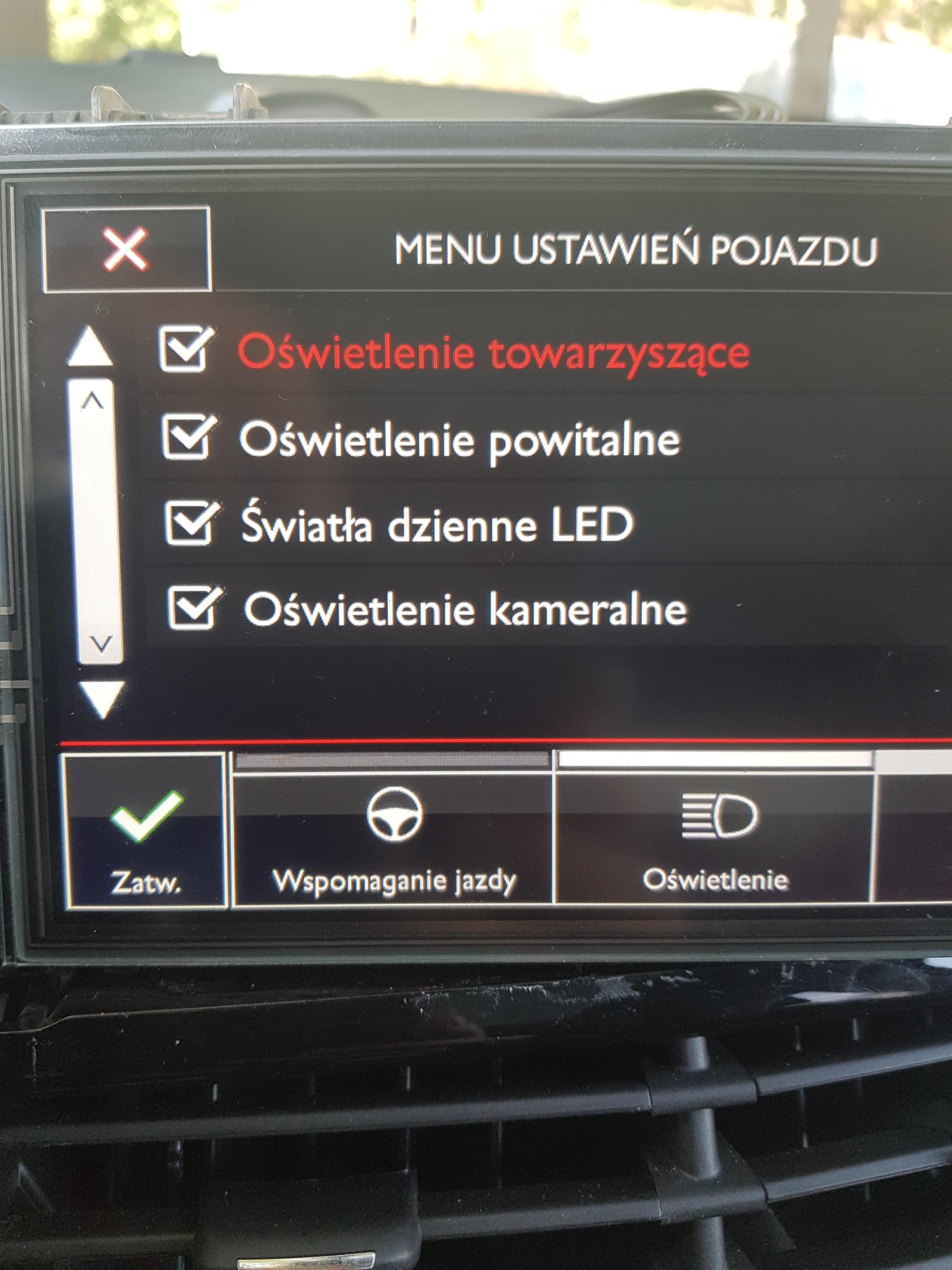

    123Irek
    Posts: 17

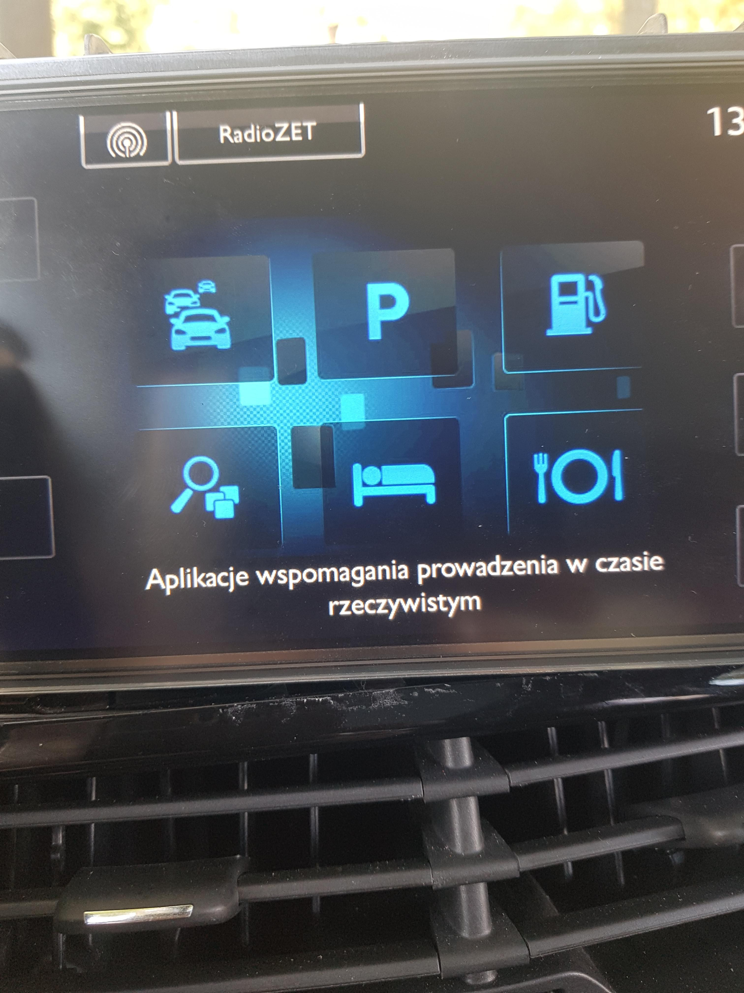

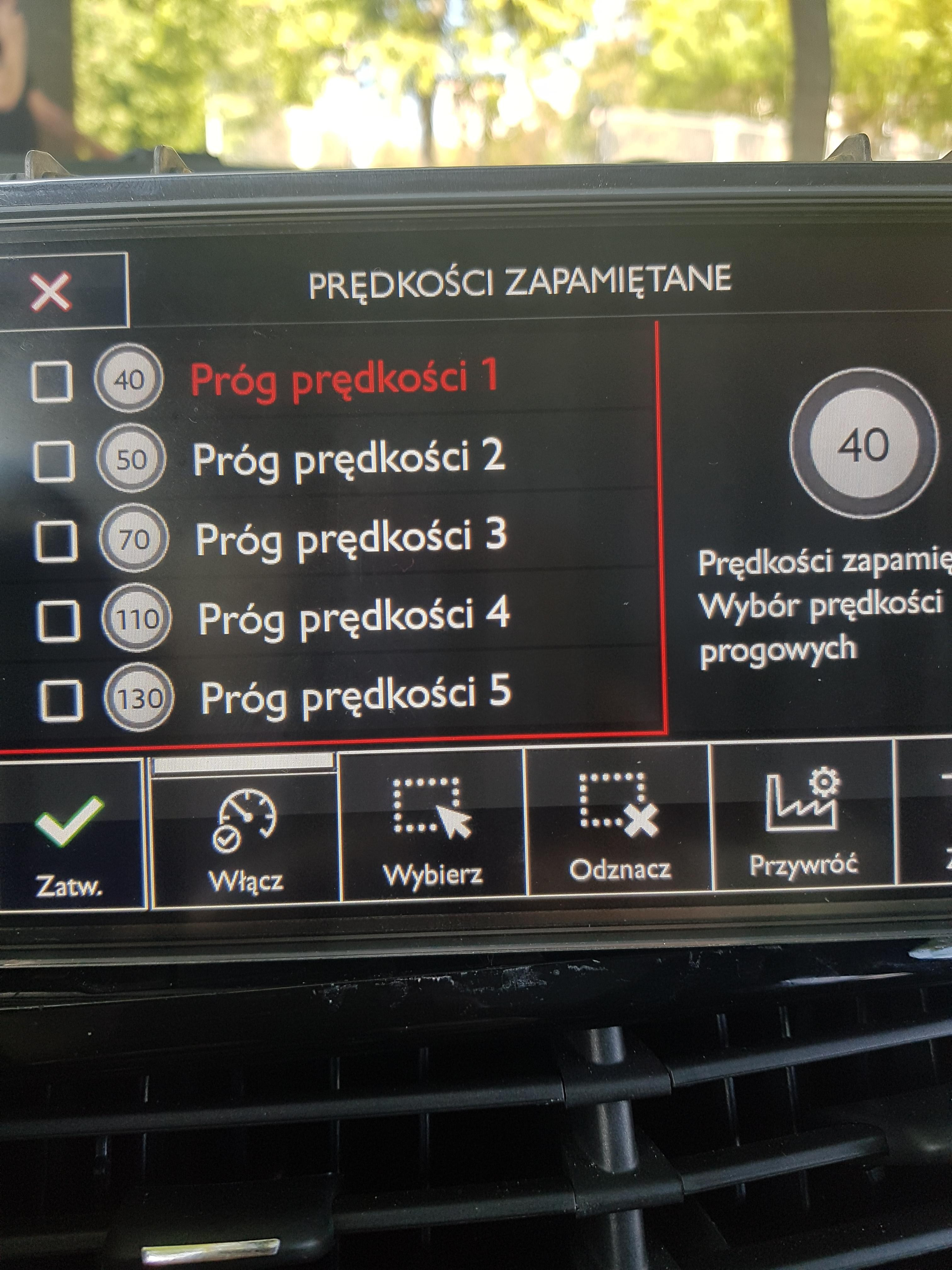

    >>21231875 and now something, after changing the radio, I am surprised and not entirely satisfied. The radio lives its life, doesn't connect to the phone and no image from the reversing camera. Images are completely random after pressing a button, menu
    • Peugeot 208 Original Navigation Installation: Plug & Play or Modifications Needed? 20240919_125237.jpg (1.76 MB) You must be logged in to download this attachment.
    • Peugeot 208 Original Navigation Installation: Plug & Play or Modifications Needed? 20240919_130819.jpg (1.27 MB) You must be logged in to download this attachment.
    • Peugeot 208 Original Navigation Installation: Plug & Play or Modifications Needed? 20240919_130810.jpg (1.49 MB) You must be logged in to download this attachment.
    • Peugeot 208 Original Navigation Installation: Plug & Play or Modifications Needed? 20240919_130634.jpg (1.45 MB) You must be logged in to download this attachment.
    • Peugeot 208 Original Navigation Installation: Plug & Play or Modifications Needed? 20240919_130527.jpg (1.48 MB) You must be logged in to download this attachment.
    • Peugeot 208 Original Navigation Installation: Plug & Play or Modifications Needed? 20240919_130623.jpg (1.36 MB) You must be logged in to download this attachment.
    • Peugeot 208 Original Navigation Installation: Plug & Play or Modifications Needed? 20240919_130236.jpg (1.37 MB) You must be logged in to download this attachment.
    • Peugeot 208 Original Navigation Installation: Plug & Play or Modifications Needed? 20240919_130219.jpg (1.48 MB) You must be logged in to download this attachment.
    • Peugeot 208 Original Navigation Installation: Plug & Play or Modifications Needed? 20240919_125929.jpg (1.33 MB) You must be logged in to download this attachment.
    • Peugeot 208 Original Navigation Installation: Plug & Play or Modifications Needed? 20240919_125557.jpg (1.52 MB) You must be logged in to download this attachment.
    • Peugeot 208 Original Navigation Installation: Plug & Play or Modifications Needed? 20240919_125403.jpg (1.54 MB) You must be logged in to download this attachment.
    • Peugeot 208 Original Navigation Installation: Plug & Play or Modifications Needed? 20240919_130829.jpg (1.21 MB) You must be logged in to download this attachment.
  • #33 21233203
    SZYMON BYDGOSZCZ
    Posts: 3845
    Help: 340
    Rate: 1709
    123Irek wrote:
    >>21231777 and this is what I bought
    This is not a radio for the 208.
  • #34 21234018
    123Irek
    Posts: 17
    >>21233203 So each car model has a radio model assigned to it?
  • #35 21835605
    continentalrpfago
    Level 4  
    Posts: 12
    >>21231822 This is a 1st generation 208. No online coding is needed. All you need is a DiagBox pirate for this.
  • SMEG configuration requires server-side calibration
    #36 21837419
    artur.heise
    Posts: 1637
    Help: 226
    Rate: 614
    continentalrpfago wrote:
    >>21231822 This is a 208 1st generation. No online coding is needed. Just pirate DiagBox for this.
    Not enough. For SMEG the configuration (calibration) is calculated on the server and then sent back. The only thing you can piartem is to add the VIN as you connect as RNEG2010. As a rule, such an action will throw out any configuration changes and return you to the factory settings - so if the radio is from a different model, you will have to configure it from scratch.
