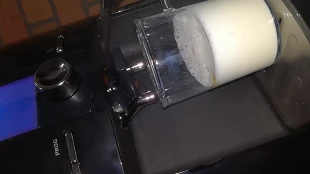

    Hello, I bought a coffee machine and after a few coffees there was a leak near the spouts. I returned to the store - a warranty claim. After a few days, the coffee machine was returned to me and it was written that it was and is operational and that the device was sealed. I would like to add that after opening the new machine, there was coffee in the grinder and three coffees made. KRUPS wrote that these are tests to check the device at the factory. I am attaching a video, is it normal coffee machine operation?
    [movie: bbb777cf77] https://filmy.elektroda.pl/32_1515350990.mp4 [/ movie: bbb777cf77]
    After making two coffees, I have about 50 ml of beakers in a drainer.
    Best regards and I am asking for professional answers.

    no, this is not normal operation. I have a similar coffee maker, but one of the previous models.
    I suspect the leak is in the connection of the hoses from the brew unit to the spout tube.
    Link to youtub, what the route of this hose looks like
    https://www.youtube.com/watch?v=JzCUu04Wzp4

    Claim the warranty and write to the krups company directly and attach a video ;)

    The case went to the spokesman, today I was at the guy who repairs such coffee machines, he showed me how the spout is built, I removed mine. Is it possible that the spout does not keep up to receive coffee from this white tube, because it looks like it after the traces of leakage. I attach photos.

    Maybe some seal is missing there?

    Today I removed the spout and unscrewed it,
    I don't know what it should look like but I think it's ok
    it is symmetrical, no straight channels
    spreader, unless the channels are too narrow

    Hello, I picked up the coffee machine, they replaced the spout with a new one, all chrome and it is still like in the movie. What to do with the coffee wrong?

    Hello, the next replacement of the spout and the movies sent to the store continue.

    Finished topic I bought a new one
