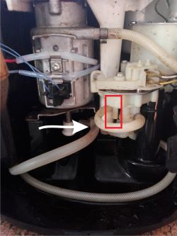

    Hello everyone and I am asking for advice on the subject of a leaky coffee machine. A few months ago I replaced the piston, infuser and 2bar valve seals. Unfortunately, recently, a few days after descaling, there was a serious leak of clean water under the machine. After removing the housing, it turned out that water was pouring out of the element marked in red on the borrowed photo. The leakage occurs at the stage of preparing the coffee machine.
    It looks like this: I turn on the coffee machine, it heats up, the pump starts, the plunger goes down, you hear the dispenser mechanism, the pump starts again and at this point there is water, nothing comes out of the nozzles only into the tray and under the coffee machine, all diodes start flashing, plunger stays at the bottom and error code 6 is displayed.
    What to do? Distributor, clogged boiler, something else? Thanks in advance for the tips.

    Distributor for replacement.

    Replacing the distributor helped. The coffee machine came back to life. By the way, the work culture has improved, it is quieter.
