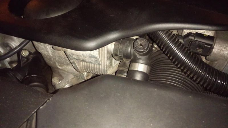

    I am aggravating the problem in my engine with water constantly getting into the oil. Despite the quite obvious answer, which is the high probability of damage to the head gasket, the mechanic, diagnosing the operation of the engine, still does not believe that it was a head gasket. The engine runs smooth, quiet and keeps the engine temperature constant.
    Talking by chance with another mechanic, I found out that corrosion of the aluminum walls in the oil cooler is something common, at least in diesel engines. There are small perforations there and this is often the reason why oil and water mix.
    And now my question is, can I disconnect the water hoses from the oil cooler and connect them together to keep the circuit closed and thus eliminate the cooler?
    The photo shows something like a knob. I understand that this is a valve on the main circuit and turning it off will stop all the oil from flowing through the engine or will it just bypass the oil filter?

    Dear author, please specify: do you have water in oil or oil in water? Because it's a big difference ...

    This is how water seeps into oil. There is still quite a lot of steam coming from the exhaust pipe, and when I drive it on a cork or a dipstick it gets so-called. delicate mayonnaise.
    Besides, the engine is running normally; even and quiet and keeps the temperature evenly. On average, I have to add a liter of fluid to the cooling system every 300 km, and there are no water leaks to the outside. The engine was inspected three times very carefully.

    Maybe it's the head gasket.
    One cannot deduce much from the photos, as it has been written before: it is disassembled and checked.

    Do you have eyes or have they fallen out? The topic of the thread is: "... mixing oil with water", in the first sentence it says: "... water getting into the oil", so please clarify, because there can be both water in oil and oil in water, means something else (as you know), and people treat statements interchangeably !!! Better, however, just to screw yourself and get 2 points, report back ;) .
    @mavi "Cap" for the photo, the head to be checked properly and do not drive like this, you have poor lubrication ...

    Not necessarily a gasket - BMW is famous for cracking heads. So there may be surprise and costs.
    Close the hatch immediately and never look there yourself again. This is not a valve, just a vent.

    and test the gases in the system cooling, a great patent, and then only the head gasket ...

    Check the fan and replace the O-ring between the filter and the cooler to be sure. it gets tough over time.

    This is a faulty valvetronik engine, everything can kneel in a moment, of course, you can bypass the oil coolers, of course, you can remove the heads and make a new gasket.
    I do not know what you are counting on, get to work and collect for repairs and do not click on the forum here and on others.
