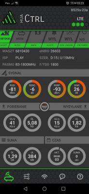

    Hello. I have a problem with my location. The 900 band does not work practically, it drops connections. The 1800 band is nice but the range is poor. I looked at different places in the apartment. I am throwing screenshots with the 800-3000 dipole antenna. Speed improved to 1800. DL 5.5 UP 6-7 antenna excluded. With antenna DL 13.8 UP 26.5. I have a question whether to change the router to the ZTE mf286r and give the antenna 1800, or stay with the B525 router and 1800 antenna. Choosing the Best ANTENA LTE for Huawei B525 Router - T-Mobile Network, Speeds & MIMO 800-2170MHz Choosing the Best ANTENA LTE for Huawei B525 Router - T-Mobile Network, Speeds & MIMO 800-2170MHz Choosing the Best ANTENA LTE for Huawei B525 Router - T-Mobile Network, Speeds & MIMO 800-2170MHz Choosing the Best ANTENA LTE for Huawei B525 Router - T-Mobile Network, Speeds & MIMO 800-2170MHz Choosing the Best ANTENA LTE for Huawei B525 Router - T-Mobile Network, Speeds & MIMO 800-2170MHz
  • #35 19088789
    trus007
    Posts: 23
    Yes, I thought it was jammed, since such a difference between UP and DL, you probably told me about it once. With this 1800 I meant that something can be done on this band, at 900 it breaks the connection. I have already sent the antenna back so I made an appointment with the seller. I can resign from the plus within a month. From one window I have an uninterrupted view of this Play tower. In that case, we buy the set at Play and the antenna you wrote about (I have a self-made holder for mounting on the windowsill, photo below) Choosing the Best ANTENA LTE for Huawei B525 Router - T-Mobile Network, Speeds & MIMO 800-2170MHz . Thanks for the help. I will let you know what it will look like in Play. best regards

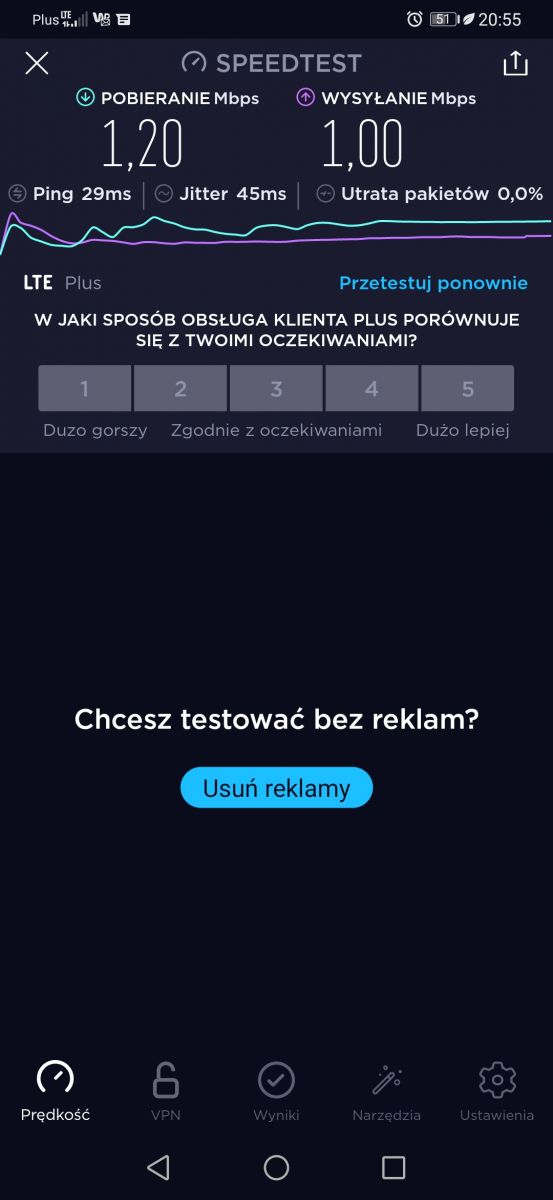

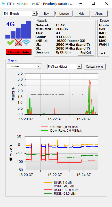

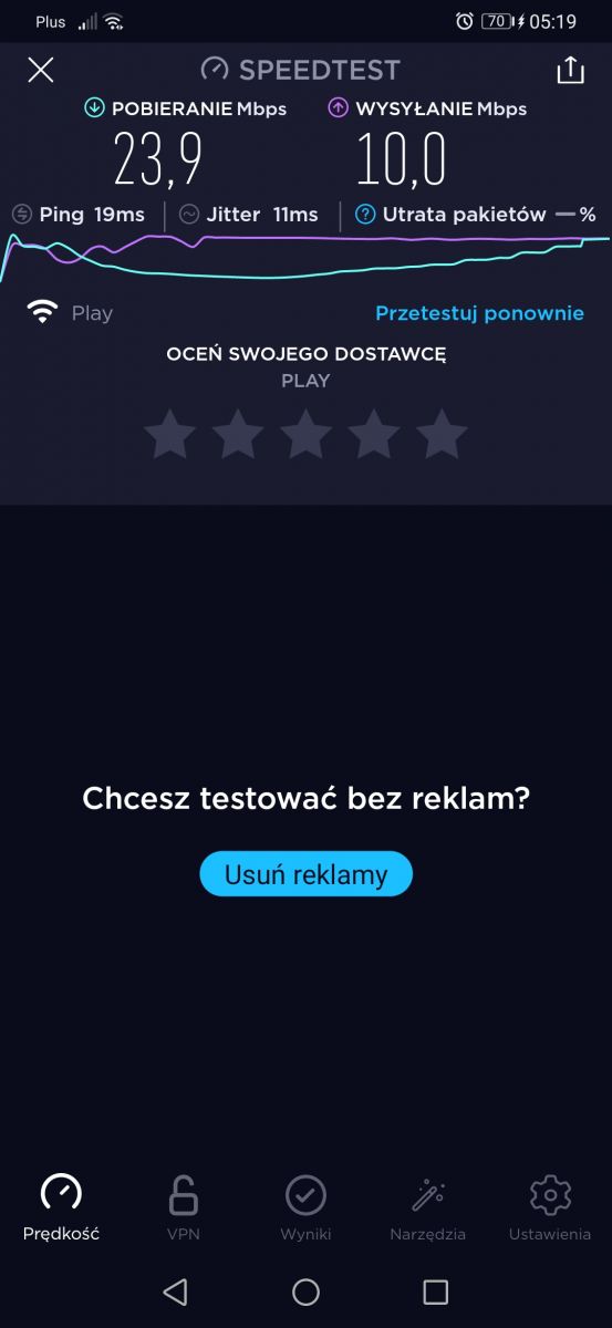

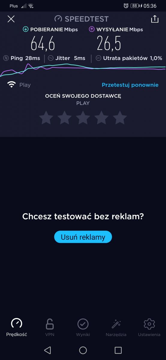

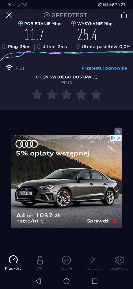

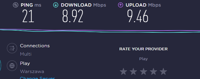

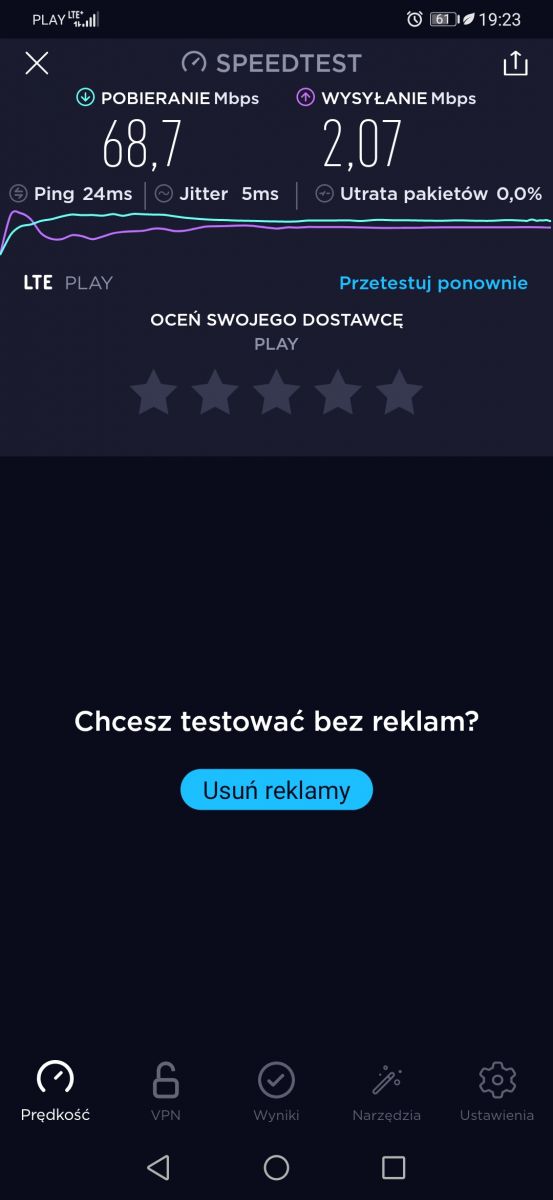

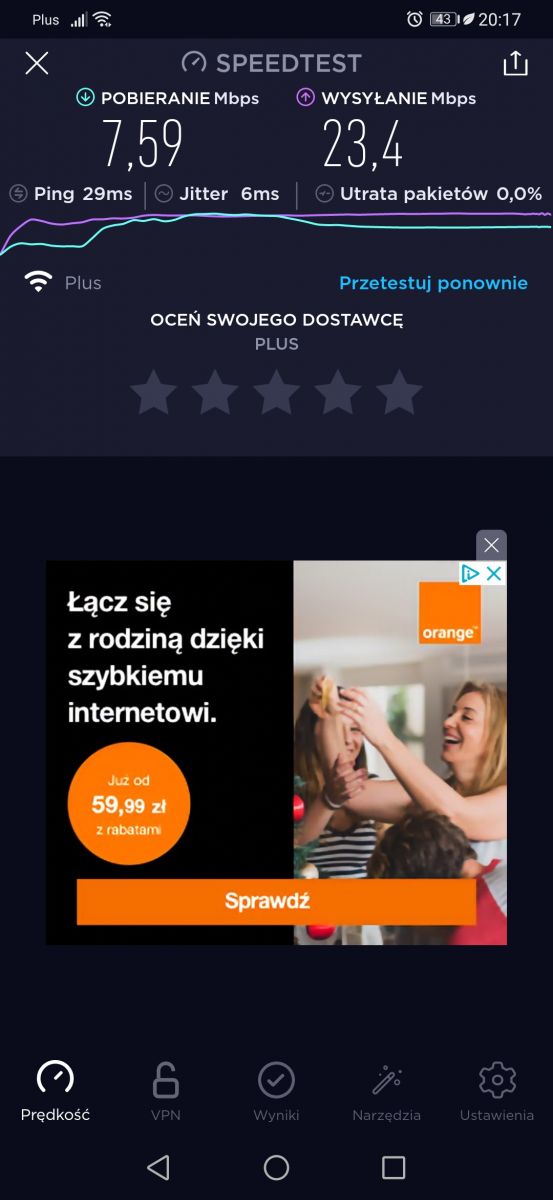

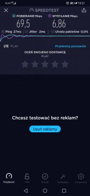

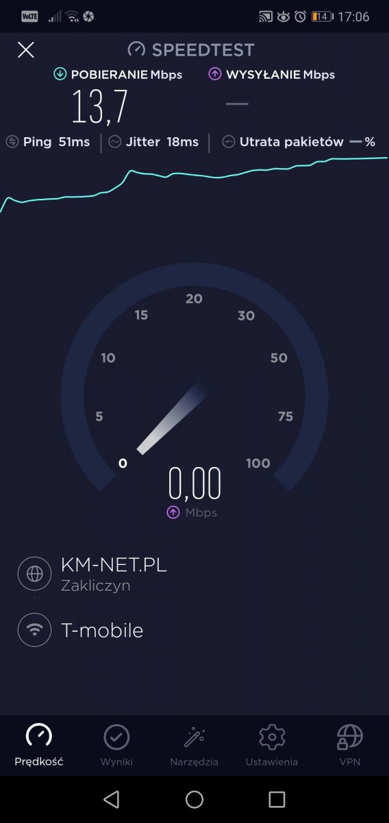

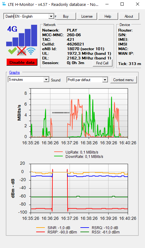

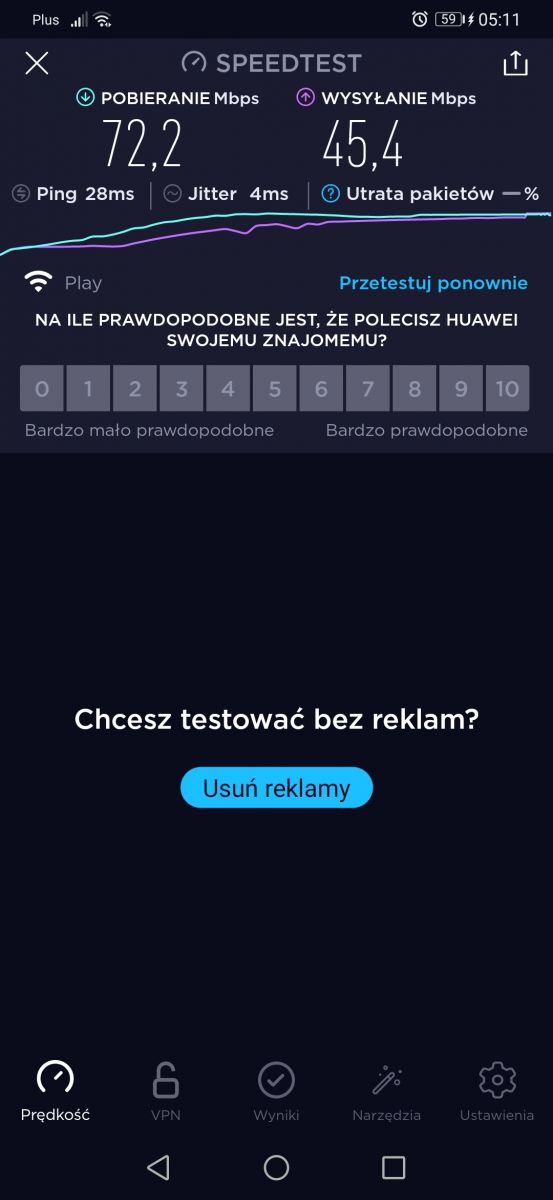

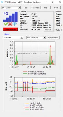

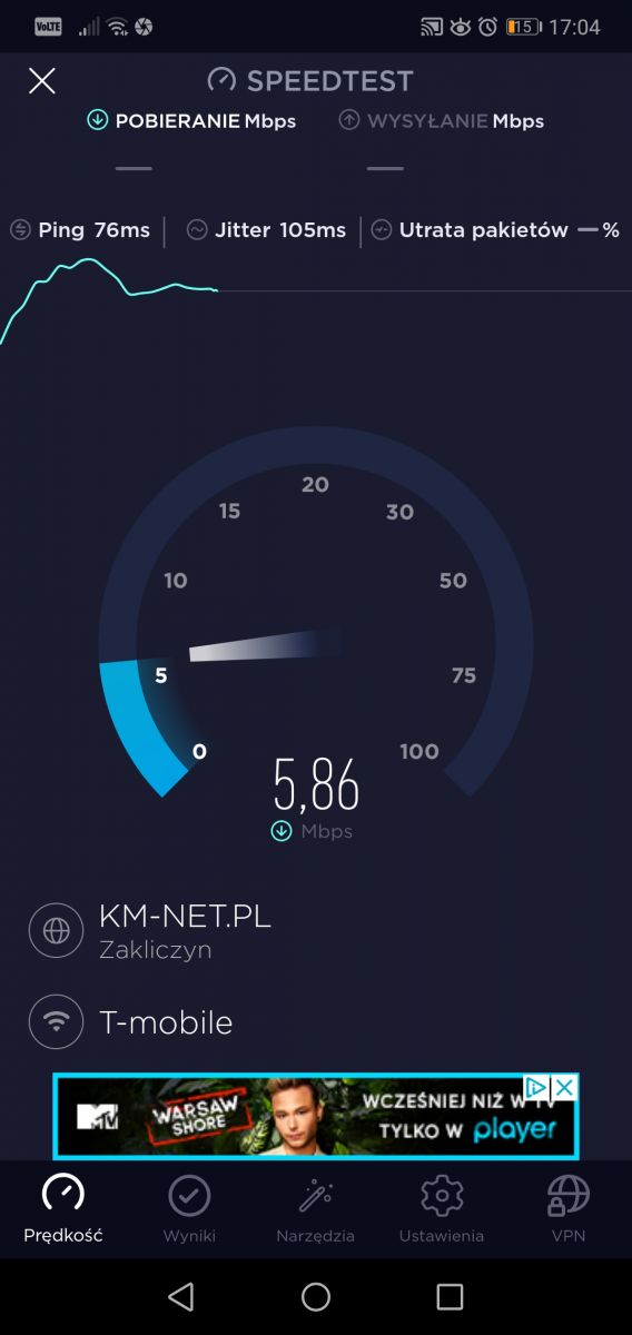

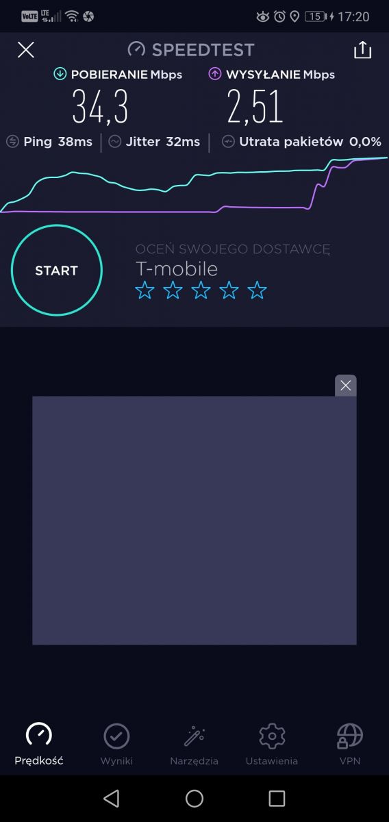

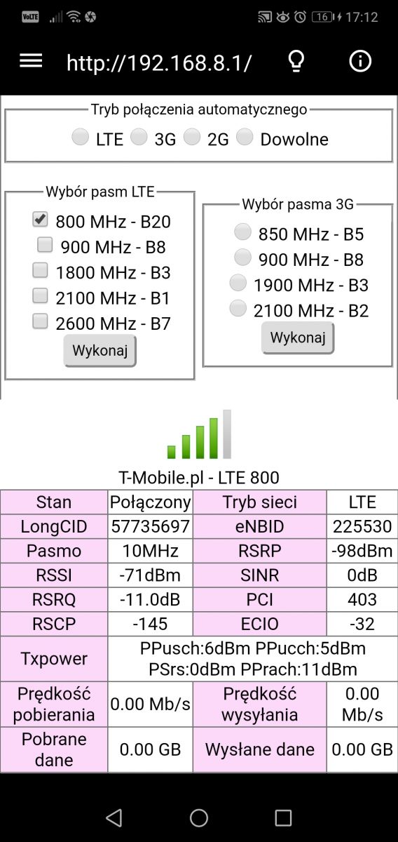

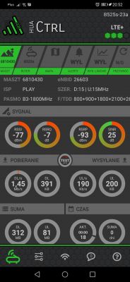

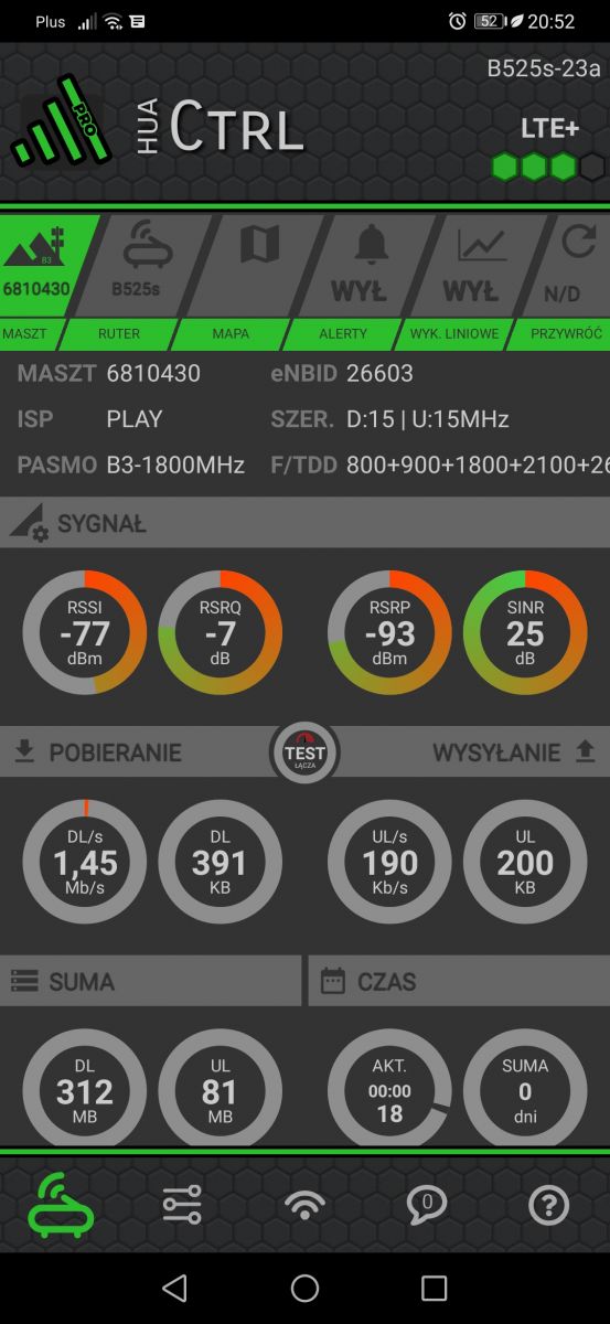

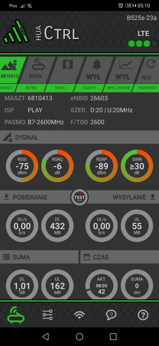

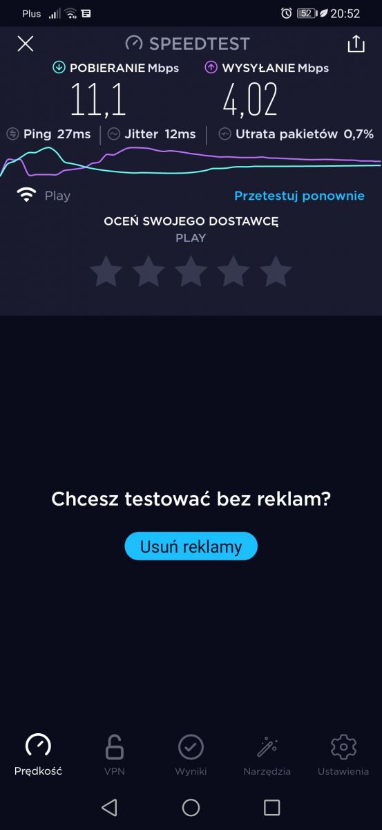

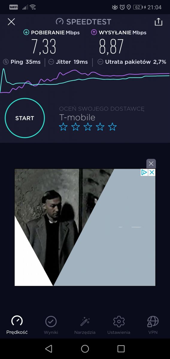

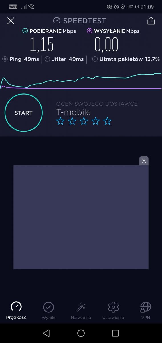

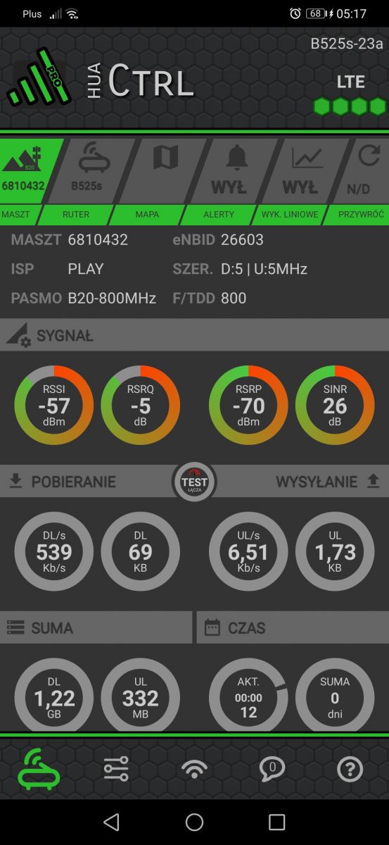

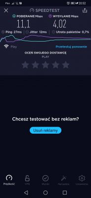

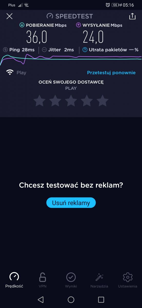

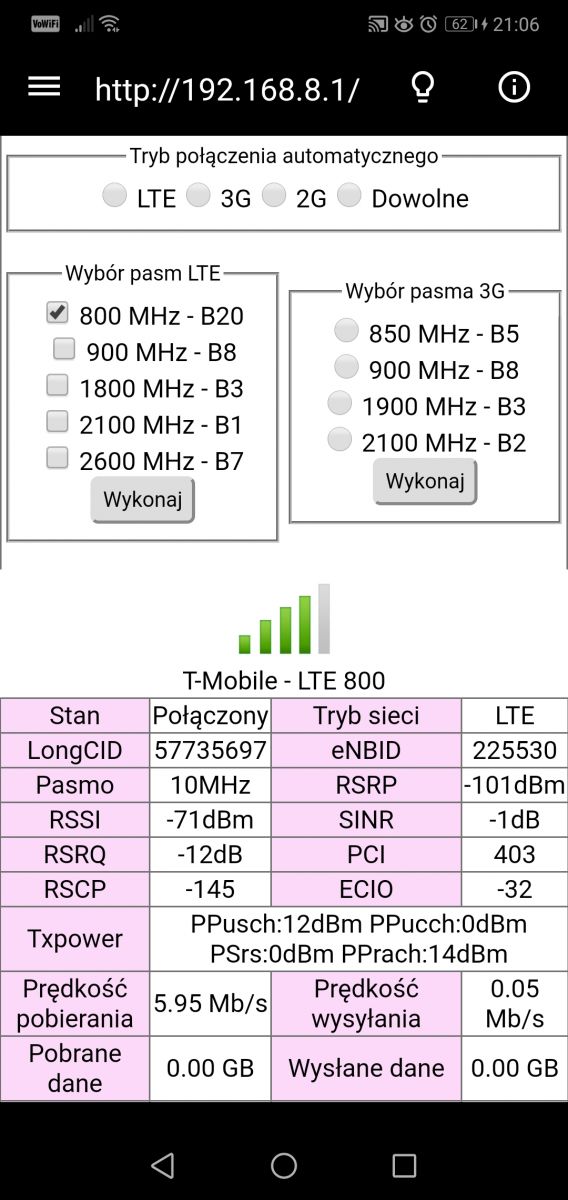

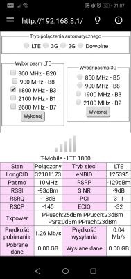

    I did some testing on a Hua b525 with a Play card. Speeds below. The router in the same place as the tests in plus without an antenna.
    For 2100 Choosing the Best ANTENA LTE for Huawei B525 Router - T-Mobile Network, Speeds & MIMO 800-2170MHz Choosing the Best ANTENA LTE for Huawei B525 Router - T-Mobile Network, Speeds & MIMO 800-2170MHz
    For 1800
    For 2600
    For 800

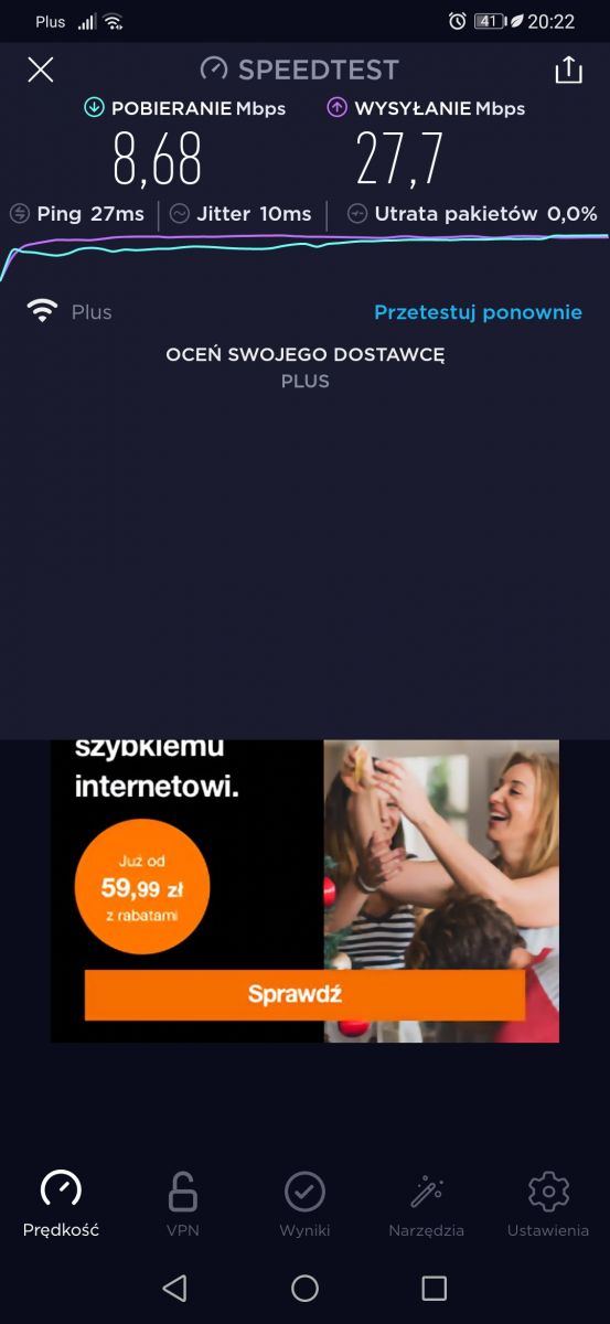

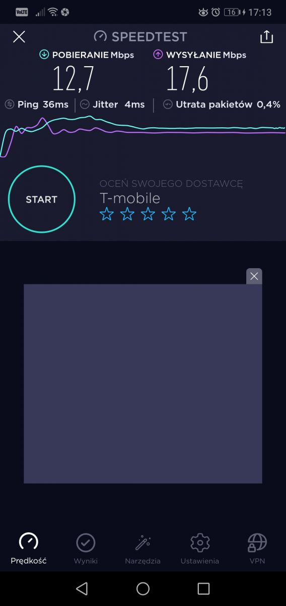

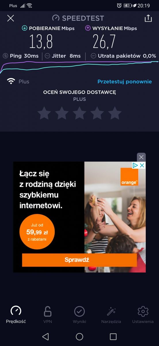

    And a plus card and Play on the Hua P30 phone in the central point of the apartment.
    Only 1800 I managed to do in the evening after 8 p.m., the rest in the morning after 5 p.m.

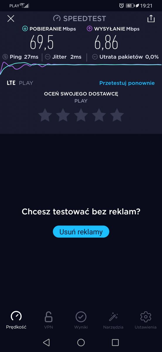

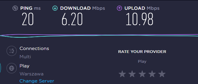

    Added after 6 [minutes]:
    Ka
    Plus and Play card

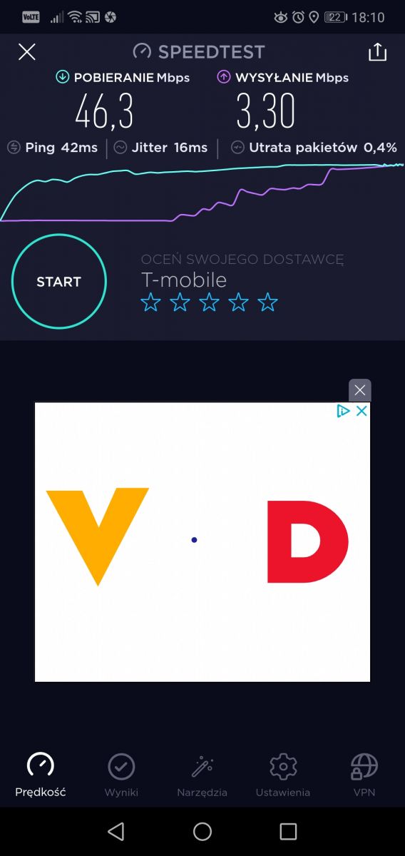

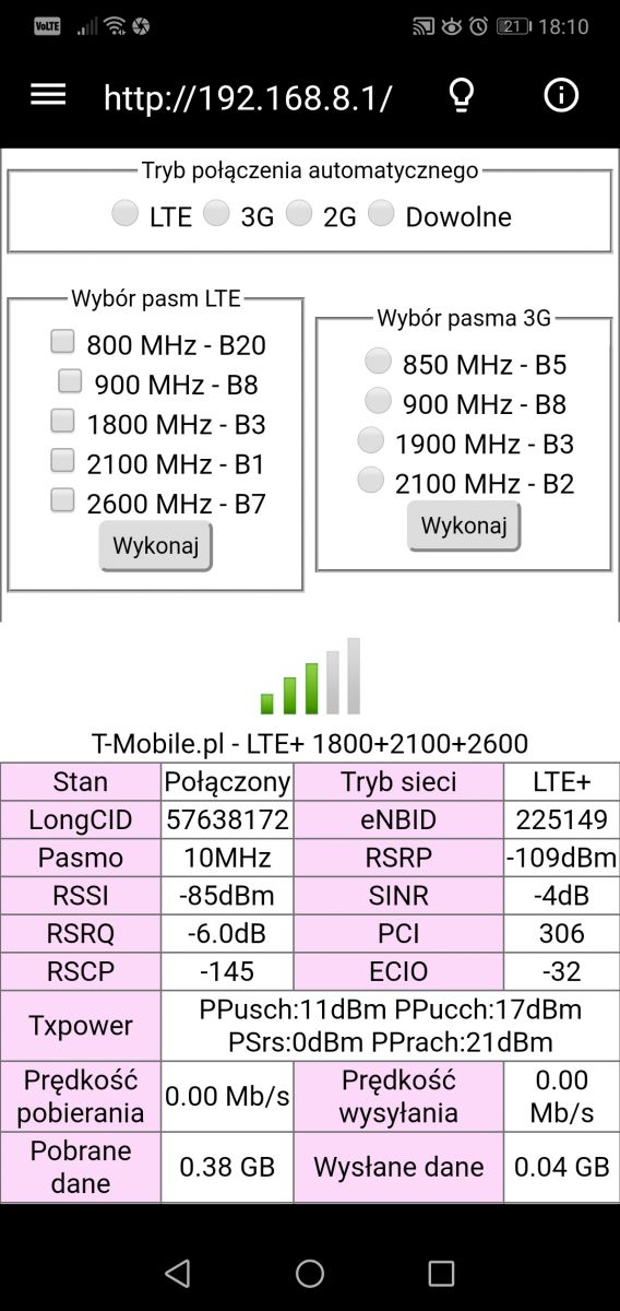

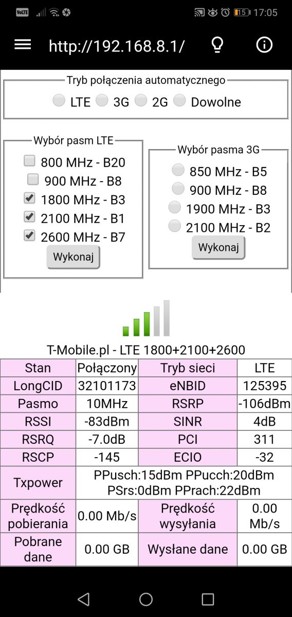

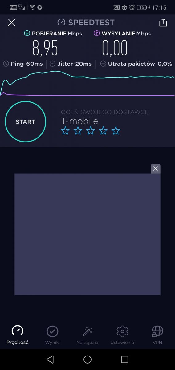

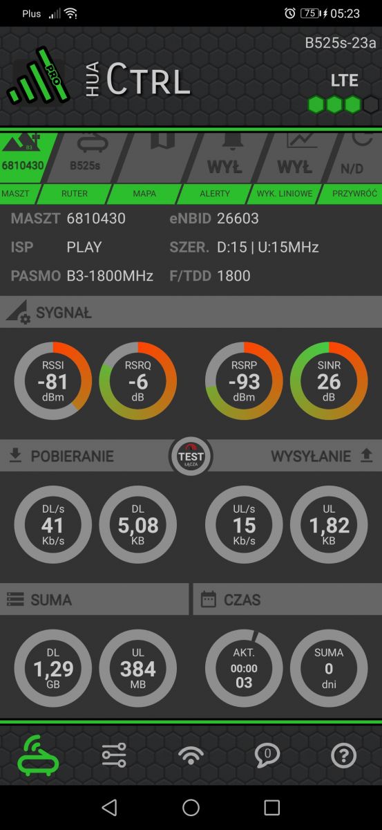

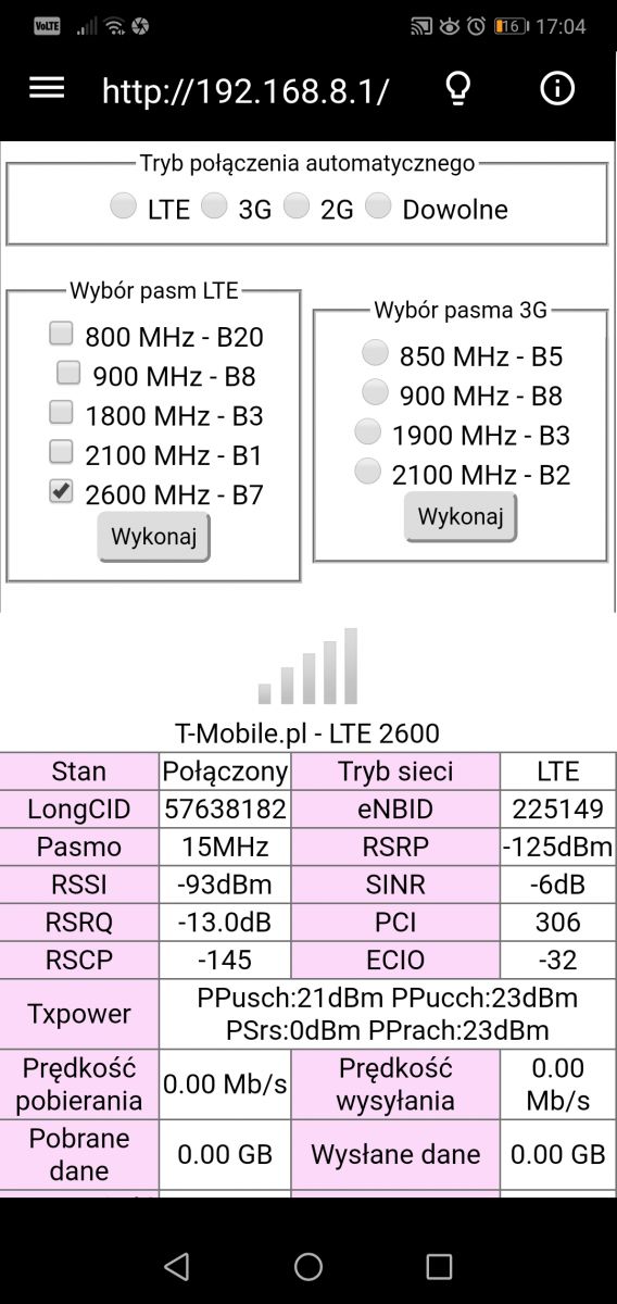

    Hello, I will connect to the topic, especially since the question is analogous.
    Tmobile magenta UP 60mb / s
    B525
    My Location:
    50.027243040342114, 20.670366545461967

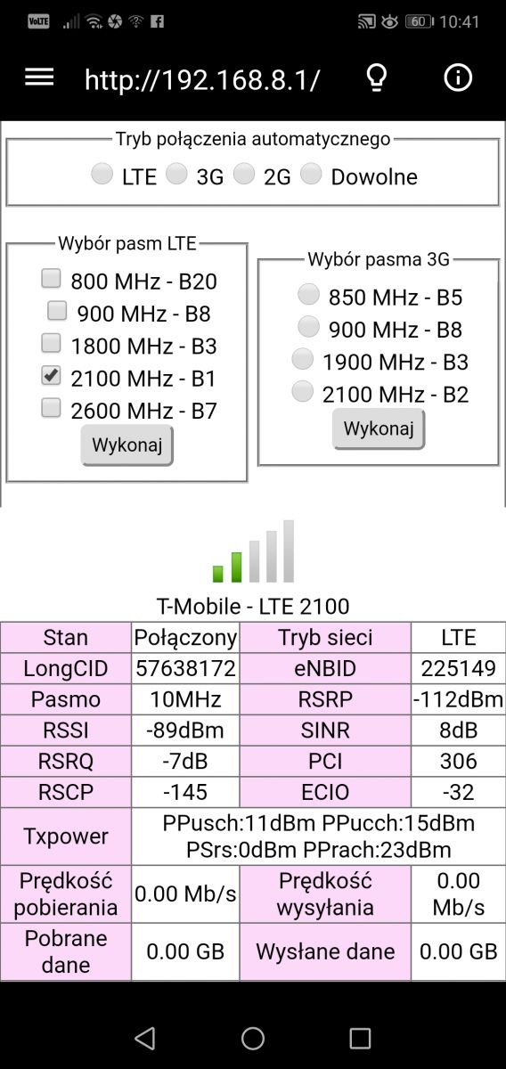

    Home router on the 1st floor. No external antennas. Connected to BTS Bucze (3.6km) which has only 800. Maximum UP22 / DL19 in the evening hours. At the moment:

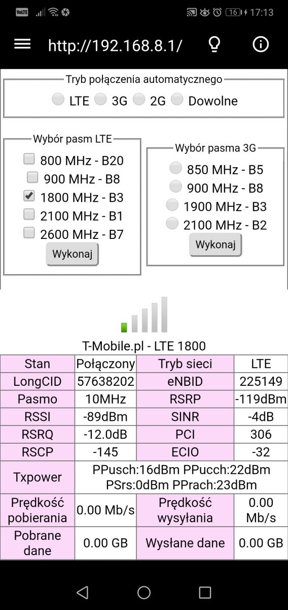

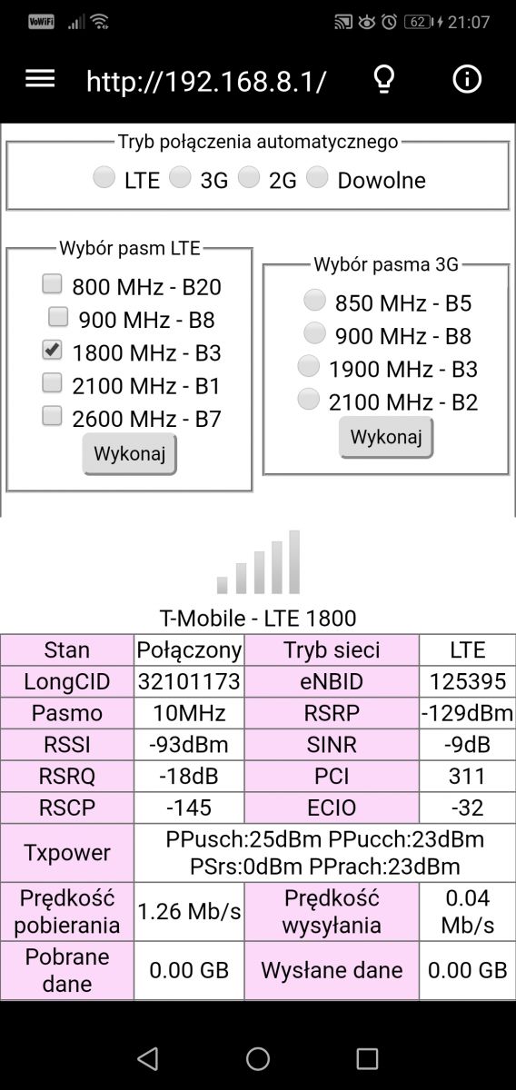

    After being forced, for example, 1800, it barely connects with BTS Maszkienice (6 km and a forest and a hill on the way)
    Here is my question what to do, buy antennas and stay at 800 bts Bucze? if so, what :) I was in the vicinity of 1km from the transmitter with the phone. DL38 around 9am.
    Should you try to connect with the Maszkienice and aggregate?
    Thanks for the advice, best regards.

    And what did you expect from T-Mobile, which does not have the infrastructure in this area to provide the service with no data limit. Only BTS NetWorks Młyńsko-Brzeska meets these requirements. the others are poverty with bare LTE800, on the one in Bielcza, LTE1800 was added to save this shit, but this is a half-measure. And the one from Bucza is clogged, but it still works well, you have B525, try with the aggregation of 2 LTE bands

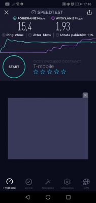

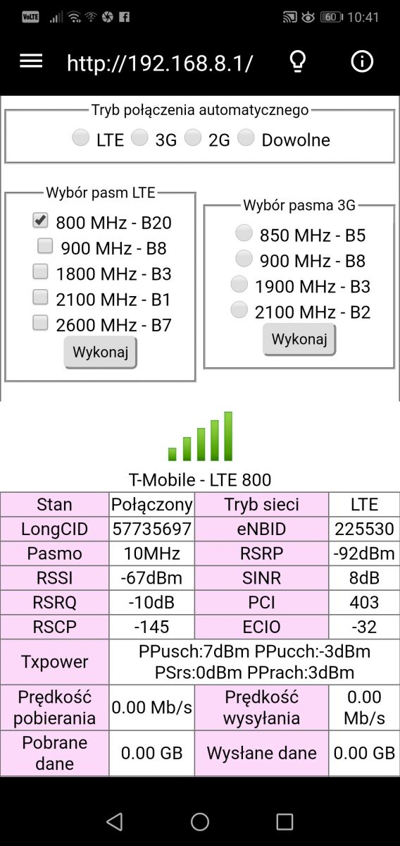

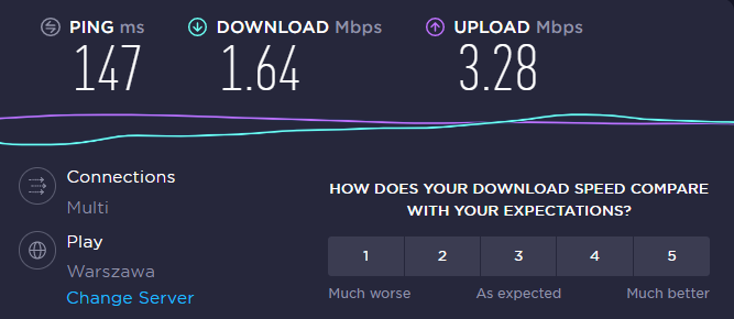

    Router on the balcony, 1st floor to the side of the Maszkienice and Brzesko bts. No connection 2600.
    He caught a better range of 1800 and 2100 from Maszkienice.
    Connected to Bucze at 800
    I do not know anything about networks, but Brzesko rather falls out of peasant reason? It remains to look for B715 and try to aggregate 800 + 1800 + 2100 from Maszkienice? On the ATK-504? The range will probably oscillate around -100db.
    Or stay on 800 with Bucze + ATK-20 antennas? :|
    I am aware that I will not get miracles anyway. At present, on average, DL fluctuates around 10-15 mb \ s depending on the hour. Obtaining about 25/30 mb \ s which would satisfy me is real? Is it a complete reading of tea leaves :?:

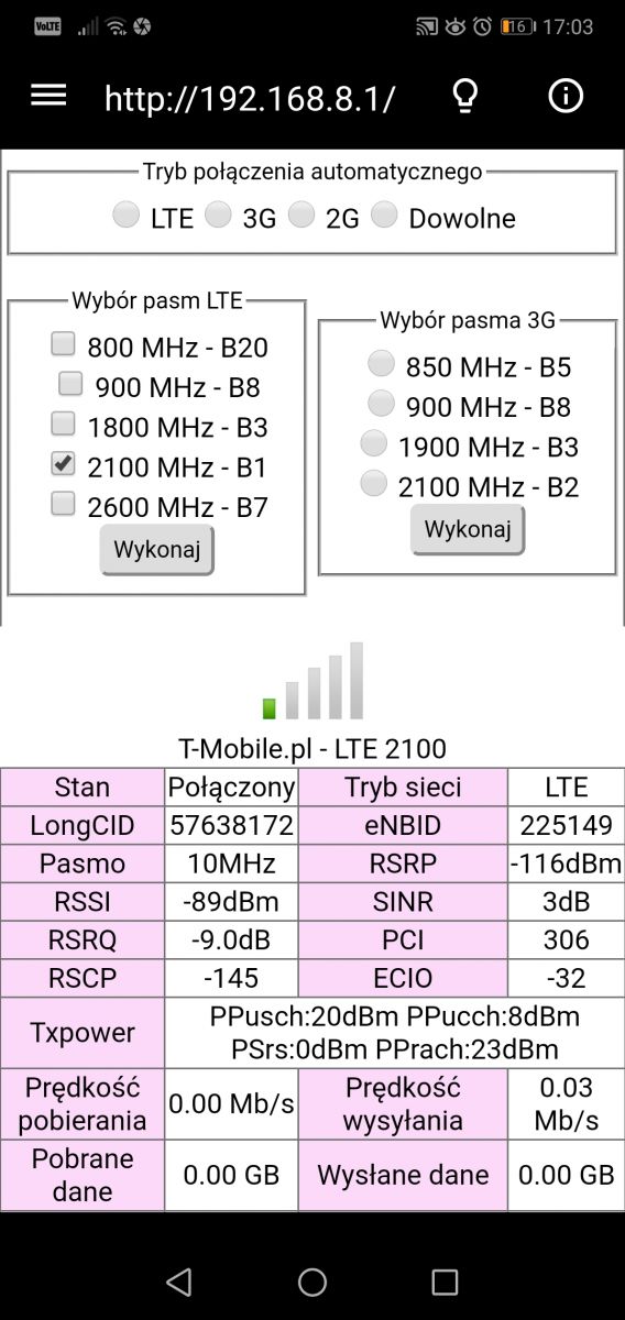

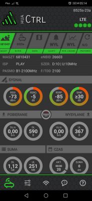

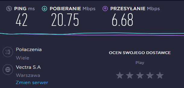

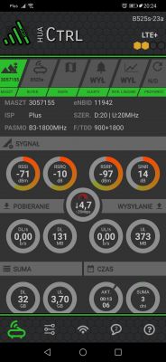

    B818 arrived, tests in the same place as b525, hour heavily besieged, but heavy fog outside, does it affect range? :
    800 Choosing the Best ANTENA LTE for Huawei B525 Router - T-Mobile Network, Speeds & MIMO 800-2170MHz Choosing the Best ANTENA LTE for Huawei B525 Router - T-Mobile Network, Speeds & MIMO 800-2170MHz 1800 Choosing the Best ANTENA LTE for Huawei B525 Router - T-Mobile Network, Speeds & MIMO 800-2170MHz Choosing the Best ANTENA LTE for Huawei B525 Router - T-Mobile Network, Speeds & MIMO 800-2170MHz 2100 Choosing the Best ANTENA LTE for Huawei B525 Router - T-Mobile Network, Speeds & MIMO 800-2170MHz Choosing the Best ANTENA LTE for Huawei B525 Router - T-Mobile Network, Speeds & MIMO 800-2170MHz
    He caught the remains of 2,600 from Maszkienice
    With aggregation on the residual DL range, sensational compared to CP, although this is not an ambitious link ...:
    After a while he switched to Bielcza himself. I have never been able to connect to this bts before.
    If I understand correctly, there are 800 and 1800? The range is much better than 1800 in Maszkienice, so I do not understand why when I force 1800 rigidly, it stubbornly connects to Maszkienice at -119db
    Summing up, you can buy an antenna 1800 + 2100 + 2600 and should it run smoothly? :)

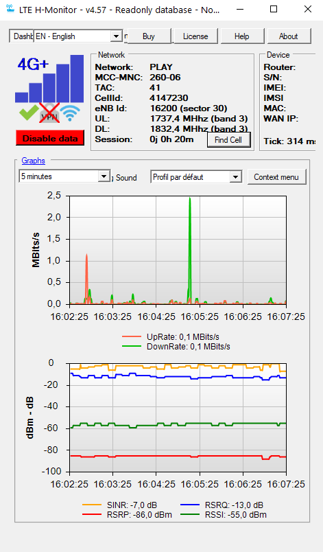

    The antenna is connected, it hangs on the 2nd floor, it aims straight at the bushes :)
    Tests at 18:00
    So a revelation compared to CP ... Thanks for your help :-) The antenna is on the 10m h115 cable for now and it turned out that it was not necessary because I changed the location and 4m is enough. I will order it for a trial and we will see if we can improve UP a little. With such a short cable, it is better to buy something from the top shelf, right? Can you advise something?
    In the spring, I will try to mount the antenna on the chimney because probably when the trees are covered with leaves, I will return to the exit point with range :)
    One more question from a layman. Why is the router strenuously connected to bts Maszkienice to which I have almost 6 km and above that a hill and a piece of forest. Whether I force 1800,2100 alone or remains of 2600? BTS Bielcza is a kilometer closer, a few trees and only farmland. Despite the fact that the antenna is aimed directly at him, it still catches the connection with the Maszkienice.

    The closer BTS may have lower bandwidth and may be much more loaded with traffic.

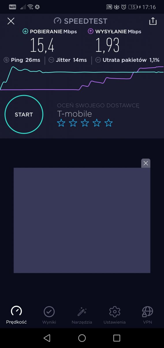

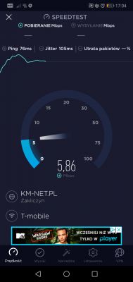

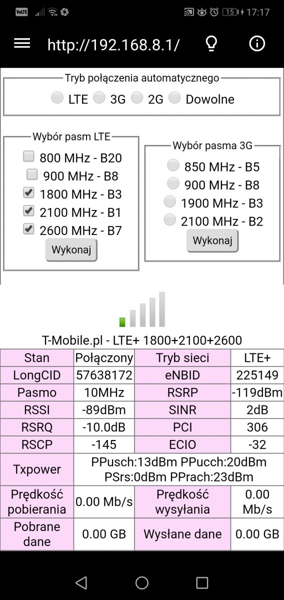

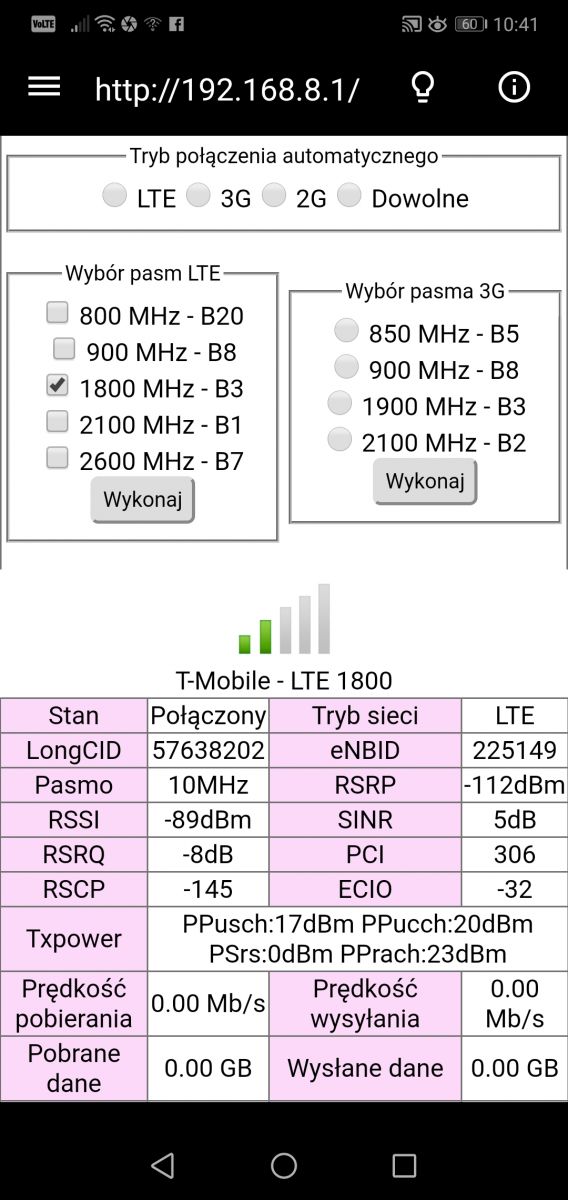

    I stick to the topic so as not to multiply threads.
    Some time ago, I had a hard time transferring data. I am wondering how to improve it. Antenna? If so, which one? I have no experience in this subject. Hence, below are a few questions and some additional information for more experienced colleagues. By the way, I noticed that the 2600 band is currently the least loaded.
    Currently, the router (Huawei B535) is located in the attic of the house - it was a place where the range was incomparably better, e.g. compared to that on the ground floor. Although he has recently sat down. The range in phones has also been weaker recently.
    Nearest BTSs:
    1) ~ 2.2KM | Play (26006) ID: GDA0081 | Gdańsk, ul. J.Słowackiego 200 - the navigation tower of the Gdańsk Airport Lech Walesa
    2) ~ 2.5KM | Play (26006) ID: KAR3601 | Rebiechowo - commune Żukowo, the mast of the PKM GSM-R17921
    I am currently connecting to BTS from point 1. And now like this:
    1) With aggregation of 2100/1800 (B1 / B3)
    2) 1800
    3) 2600
    4) 2100 (caught, interestingly, from the Play mast (26006) ID: KAR0103
    Aggregation 2600/1800 2600/2100 very similar.
    What to go here? Boost it 2600? Aim at other masts? Which antenna to choose?
    Thanks in advance for the hints and for your understanding if I have made any substantive mistakes.

Why does my router prefer a farther cell?
Cells broadcast priority. The closer BTS may have narrower bandwidth and heavier load, so the device sticks to the stronger scheduling of the distant site [Elektroda, jarek7714, post #19131296]
3-step: How do I aim a directional LTE antenna?
  1. Mount loosely and connect router. 2. Use Huawei Manager’s live RSRP/SINR read-out; rotate in 10° steps. 3. Lock the bracket at the highest SINR, then tighten bolts. Total time: ~15 minutes [Elektroda, rob cook & matek451 posts].
