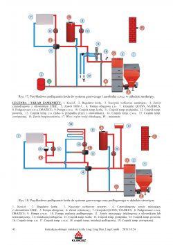

    In general, the schematic diagram of the installation is as in the photo below, option I:
    Connecting Underfloor Heating and Two Radiators: TECE Mixing Pump or RTL Valve?
    But I understand that the proposed by you ls_77 the solution is scheme II?
    What to choose now so that it is as cheap as possible but above all reliably?

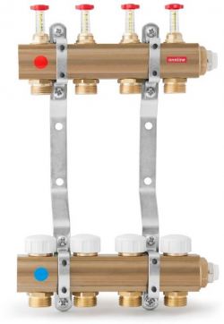

    Here you have an example distributor for OP:

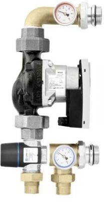

    Here you have an example of a mixing-pump group with a 3-way thermostatic valve:
    Here you have an example of a mixing-pump group with a 4-way thermostatic valve:
