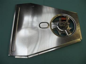

    At the back of the oven is a cooling fan for the top of the oven and the space under the clock electronics. It is a radial fan and you can't hear it when it works. Most likely it got stuck or jammed. Not to be confused with the rotisserie drive motor.
    This is how it should look
    • Amica EBI 8562 AA Oven Overheating: Top Panel, Touch Display, Child Protection Failures TJ7-LY-CMMV-E9K.jpg (10.97 KB) You must be logged in to download this attachment.
  • #7 16953965
    Tr1SH
    Posts: 20
    Rate: 16
    You can hear the fan running and air is exhausted from this gap between the lid handle and the lcd screen. However, when the oven is turned off, nothing is blown out or heard. Then all the temperature goes to the center of the top panel and is boiling (warmer than when the oven is operating).

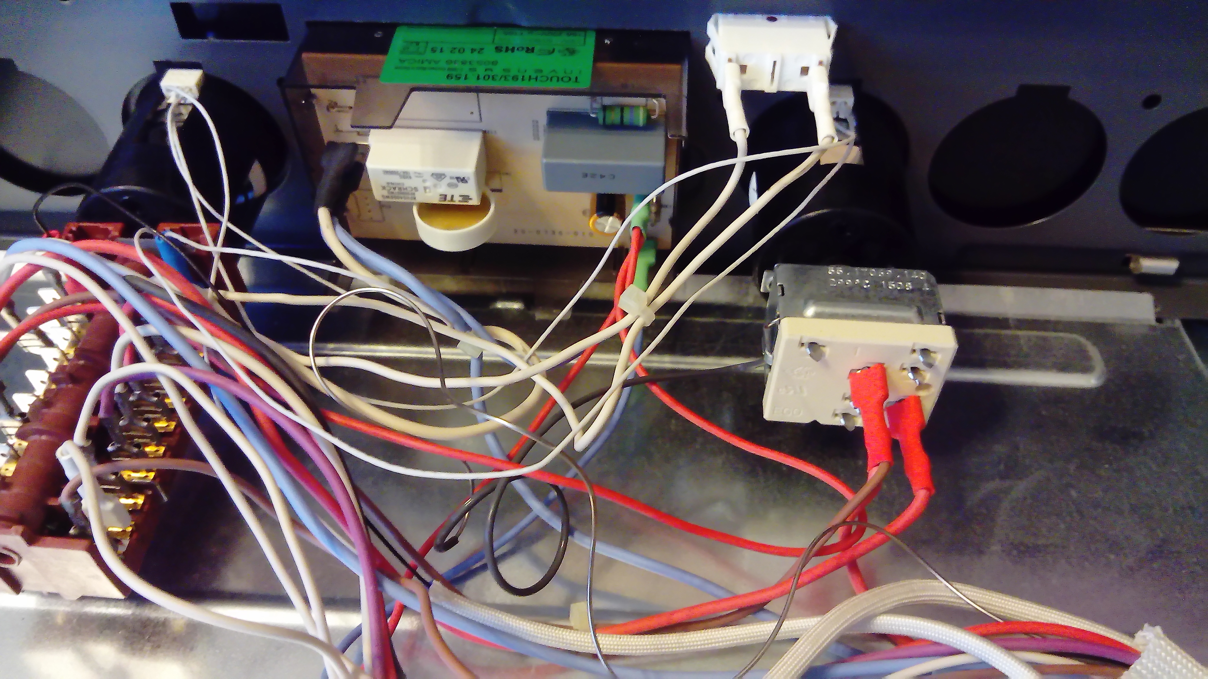

    So yes, the oven is dismantled first. It heats up normally, i.e. I don't have a thermometer to check it, but it heats up and cuts off normally. The fan works when the oven is turned on. Doesn't work when turned off. It's clean, the chamber is clean. As I mentioned in the post above, I do not know if it should not be that after turning off the oven, the fan should still work. What is responsible for his work?
    Amica EBI 8562 AA Oven Overheating: Top Panel, Touch Display, Child Protection Failures Amica EBI 8562 AA Oven Overheating: Top Panel, Touch Display, Child Protection Failures Amica EBI 8562 AA Oven Overheating: Top Panel, Touch Display, Child Protection Failures Amica EBI 8562 AA Oven Overheating: Top Panel, Touch Display, Child Protection Failures Amica EBI 8562 AA Oven Overheating: Top Panel, Touch Display, Child Protection Failures Amica EBI 8562 AA Oven Overheating: Top Panel, Touch Display, Child Protection Failures Amica EBI 8562 AA Oven Overheating: Top Panel, Touch Display, Child Protection Failures Amica EBI 8562 AA Oven Overheating: Top Panel, Touch Display, Child Protection Failures Amica EBI 8562 AA Oven Overheating: Top Panel, Touch Display, Child Protection Failures Amica EBI 8562 AA Oven Overheating: Top Panel, Touch Display, Child Protection Failures Amica EBI 8562 AA Oven Overheating: Top Panel, Touch Display, Child Protection Failures Amica EBI 8562 AA Oven Overheating: Top Panel, Touch Display, Child Protection Failures Amica EBI 8562 AA Oven Overheating: Top Panel, Touch Display, Child Protection Failures Amica EBI 8562 AA Oven Overheating: Top Panel, Touch Display, Child Protection Failures Amica EBI 8562 AA Oven Overheating: Top Panel, Touch Display, Child Protection Failures Amica EBI 8562 AA Oven Overheating: Top Panel, Touch Display, Child Protection Failures Amica EBI 8562 AA Oven Overheating: Top Panel, Touch Display, Child Protection Failures Amica EBI 8562 AA Oven Overheating: Top Panel, Touch Display, Child Protection Failures Amica EBI 8562 AA Oven Overheating: Top Panel, Touch Display, Child Protection Failures Amica EBI 8562 AA Oven Overheating: Top Panel, Touch Display, Child Protection Failures Amica EBI 8562 AA Oven Overheating: Top Panel, Touch Display, Child Protection Failures Amica EBI 8562 AA Oven Overheating: Top Panel, Touch Display, Child Protection Failures Amica EBI 8562 AA Oven Overheating: Top Panel, Touch Display, Child Protection Failures Amica EBI 8562 AA Oven Overheating: Top Panel, Touch Display, Child Protection Failures Amica EBI 8562 AA Oven Overheating: Top Panel, Touch Display, Child Protection Failures Amica EBI 8562 AA Oven Overheating: Top Panel, Touch Display, Child Protection Failures Amica EBI 8562 AA Oven Overheating: Top Panel, Touch Display, Child Protection Failures
    #16 16977636
    zibi1971
    Home appliances specialist
    Posts: 972
    Help: 262
    Rate: 1120
    I have the same oven as yours. The cooling fan turns on when the oven is turned on and turns off when the oven is turned off. A difference of 20C is acceptable. It's possible that your cooling fan is underperforming. Check that the seal is not damaged and that the door fits properly.

    The oven heats up the same when removed. When the fan is running, it's ok. When it stops, all the heat spreads to the top. The air is warm and without a fan, it hardly gets outside. There is a hole in the oven cavity that leads to the fan compartment. The specialists from Amica who connected the equipment to me said that there was cooling, and the oven had never heated up before.
    Of course, due to the fact that it is a built-in device, it is not ventilated on all sides. Behind the wall it has a good few cm, as I said before, nothing happened to it and it was cool. The gap between the glass and the panel is empty, there is nothing clean in it. I purged. The fan was also cleaned. The hole in the oven is also clean.
    Your idea of overheating is ok, but it's also not an ideal solution - I set the baking to 200 degrees - then I set the regulator to 0 ° C and to 50 ° C, the panel was cooling down, but still very slowly, probably for several dozen minutes. As a test, I set 50 ° C to check the operation of the thermostat. After about 20 minutes, the diode from the thermostat surprised only at 120 ° C, which would mean that the oven is still hot (it is about 100 ° C) despite the passage of time ... So the panel was hot, but not boiling. No less and still hotter than when baking with a fan.
    Fan chamber checked lengthwise and across, run over with a rag, air, wiped and fan sprayed with WD40. He walks as he did. It runs evenly and spins. I don't know if it's too fast/too slow. I can't see any irregularities so moderately.
    In the earlier photos you can also see that on this function connector the plates are purple from the back - they probably sintered during this overheating of the oven, so they will probably sit down in a while...
    Possibly, I was thinking of buying a thermostat and a thermostat for PLN 100, but I do not know if this is it ... I will handle the connection calmly.

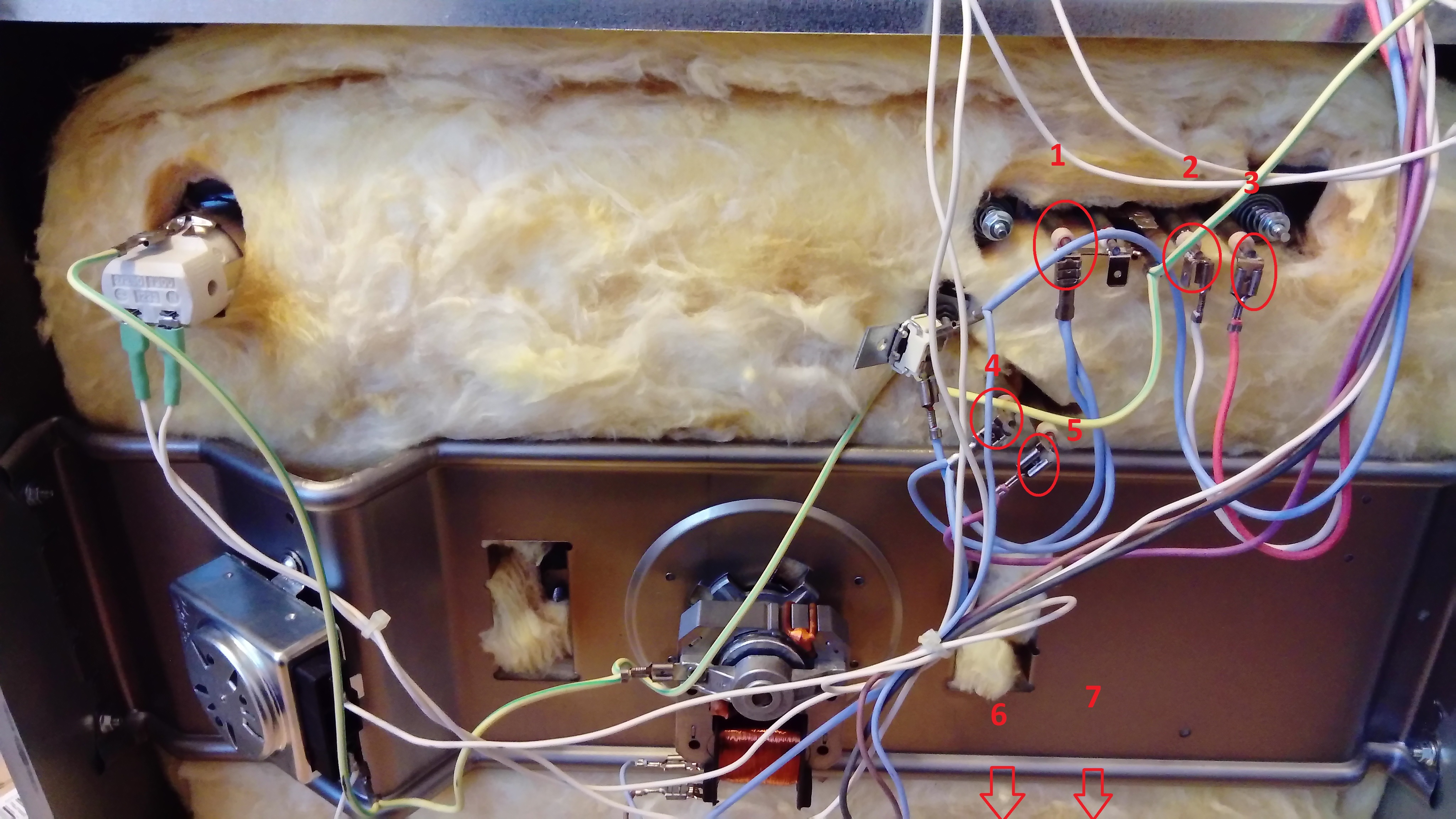

    In the afternoon, in the photo you sent, I will mark where to put the bulb clamps to check whether the heater is on the heel or not depending on the set heating mode.

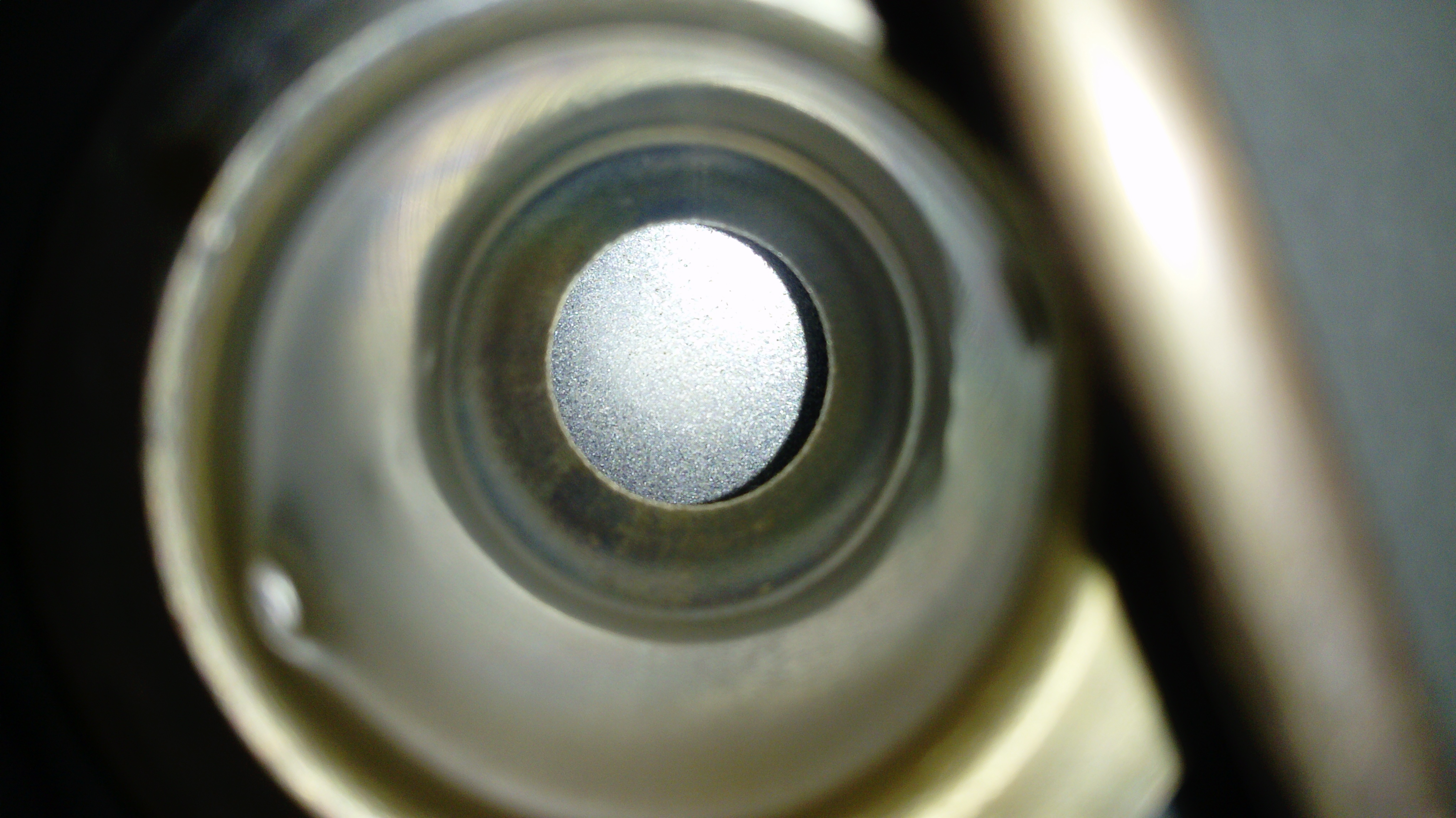

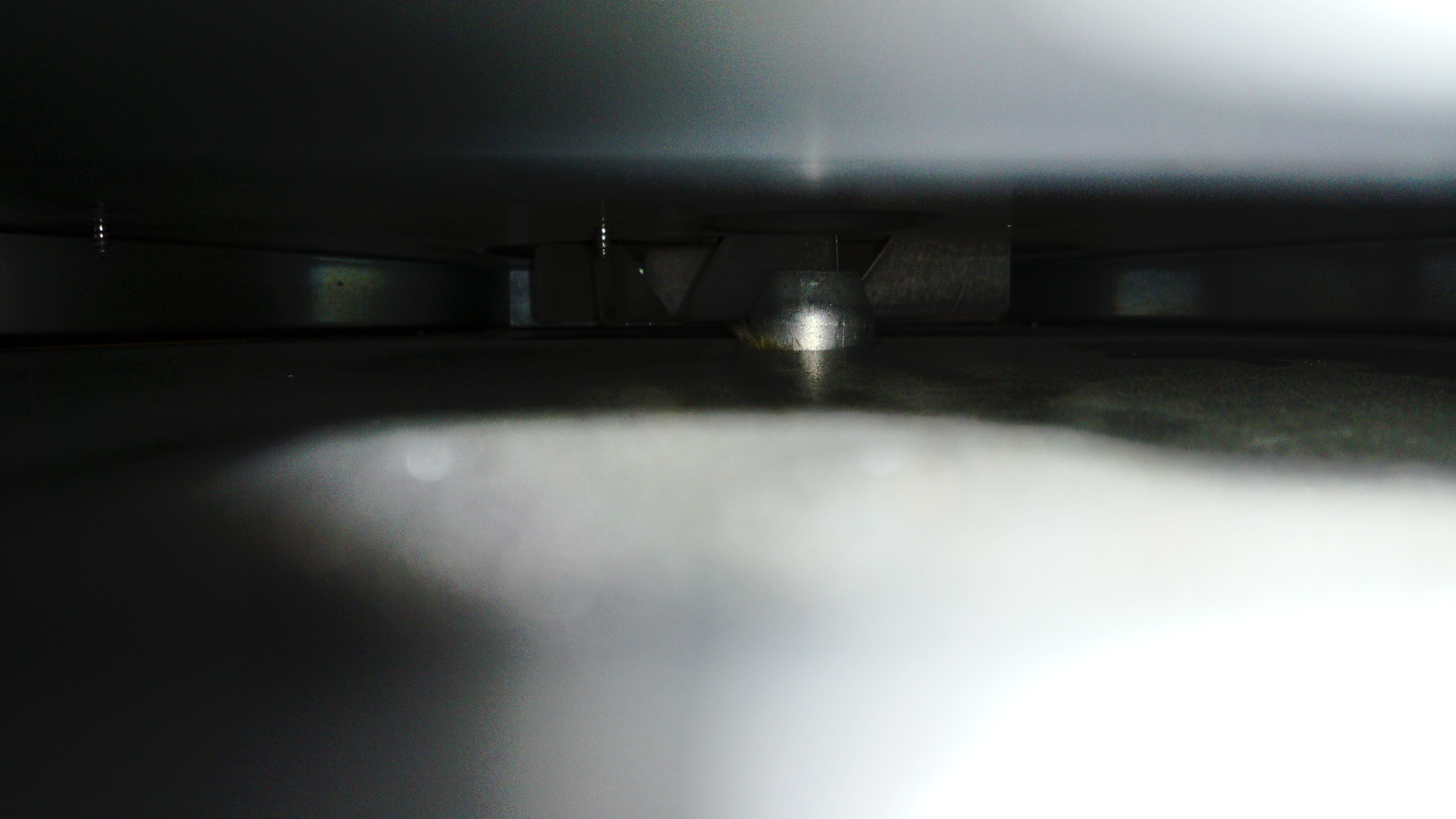

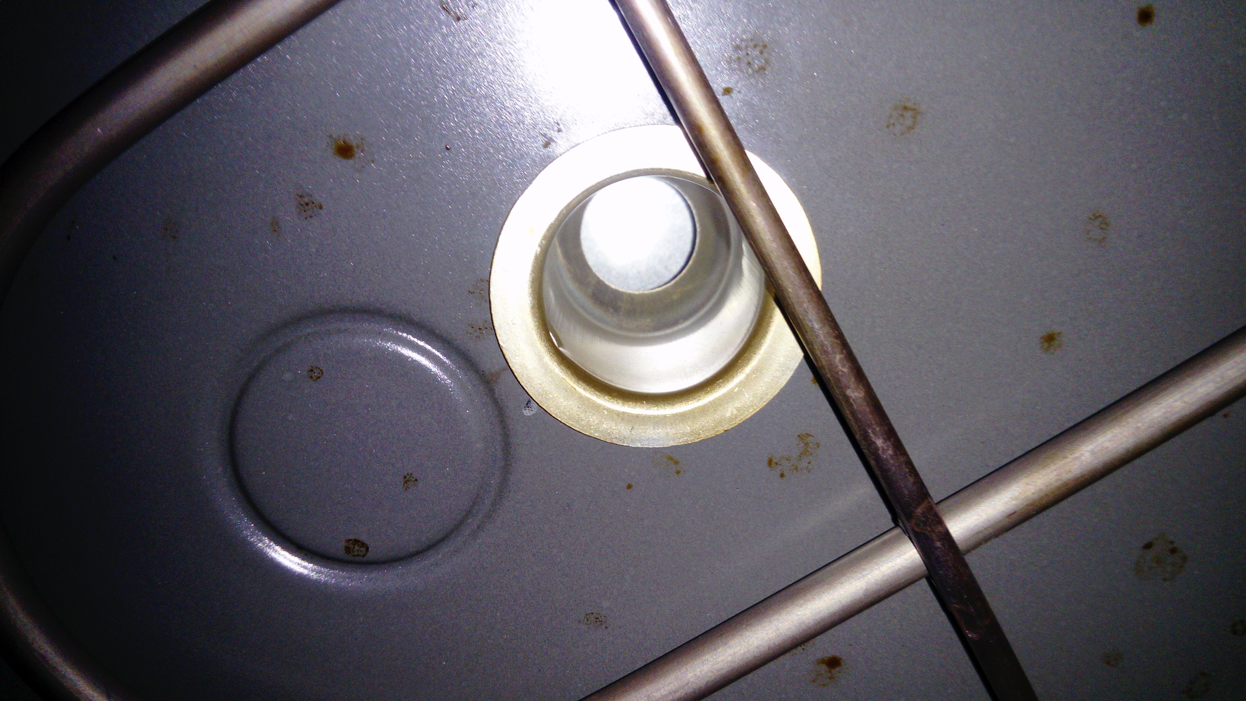

    And one more thing - take a picture of what you called the hole (hole) through which the heat goes, and do something like this ... Only turn on the backlight of the oven, and the thermostat to 100 ° C and if by any chance one of the heaters does not heat up (because this would mean that the heating type selector is defective).
  • #25 16980643
    Tr1SH
    Posts: 20
    Rate: 16

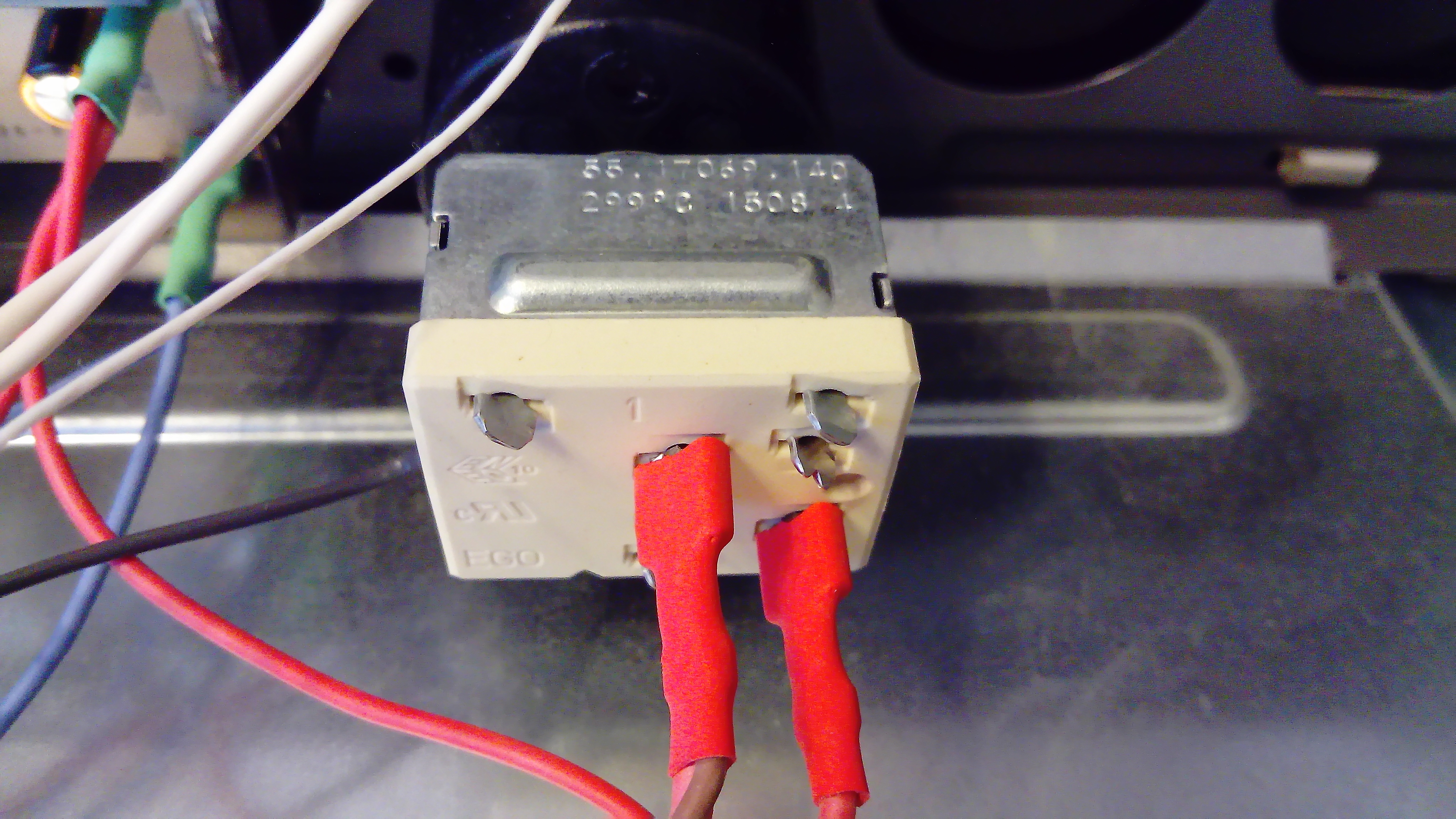

    With the light on and the thermostat at 100 degrees, the oven is cold, the fan is moving.

    Well, that's ok. Depending on the set heating option, the voltage on the heaters will be between the terminals:
    1-2 top heater 1
    1-3 top heater 2
    3-4 thermo circuit heater
    5-6 (the picture does not show, but there must be a heater at the bottom) bottom heater.
    Applying a 230V bulb (specifically wires connected to it) or a voltmeter. Lighting up indicates that this heater is heating. If there is voltage on a given heater, and the setting of the heating option is different, it will mean that the switch of the heaters is damaged.
    Do one more check - put a piece of paper between the oven and the oven door and to remove it, it comes out with resistance or slips out loosely.
