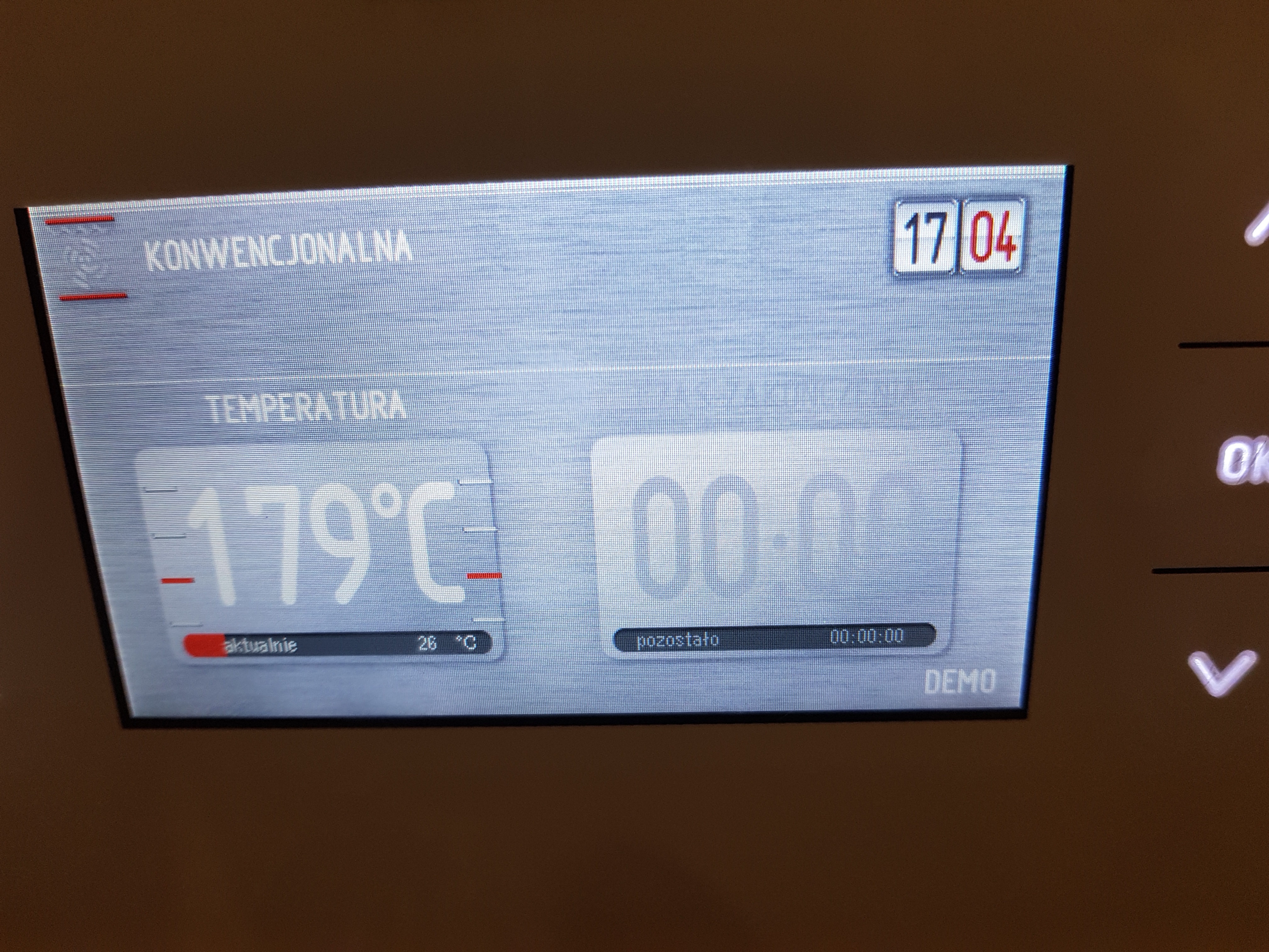

    In the Amica EBI81074 oven (sensor control), I do not know how the DEMO mode turned on (the heaters do not work). Does anyone know how to turn it off?

    In the lower right corner, the word DEMO is displayed. All settings work normally (nothing changes automatically), after setting a program, everything works normally except for turning on the heaters. I heard that DEMO is for the presentation of equipment in stores.

    Unfortunately, the test mode did not disable the DEMO. The inscription DEMO in the lower right corner.
