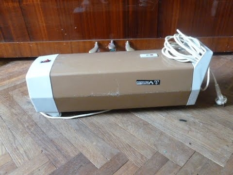

    Zygaqra wrote:
    There used to be cheap spray paint spray guns.
    Forgot colleague to add one important thing. For this you need an old vacuum cleaner that has both an inlet and an air outlet.
    For example Choosing Between a Lamb Roller or Gun for Painting Plastered Outbuilding
    When using the gun, the vacuum tube was connected to the outlet.
