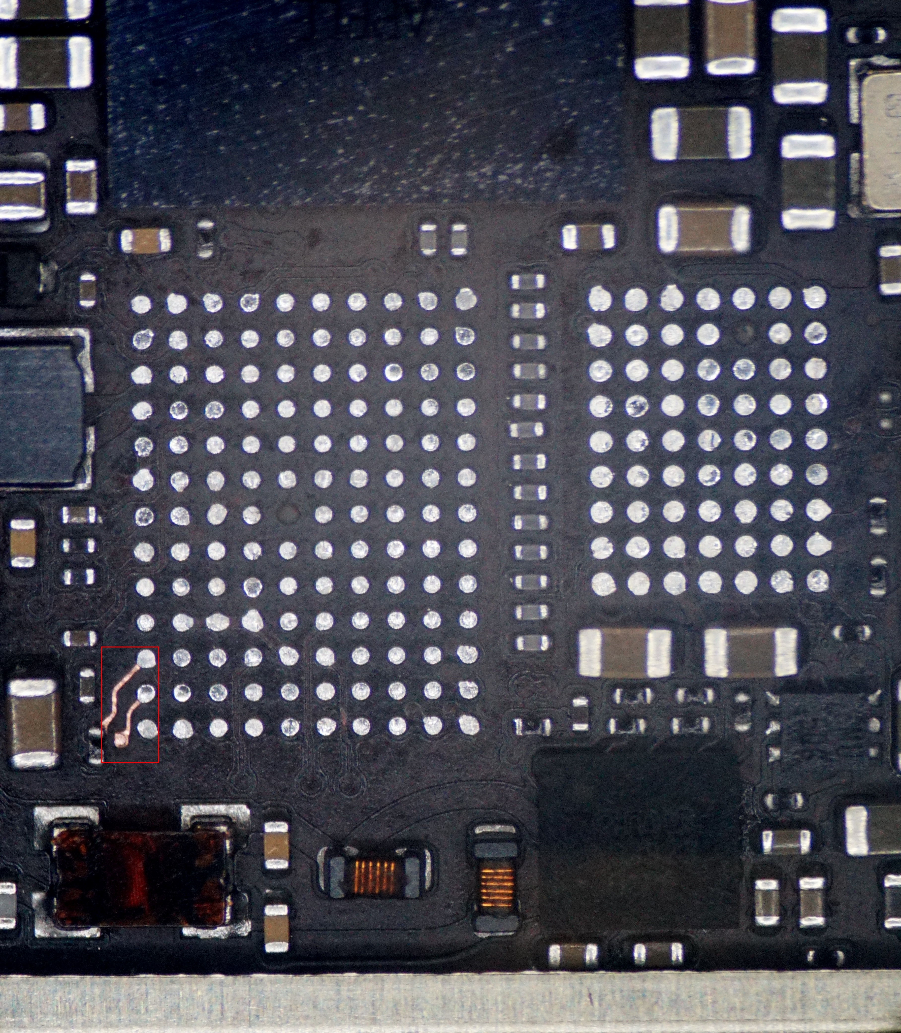

    Hello, I have a problem, namely the touch problem. I exchanged a long time ago for a broken iPhone 6 Plus everything worked without a problem, I went to the service and they said PLN 300 for the repair, so I decided to replace it myself. I bought the whole display and did the same as on the internet guide and made the phone call. I start it, I see that everything works except touch (at the beginning it touched me, sometimes it caught me, I took off the screen once again, unfastened and fastened the tapes again and turned and then noticed that there is no touch at all: /)
    And I wonder if I did something wrong and could it also depend on the fact that I wasn't wearing gloves?
    I would ask for help ...

    Lack of touch 6Plus is a very common glitch, soldering touch controller circuits is most often guilty and there are pads and paths.
    Sometimes when the panel is replaced, the touch tape slot is also damaged.
    System repair consists of restoring connections and reball or replacing the system:
    iPhone 6 Plus Touchscreen Issue: DIY Screen Replacement Failed, Seeking Help & Tips
    iFixThis
    Łowmiańskiego 18, Poznań, 60-685 | Tel.: 516XXXXXX (Show) | Company Website: https://www.instagram.com/ifixthis.pl/

    Perhaps the touch itself (probably a Chinese replacement) is flawed. Put the old one back (was there a functional touch?) And check if it works.

    Now I checked and the old one works :) And in general, when I attach tapes from the display, the original ones lightly click and those from the new ones sit in place, but I can't hear them coming in; P
    And my old display I can see that it was also disassembled by some technician because there were no screws tightened, they just flew in the housing :D

    Broken touch modem
