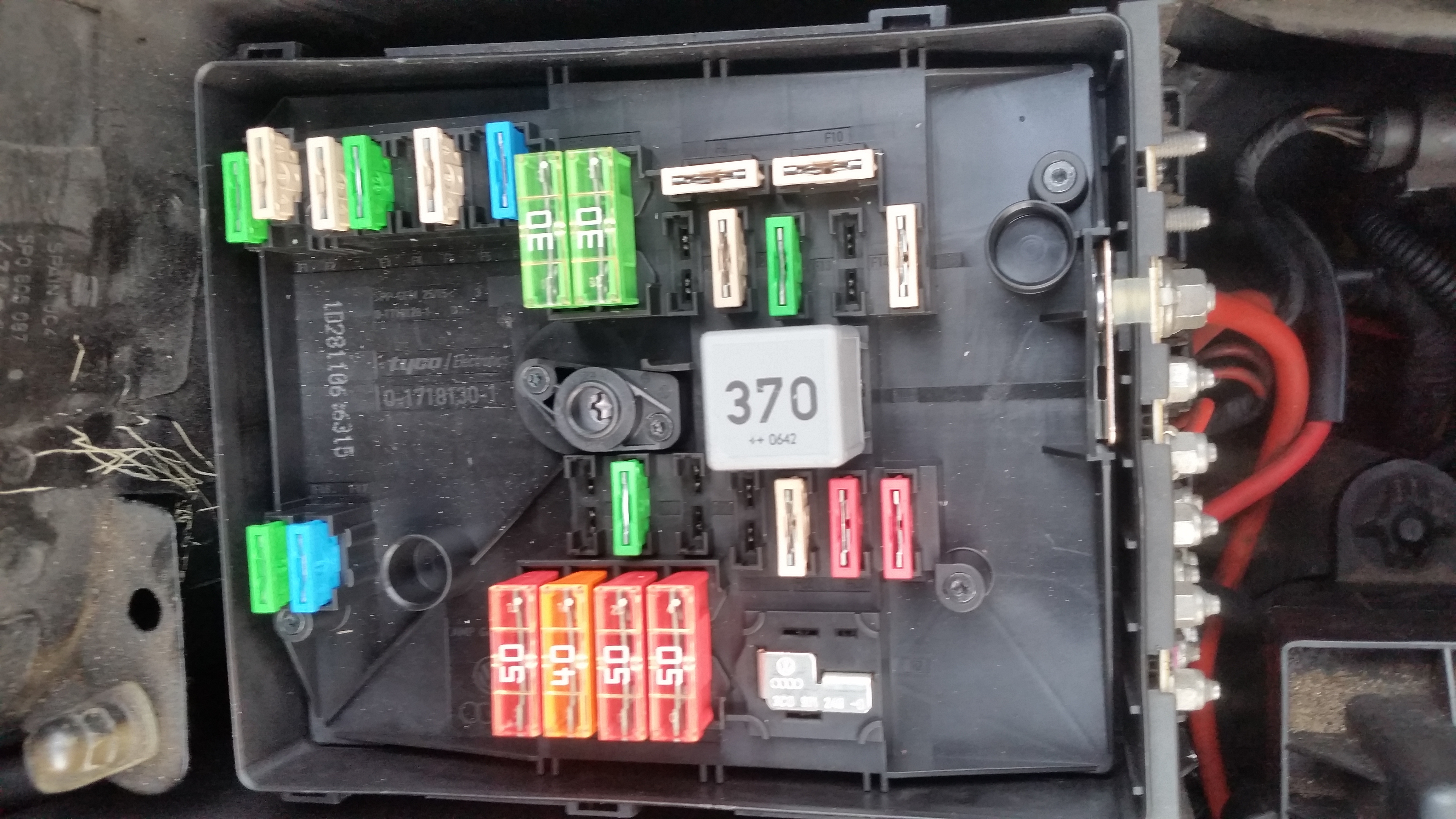

    ps. What is your mailbox? Did you find out which fuse is from the throttle? I also have a radiator fan attached to it.

    I have a Seat Altea from 2007, so I don't remember it anymore, in the older versions No.

    This is my fuse box under the hood.

    From the throttle and fan there is one of these two red 10A next to relay 370.

    Well, the first one on the right.
    Well, you still have to check what I have to. Check whether there is ground and voltage in the plug at the throttle. There are probably 4 pins there. So I guess two power, one steering and one reading position (I think)
